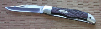

Here is one of my Case CV 6265 SAB Folding Hunter knives from the 1965 - 1969 era. Note that there is some discoloration of the blades. A little gun oil and 0000 steel wool would tone it down a bit but I like it as is. Gun oil works well for lubricating the joints; however, food grade mineral oil works well too. There is nothing wrong with stiff opening and closing blades. Actually, that is desireable on a folding hunter knife when used as it is meant to be used. I know you most likely know but for those that don't, CV = Chrome Vanadium and SAB = Saber Ground. Anyway, I hope you enjoy your new (to you) knife. Post a picture of it when you can.

Thanks for the help so far! I'm hoping I can add the image correctly. Like I said, I don't want a safe queen. I just want to clean it up some, lubricate it and keep it. I've sharpened the blades, so that part is done. I've read somewhere that you can use popsicle sticks to get into the channels. I'm not sure what the blades are made of. There's no SS stamp on the blades, so I'm assuming carbon steel. No idea on the liners.
That's CV ('chrome vanadium'), non-stainless steel. The discoloration does just look like the 'good' patina, i.e., black oxide which forms over time. No need to remove that - it's not harming the steel in any way, and it adds perfect character to an old hard-working knife like this. Liners should be brass on that knife.

Here's one of mine, a 1965 - '69 era model in CV, still with the older 'XX' era (1940 - '64) frame. Probably in the transition between the two eras right around 1965. These are aesthetically one of my favorite traditional patterns.

The covers/handles/scales on your knife are jigged Pakkawood (layered/laminated wood). That's a nice knife. If it were mine, I'd be content with rubbing it down with a lightly oiled cloth and call it good. Insert the tip of an oiled Q-tip in the well to clean it/preserve it.
