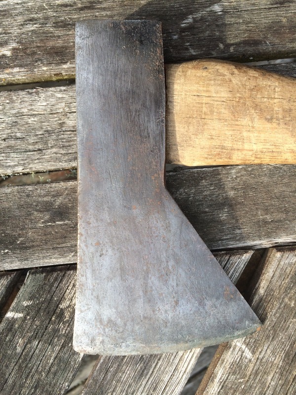

I'm relatively new at refurbishing axes and hatchets and don't know much about the history of them.
I was given a 15.8 oz Norlund stamped Hudson Bay head. It about 5 inches long at the top. Plenty of rust but I don't think there's any pitting.
I'd appreciate any history lessons AND thoughts on the style of handle to purchase for it.
Thanks!
norlunds are late 60s to mid 80s and are generally near top shelf quality, that being a tad on the soft side according to users, thanks to wranglerstar, the value of the HB pattern has skyrocketed, who ever gave it to you has not only lost their marbles, but had a few roll under the fridge as well.
i'd go with the short council tool HB handle but any normal hatchet handle will work fine, just extende the kerf by a lot
From pictures I've seen, current link brand scout hatchet handles look pretty similar to what originally came on these norlund voyager hatchets.
Just look for proper grain orientation ( in line with the direction of the bit ) but for a small hatchet it's not a huge deal if the grain isn't perfect.
BTW to remove any rust, it's best to use a wire wheel in a drill, bench grinder, or angle grinder, and not just soak it in vinegar.

Since I'm new at this, what works best to polish this rusty thing up? In the past, I've soaked a head in vinegar for several days until the rust is gone, then I take an angle grinder with a 160 grit wheel and polish it up. I've tried to find wheels with finer grits but have had no luck, which stinks because the grinder is awesome. And whenever I have used a circular sander with higher grits, it just clouds up whatever I have already done PLUS I start to see little circles in the steel. I like the angle grinder option because it's quick and dirty, but it's also pretty aggressive. I've used a green scotch pad on the grinder after the 160, and that works OK. I'm not sure that I have the patience to spend hours on each grit to get this thing to a mirror finish... Any ideas or do I just suck it up and spend hours with a circular sander?

How about you just don't polish it up, use a wire wheel to remove the rust and leave the patina, the patina is the history and character of the tool and it took a long time to get there.

So it's been soaking in vinegar for about 15 hours, which shouldn't make much of a dent in it. Perhaps I will take it out when I get home today and just wire wheel it. If I don't like the patina look, I can always soak it again. Thanks for the advice.
well, soaking for a long time will absolutely remove it, soaking for a few hours will leave a dark, "polished" finish, just dont push too hard when you brush it
