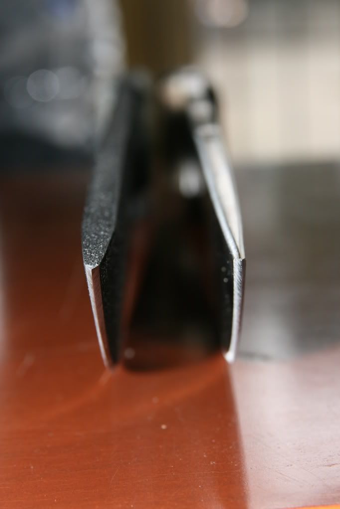

The FFBM had similar problems but in different ways. Having the fusion handles maintains all the problems above, but the thickness at the edge is really what does it in. I is way... WAY overbuilt:
It is one of the only instances in all of the busse models I've owned and used where I could describe the tip grind as 'similar to a cold chisel. And not hyperbole 'omg busses are so thick it's rediculous' talk - They physical measurable geometry was similar to this:
Because of that the knife felt like it stopped dead at the surface of the wood. It felt like using a 3 pound hammer. With a thin knife that sinks in there's a period of time between when the edge hits the wood and when it stops that allows the inertia to be transferred gradually into the wood, creating a good feeling of penetration and limited vibration being sent back up the handle. With the factory edge on the FFBM it felt like most of the inertial force failed to go into the wood and goes right back into your hand. Spine thickness is meaningless if you have a an edge profile that prevents it's weight from transferring it's inertia effectively.
