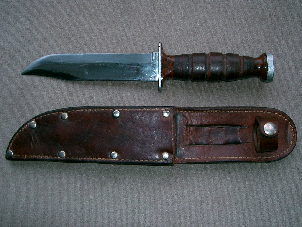

A Ka-Bar Commando. A good 6 inch bladed woods knife but it has small flaws that should be fixed. The tang has the usual 90 degree stress riser. The tang is prone to corrosion under the leather.
I'd want someone to bring the blade back, but in stainless steel. Keep the blade thickness at .185" - .190". Thicken (just a little, at least to the same thickness as the blade) and deepen the tang (current/original tang dimensions are .38" x .18", .5" x .185 would be much better) and eliminate the stress risers where the tang meets the ricasso. Use the first spacer to hide the swell of the tang. Keep the spacers, but use a tough plastic instead of the brittle Bakelite. Offer high visibility spacers of Day-glo orange or lime-green so we can find it when we drop it in the leaves, as well as some other color options. Keep the leather grip washers and the oval shape. Think about replacing the aluminum fixtures with brass.

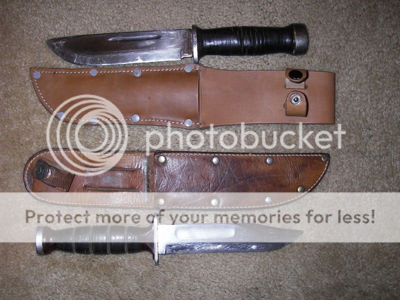

I find the MK2 to simply be too big, and a 5" too small. (comparison shot with the MK2 below)
I have several Cattaraugus 225s and like them for heavy duty work, but the Cattaraugus Commando is heavier than the Ka-bar Commando. I just spent 9 hours running a DR F&B through meadows with the Ka-bar Commando on my belt and a Kamel back on my back. More weight was not needed. I like that I can twirl the Ka-bar with my fingers. The balance is perfect for me. My only complaint is the weak tang design. It is time for someone to offer an improved model.

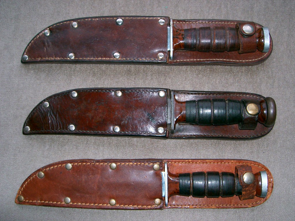

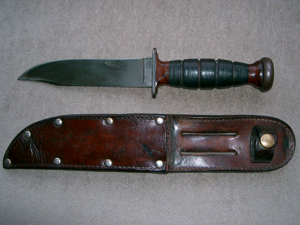

Ka-bar comparisons
The two different WW2 Commando knives.

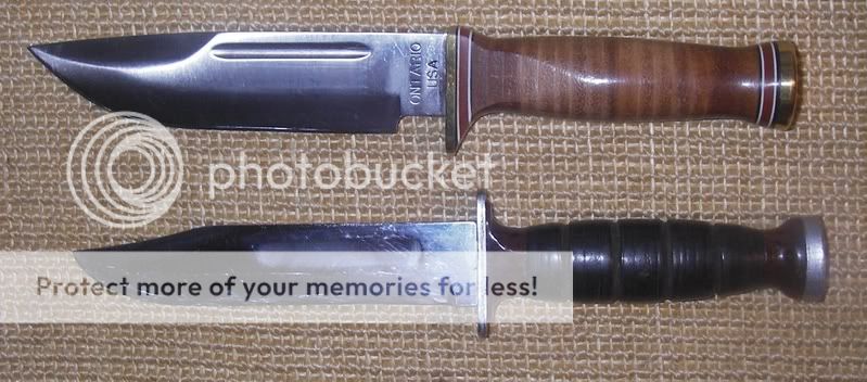

I already have an Ontario Quartermaster. IMO it isn't the equal of the original Quartermasters (i.e., the 225 and the Case 337s) and it appears to suffer from the same weak tang design issues as the Ka-bar. It also has a weird blade to ricasso area. The best feature of the Ontario Quartermaster is the stainless steel of the blade. Further the Ontario Q'master has a very skinny grip with some kind of coating on the leather that prevents a secure grip and the pommel is as cheap looking as they could make it. Also the balance is totally different.
