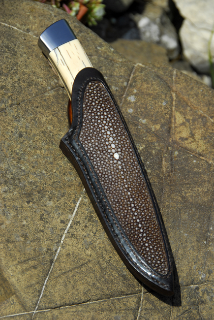

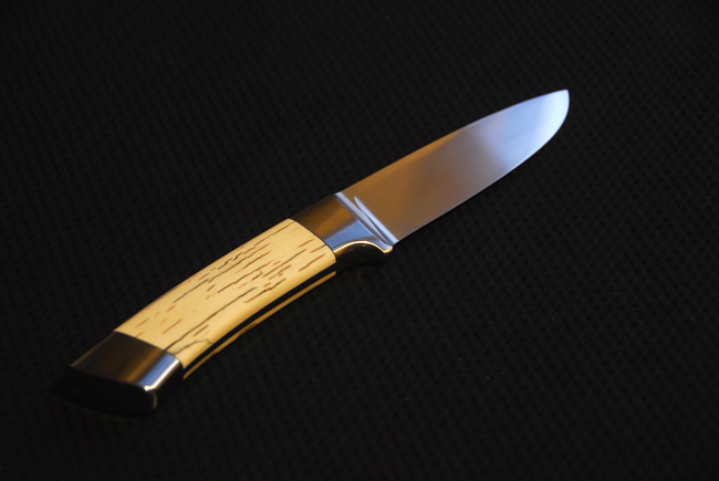

today I would like to show you a knife build quite a while ago.
In November 2008, half a year after I crashed into knife making I felt like creating something unique.
The result was my knife “ICE AGE” some call it “the beast”.
Details full integral hunter, RWL pm steel, scales mammoth ivory, hidden stainless steel pins
Length 9.45, blade 4.33 / 1.22 / 0.16; weight 235 gram taper tang 0.118 / 0.078
If you like to see some “making of” fotos. . . I got some more.
enjoy ;)
Regards from lake Tegernsee
. . . no comments!?!?

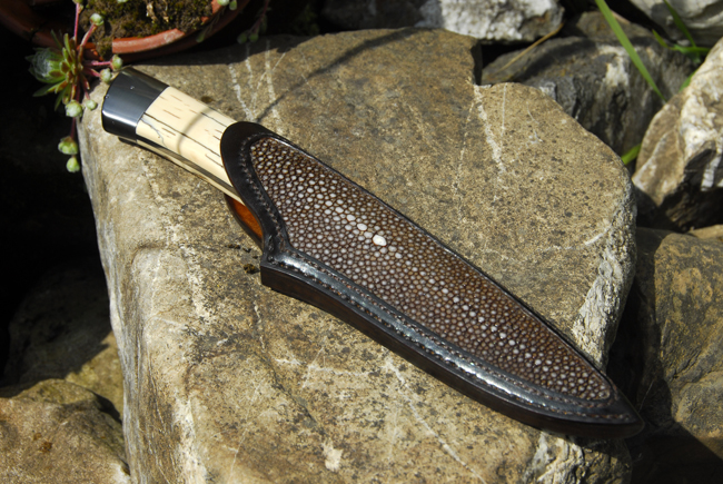

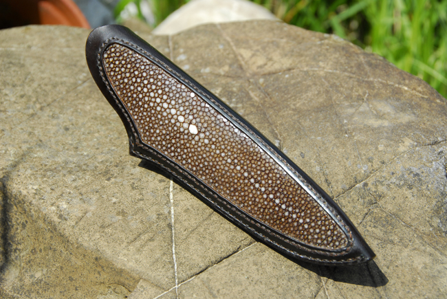

well, made this sheath for the knife

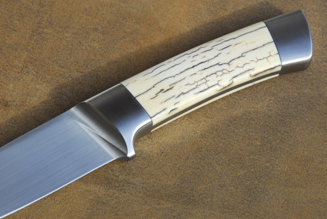

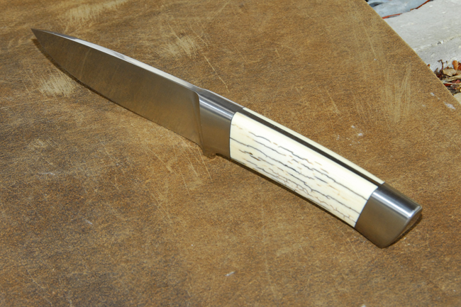

Hi,
here some more pictures . . .
the old lady is still doing a good job.
the goal regarding the sheath was: as close as possible to the drawing
that is one gorgeous knife. One thing I would love to see makers of integrals do -- radius the bolster to scales at the front and rear bolsters the same as done between the blade and the front bolster. I'd think the whole flow would look beautiful as opposed to straight lines. The sheath looks great and the package is just perfect. When I first looked I noticed it was integral and then when seeing the domain name of the user, understood the integral component -- gee are not all the German hunters integral??
