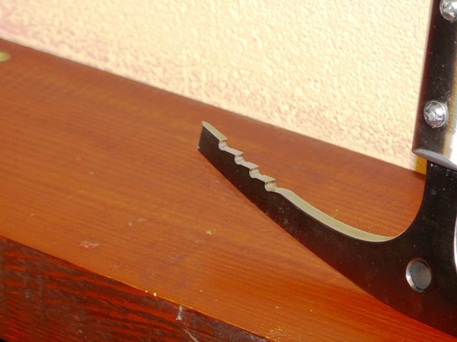

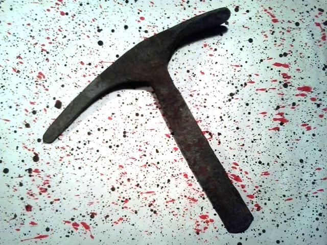

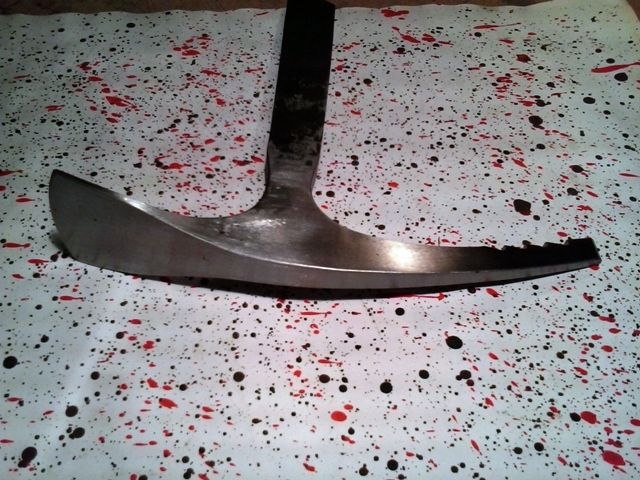

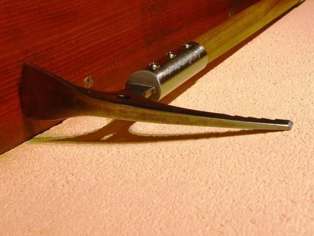

For inspiration I searched the internet to find a full hand made ice axe and I have not found one.
So, this is the one I made from scratch.

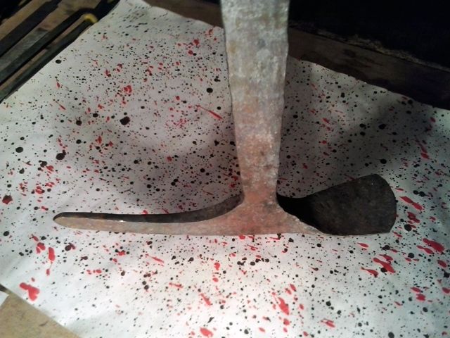

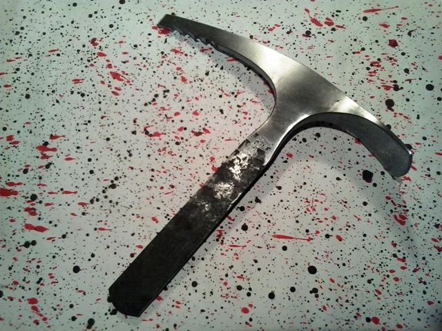

I used a combination of drop forge full body axe/hammer to forge the head
After some grinding
In the end it came out this

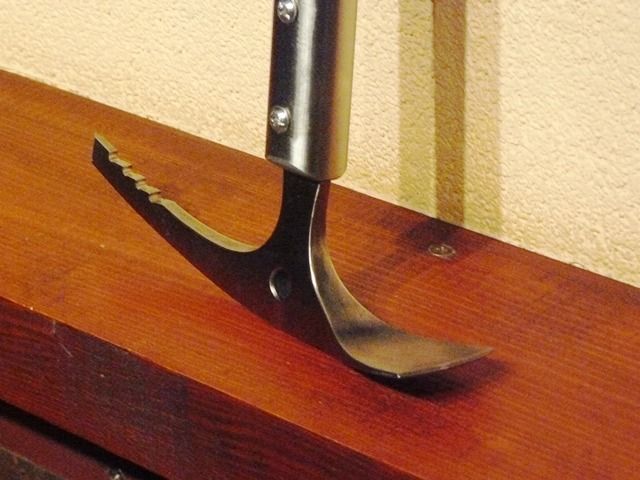

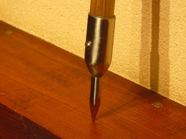

Has a length of 25,5 inch and weighs 30 oz. The shaft is made of acacia wood and the fittings are made of stainless steel.
I hope you like it.

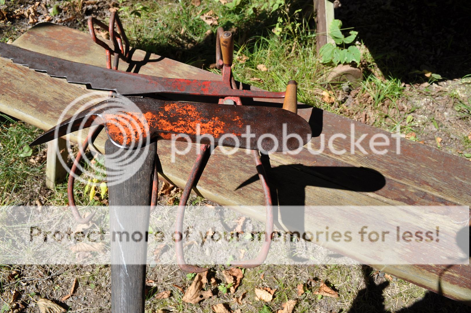

Here's what I thought of when you said ice axe. This one was used in the harvesting of ice. A little different than yours.

Thanks!
I now that tool but mine has another history.
It is known by the french name ”piolet” translated in the english ”ice axe”, even if it refers to the tool that you mentioned.
Nice axe. Seems a little short for a traditional climber's ice axe. What's the length of the head (pick to aze)?
n2s
Thanks, the lenght is 8,6 inch.
As you can see is a combination of a traditional ice axe (steel and wood construction) and a modern one (the head and shaft are smaller).
I have a height of 6 foot and the ax tip reaches my ankle, which is good for me.

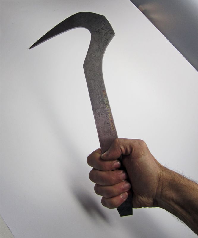

The shape reminded me a bit to this "thing" I made for other purposes:
