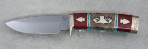

Buck did a number of titanium coated CPM154 bladed knives for Bass Pro in 2006, the same year as the blade on this knife shown below. You did not say what your handle was but here is a Yellowhorse custom based on that same 2006 TiN CPM154 blade. There was also a 2016 buildout of the same blades released with a darker DLC coating and Cherrywood handles. Hope this helps.
