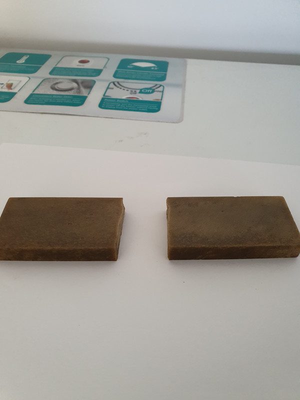

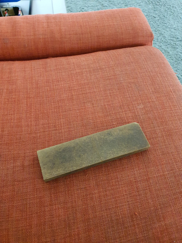

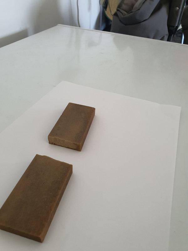

I broke my stone, but i really loved it and need help identifying it, so i may replace it. It was sold to me as a washita, but it is quite hard and quite smooth. Any help would be greatly appreciated.
I did something similar with one of my stones i used a little cyanoacrylate to glue it back together and it works great now.I broke my stone, but i really loved it and need help identifying it, so i may replace it. It was sold to me as a washita, but it is quite hard and quite smooth. Any help would be greatly appreciated.![]()

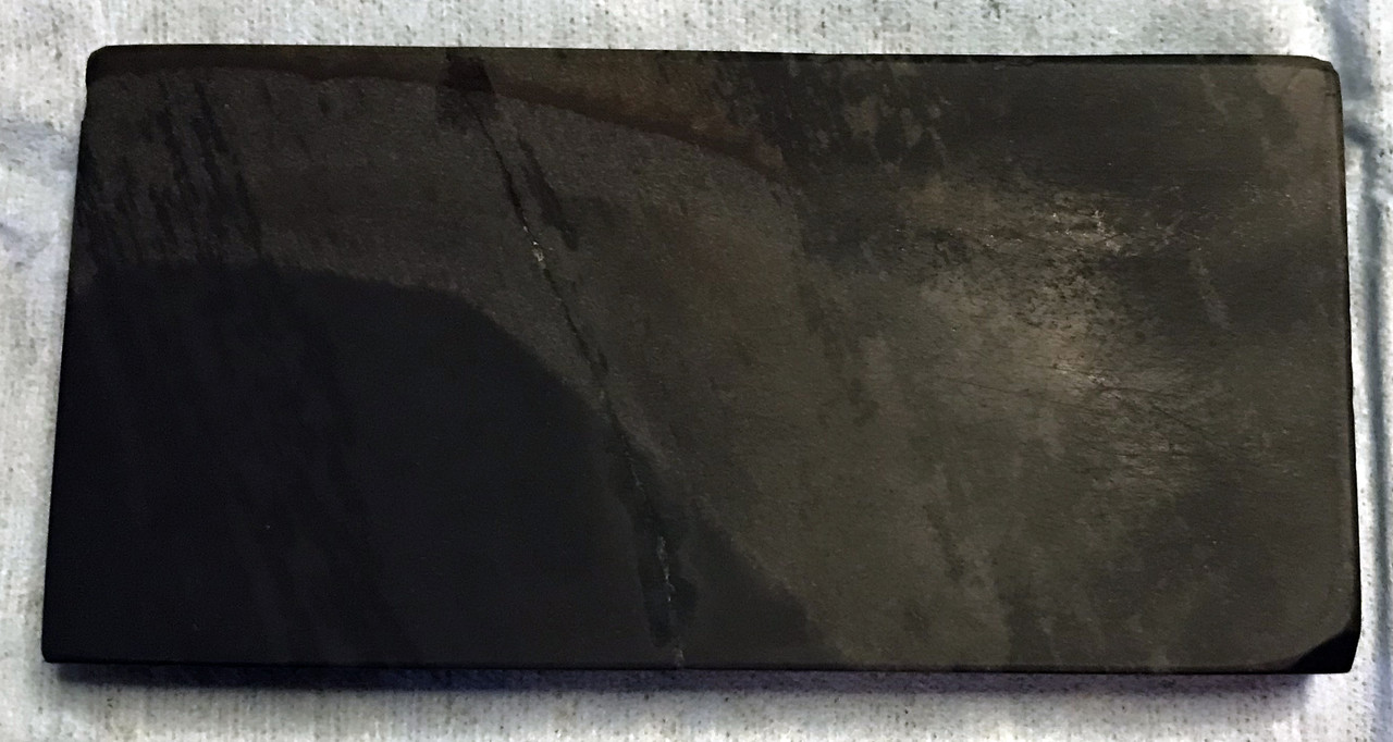

Here's a hard arkansas I've been using 10 years.I broke my stone, but i really loved it and need help identifying it, so i may replace it. It was sold to me as a washita, but it is quite hard and quite smooth. Any help would be greatly appreciated.
Washita. I would buy another one and use that one as two smaller stones.I broke my stone, but i really loved it and need help identifying it, so i may replace it. It was sold to me as a washita, but it is quite hard and quite smooth. Any help would be greatly appreciated.![]()
Looks like a slate.Here's a hard arkansas I've been using 10 years.

How so ?Looks like a slate.
The nature of the damage to the edges and the fine mica like reflective material particularly in the different color band upper right in your original photo.How so ?

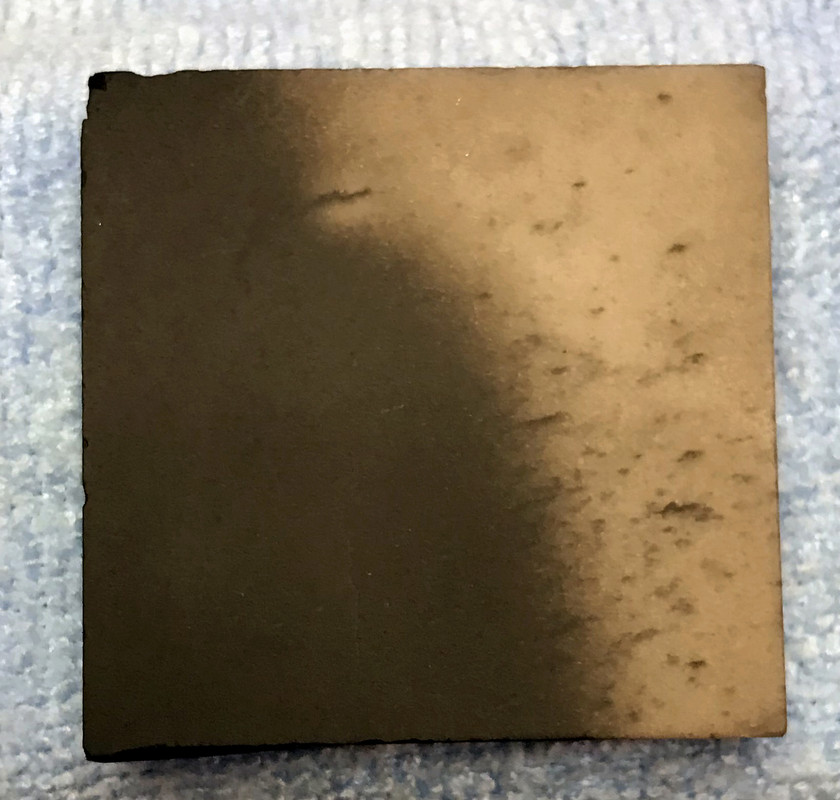

Here's another hard arkansas, part black, part translucent.
I have no experience with slates, unless this really is one.The nature of the damage to the edges and the fine mica like reflective material particularly in the different color band upper right in your original photo.
The slates will be much easier to slurry with a diamond stone or another stone (and are use full that way). They also don't have as high a pitched ring when tapped.I have no experience with slates, unless this really is one.
The edge chips are all conical, which is characteristic of novaculite. Is it the same for slate?

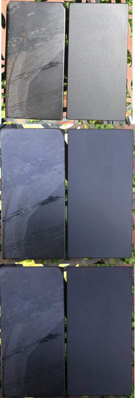

I cleaned it up and took comparison pictures with a Dan's hard black in different lights.
It doesn't ring like the Dan's, but is hard to lap. It could very well be a slate.The slates will be much easier to slurry with a diamond stone or another stone (and are use full that way). They also don't have as high a pitched ring when tapped.
I have miss identified more stones than I would like to admit with just photos and I could well be wrong here also but I would think that stone a slate based on that first photo. If it rings like a Dan's and is hard to lap like a Dan's it's a black ark.
