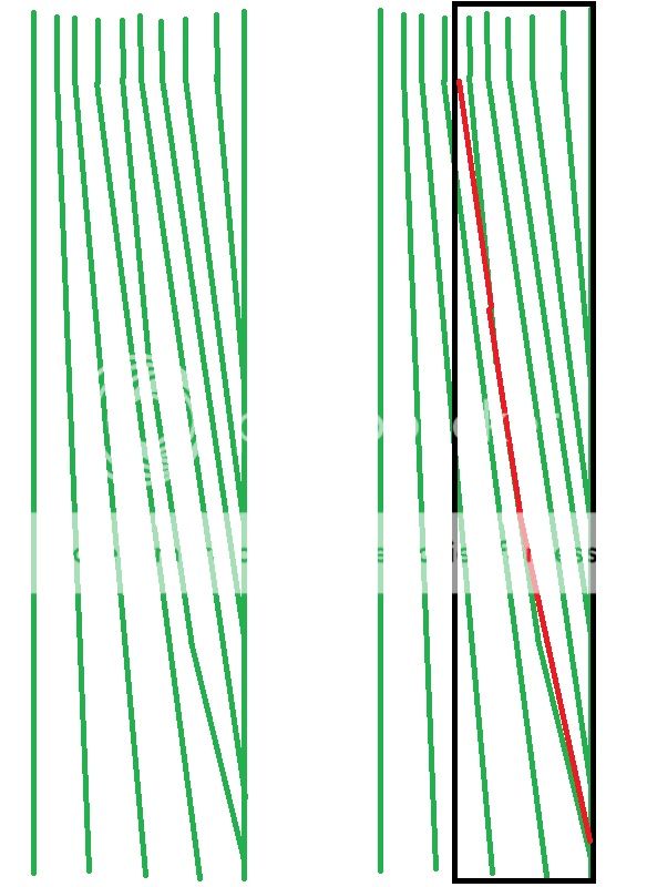

If by nicer you mean requires less thinning down, I'm in agreement. This was the case with both the Link handles I found at a local Ace hardware as well as some Tennessee Hickory Handles I purchased online. It used to perplex me too until I saw a particular sledge handle at Ace that I had to give some thought. As it stood it was probably fine, but you can see how it could have been an issue if they lathed the handle thinner:
So yeah - it's probably a matter of liability: the thicker the handle, the less perfect the grain orientation can be for the handle to still maintain overall integrity. Or to be more specific, the thinner the handle the more likely a run-out might go all the way across a handle (where-as it might have only went halfway and straightened out on a fatter one). We have to take into account that they do churn these handles out and can't visually inspect every single one so its better to be safe than sorry. The chance of catastrophic failure is a lot more likely on a 3.5-8 lb head than it is on a 2-2.5 lb head, so they probably figure they can make their boy's axe handles nice and slim but its better to leave their full sized handles safe and fat.
Most consumers would probably leave the above handle alone and use it as is and be fine. The savvier of us would probably know to pass on the handle or to shave down more on the right side rather than the left. If they aren't and go ahead with it, then the company isn't exactly liable when it was the consumer who altered the handle...
