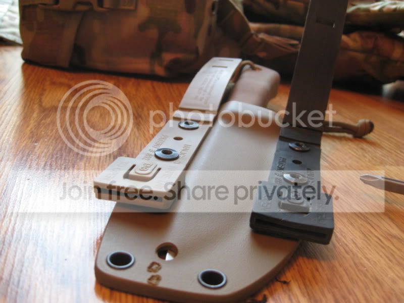

If you've ever wondered how to best mount a sheath to MOLLE...
Jun 27, 2011
266
I have the answer for you... the spacing on these MALICE clips is the same as the spacing on the TekLok... maybe its common knowledge, but I had no idea til I started playing with them. The only thing you have to do is make the holes a bit bigger if you wanna use the threaded shaft that Bladetech uses for the MolleLoks and the TekLok.
I had MolleLoks before and they are junk compared to this MALICE clip solution.
