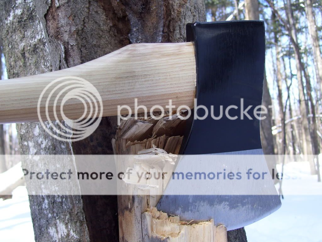

My test for this axe came on a winter camping trip in the North woods of New York. This hardwood forest had a mixture of beech, maple, plum and oak. There was no shortage of standing dead trees with varying diameters. After the campfire was started, we focused on gathering main fuel and this meant the axes were taken out. Large knives might handle small branches and trees but in a survival situation, a full-sized axe would be ideal. A person will burn more calories chopping with a big blade than swinging an axe. The axe’s weight works for you while the knife requires more power put behind it. My Gransfors Bruks Scandinavian Forest Axe is lighter than the Oxhead but I didn’t mind carrying the extra weight as the trade off was better cutting ability. After 3 days in the woods, this axe earned my respect.

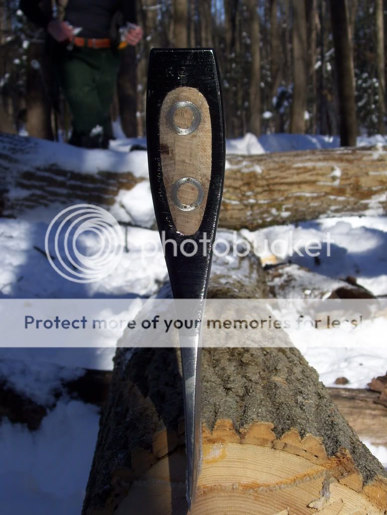

The head is secured with two conical pins. This is by far the best way to secure an axe head short of molding a composite handle around it like the Fiskars lineup. In using the Oxhead all weekend in a hardwood forest, there was absolutely no play in the head at all. This axe was used to fell trees and split sawed sections of wood. In a pinch, the poll was used to hammer tent pegs into the frozen ground. Again, not a single wiggle in the axe head with almost continual use in firewood prep. Everyone who used the axe commented how well balanced it was and how it cut and chopped effortlessly.

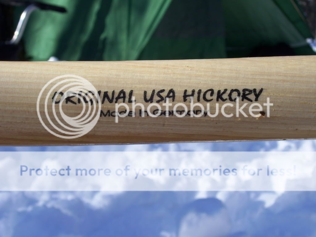

I was shocked when I examined the grain alignment of the handle. Even though the handle is a beautiful piece of American Hickory, the grain was almost perpendicular to the cutting edge. When selecting an axe or hatchet, one should always look for the grain of the wood to be almost parallel with the cutting edge for maximum strength. I was worried the use this weekend would cause fractures in the wood or even worse. I was pleasantly surprised when the axe handled all tasks with ease and showed no signs of wear. In this case, the looks of the axe handle were deceiving. Hopefully, the axe will continue to impress me as I have no reason to believe otherwise.

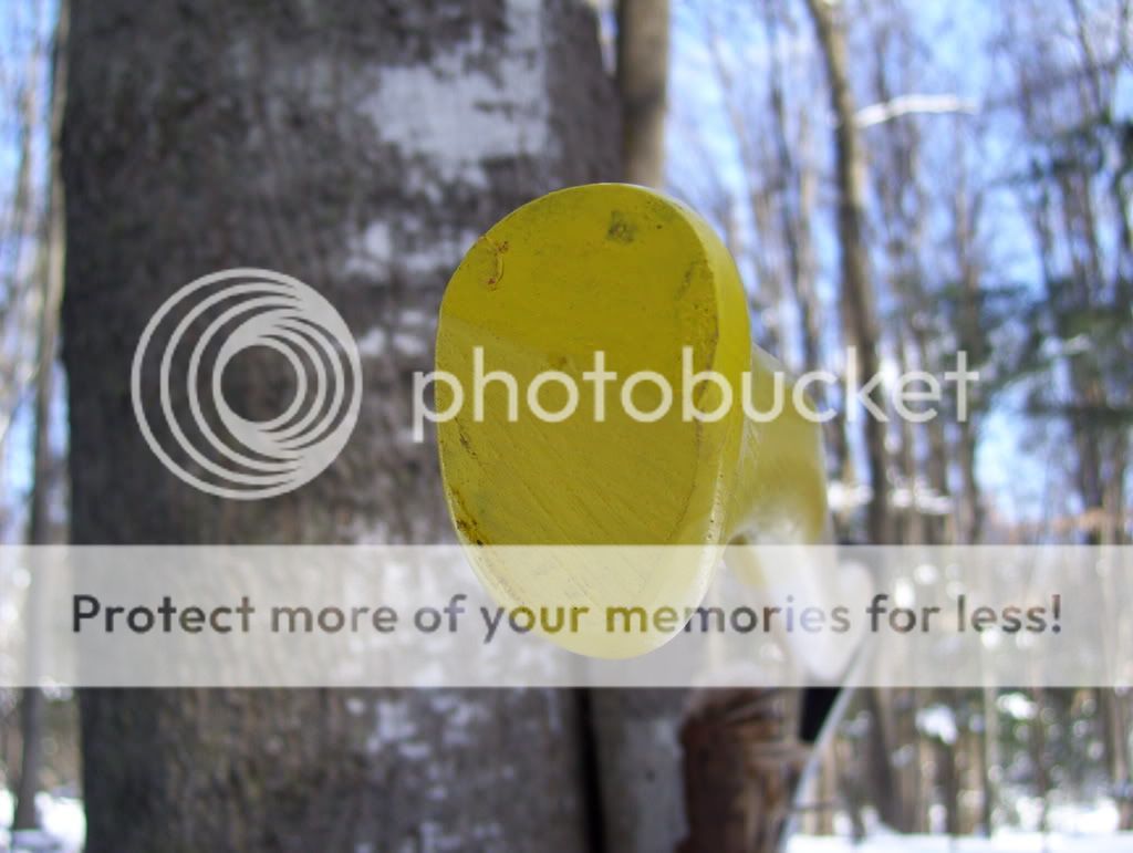

In conclusion, the Iltis Oxhead Axe was a true champ. The only problem I encountered with the axe was a small .75” roll in the blade after felling a 12” diameter shad plum tree. I’m going to take the blame on this one as I might have pried the axe out of wood instead of wiggling the head back and forth to release it. The roll was fixed with the spine of my belt knife and the axe continued to cut with no noticeable difference. If this is the only problem encountered, I can live with it.

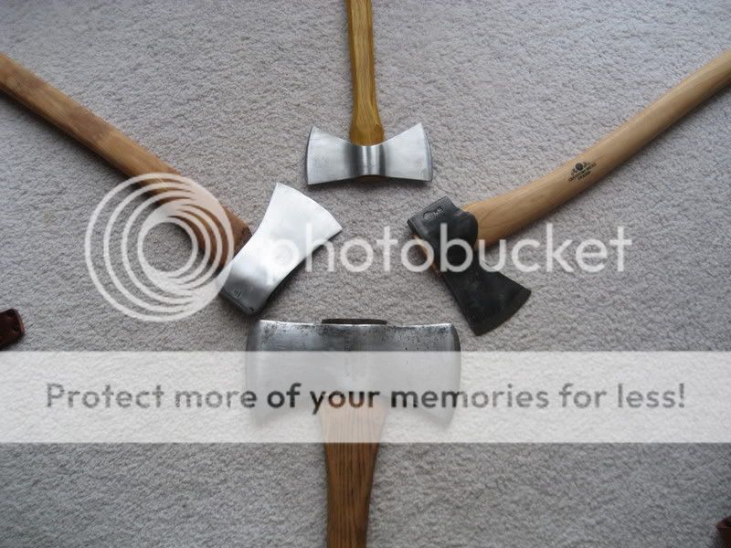

Nice review, and great pics. I often thought about buying an Ox Head, but you see I have a problem.
My name is tarmix101 and yes I'm an axe-oholic!:(
I NEED another axe like I need a hole in the head.
That pic doesn't show three Wetterlings, two older rescued double bits, and a GB Carving axe that is on it's way.:o
