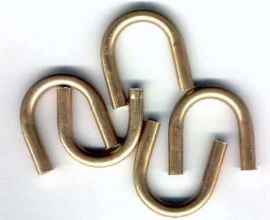

i need some small horseshoe-shaped pieces of brass tubing, about 1/4" diameter and about 2 or 2.5" long.
Every frigging time I heat it up and try to bend it, it flattens out in the middle of the bend.
I looked up methods to keep this from happening and I tried a few, but it's still not working.
I'd be happy to pay someone for making me three of these stupid little things.
I need them for my yoroi.
This is driving me crazy.

DIJ have you tried putting a very tightly wound heavy duty steel pring in the tubing after heating and before bending?
When my grandfather and I had to bend soft lead pipe we used a really heavy stiff steel spring to prevent that very thing.
i cant find anything that size...I did look for a spring, but i didnt want to buy a spring that cost 6$ for tubing that cost 2$ !
Fill the tubes with dry sand, packed tight, seal the ends, warm the tube up and bend away. Afterwards, remove seal and empty out sand.
You can seal the ends by crimping them over, soldering in plugs etc, the sand must be compressed tight.
The sand trick works. You can also buy a "tube bender" from a hardware store. It clamps the tube and supports it against a radius while it bends, so the crimping doesn't happen. You have to like the radius of the tool, though.
Might be an idea, if you use the sand trick, to still bend it round a form (bottle, dowel, pipe etc.) ... so you get the diameter of the curve that you want.
Folks used to use a metal alloy that melted at 160 degrees to fill the tubing. It was called Bendalloy. It could be melted out after bending. You still need to file a round groove in a piece of wood or something to bend around. Different resins, tar, lead, sand, etc have also been used. (paraphrased from Machinery's Handbook, 20th edition)

In the steam plant we use tube benders to bend and form tubes to shape for pneumatic and steam controls. We commonly work with quater inch copper tubing and some standard half inch copper pipe. Clamp the pipe into the bender and bend away. It works really well, and we do not heat the brass or copper when doing this. The bending process does deform the roundness just a bit, so the sand packing advice may help reduce this deformation some.
Tube benders for small diameter pipe are quite cheap, check out a good plumbing supplier.

Hobby shops that specialize in Radio Control models sell small diameter spring tubing benders for making fuel lines. Know any RC model builders? The sand idea sounds good too. I once watched a guy make a French horn by filling the tubing with the low melting point alloy described above. The bends stayed very round, as I recall. Some tubing is soft (annealed) and some is pretty hard. It can be re-annealed by heating to dull red with a gas torch (or the stove) and quenching immediately in water. It does get black this way, jewelers use an acid solution called pickle to prevent the oxidation - or remove it - after the annealing.

On the way tomorrow.:)
Steve
