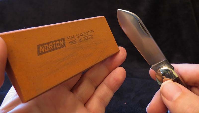

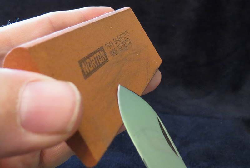

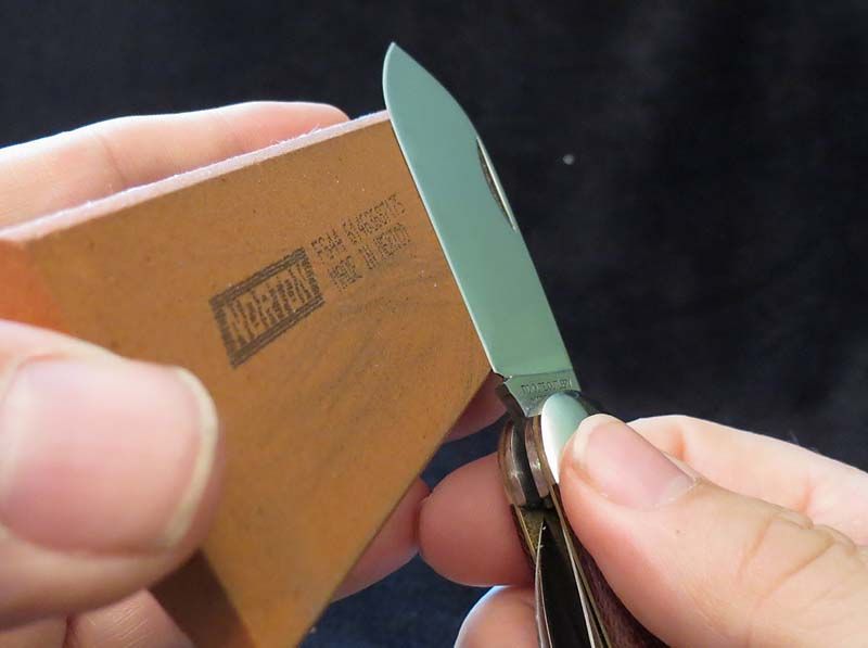

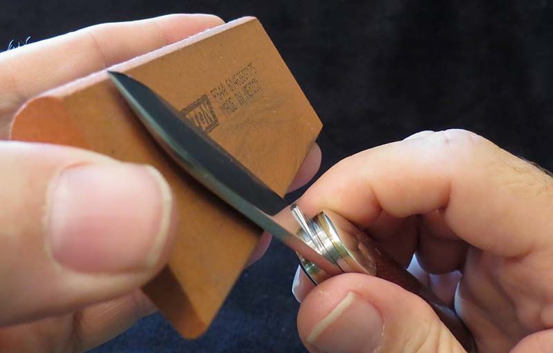

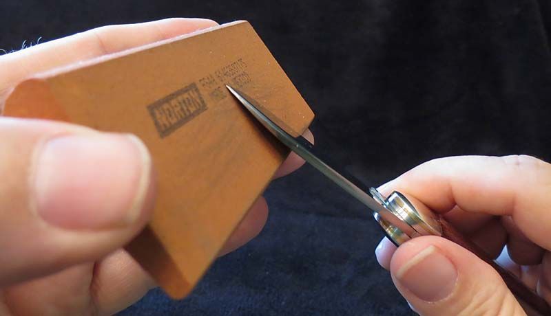

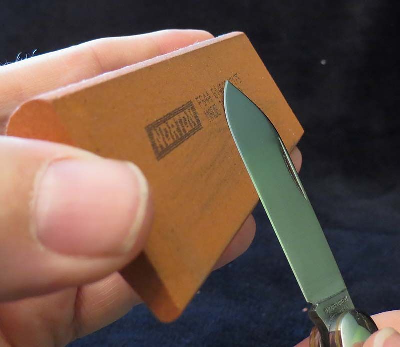

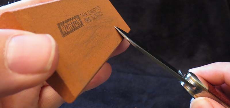

Well here's a pictorial of what I was trying to say above, using my GEC #79 Montana Workhorse in canvas micarta scales...
Kinda hard to shoot and demonstrate at the same time so pardon these shots...
I have some nice slip stones by Norton, they are tear drop in shape, when I need to remove a lot of metal, initial sharpening, I'll use the rounded corners to be more aggressive in getting the initial bevel set and then move to the flat portion of the stones. I have the coarse, medium and fine india shown here, then I go to the Spyderco Double stuff ceramic stone and finally onto a leather strop. The images below would be similar in action against the others as well.
Start with the tip on the stone, spine is raised up slightly, we don't want to scratch that main flats of the knife! ALSO what isn't shown here is that I will have my right index finger pressing down on the top side of the blade's side, that way I'm not putting undue stress against the pivot in the knife handle, less chance of making the knife become loose that way...since I was 'mock' sharpening, I didn't have my index finger on the blade, noticed it afterwards, it's one bit of info I think is important. In my previous method I would use my left hand on the spine of the knife to guide me as I pushed against the stone, so that also protected the pivot point of the blade, but, I use this method pretty much all the time now with great results!
As you progress to the stones, you want to make sure you get to where you feel a burr raised on the opposite side, you can feel that, but if it seems you can't feel it, it might be that there is a facet in the blades bevel that you haven't overcome yet. As most knives are done on belt sanders or motorized devices they can get some waveiness in their bevel. Tilt the blade towards a light, let the light play along the flats of the edge bevel, turn it slowly and it should just go to the edge, if you see ANOTHER flash of light, it means there is a facet there you haven't really touched yet.
Hope that all makes sense,
G2

After stoning, don't forget to strop to remove any wire edge. A wire edge (the thin strip of metal remaining along the edge after stoning) will make your knife seem dull as heck, when actually you just need to get it off. I use a cedar 2X4 on edge with a piece of leather glued on top and charged with polishing compound. Once you have established an edge it is easy to maintain by stropping.

Yep Pinnah, Lansky/EdgePro/WickedEdge/Sharpmaker are all fine things as free hand sharpening isn't for everyone that's for sure, key things to look for will still be true even using other methods, looking to get the entire edge bevel even, for me, is the first thing to get set and then progress on to finer stones and as Barry made mention a strop to finish it off.
Similar methods on the stones as with the strop, you want to make sure you raise the knife off the stone or strop before turning it over to do the other side, so you don't inadvertently roll the edge you are trying to make.
I've owned many a sharpening system through the years, which my wallet can attest ;) but I seem to gravitate back to free hand sharpening. You can also hand hold the larger stones and do as I'm showing in those photos too, just a bit more weight.
I also use my EdgePro stones in a similar manner, kinda stretches my hand to grip, as they are longer! but the finer grits are helpful sometimes.
The old saying " How do you get to Carnegie Hall ? " the answer " Practice, practice, practice" ;)

A couple more things regarding sharpening, at least the way I'm working it now, Tim Wright told me to not use oil on my stones, just sharpen dry, then clean off the stones with lighter fluid, it works amazingly well, these are the Norton type oil stones, for ceramics I use household cleanser such as Ajax or Comet to make the ceramics clear again of metal particles.
Now, again, just me and how I used to do it compared to now, no matter how careful I was, I'd get some tell tale abrasion marks on the side of the blade, from either where I'm gripping the blade as I move across the stones or some of the loose grit on the stone itself, even when I tape the blade, some grit would work it's way in there, very frustrating.
This new way, seems to be mark free, holding the stone as I do any extra grit falls off, doesn't build up on the surface of the stone. Here's a crop from one of the above photos also turned it side ways to help make it more viewer friendly, but you can see how evenly the bevel is on this edge, it's razor sharp and can slice toilet paper, for those times when I don't need an entire square ;)
