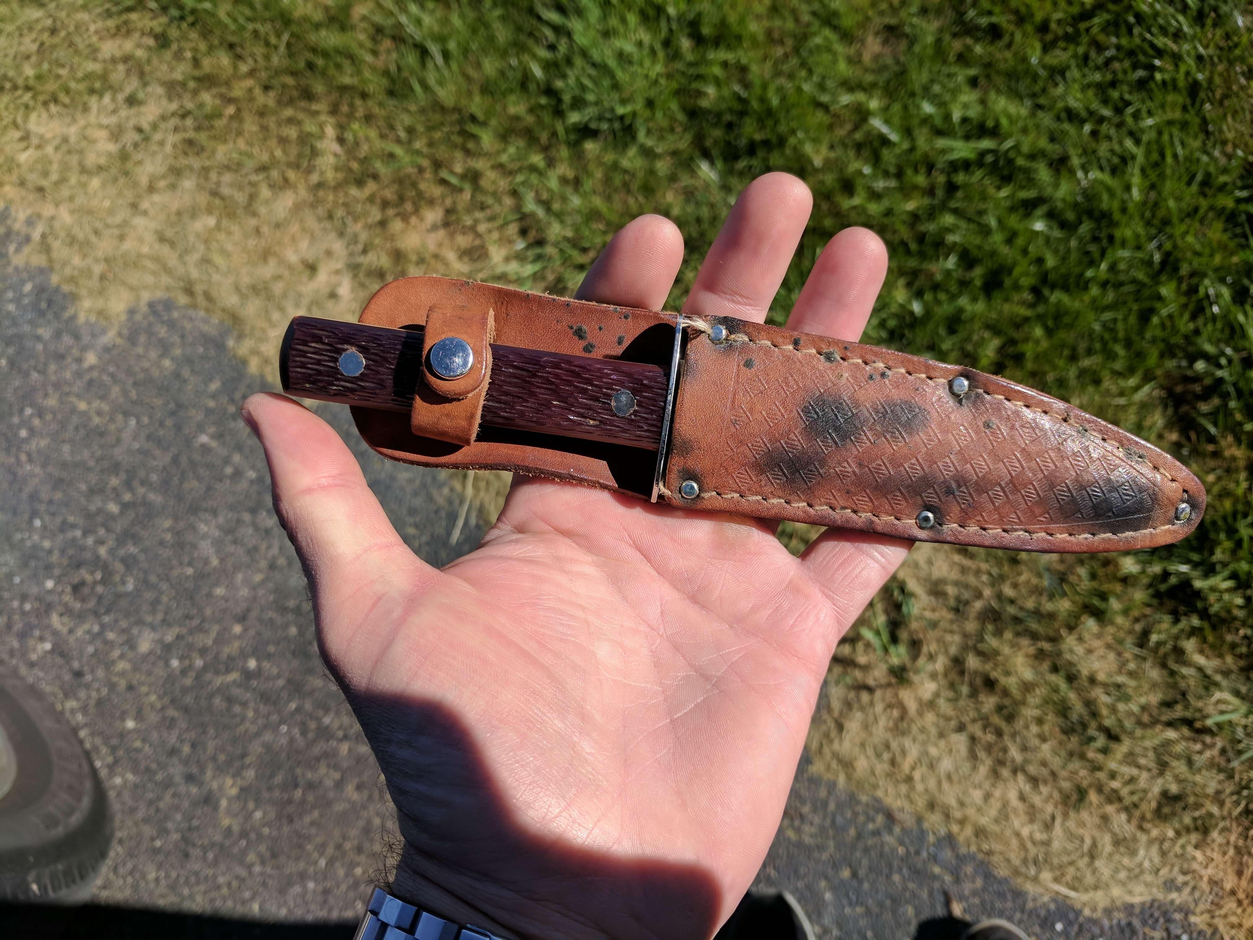

After seeing these pop up every so often on here, I had to have one. I probably paid twice what I should have in it, but it was still only $20.

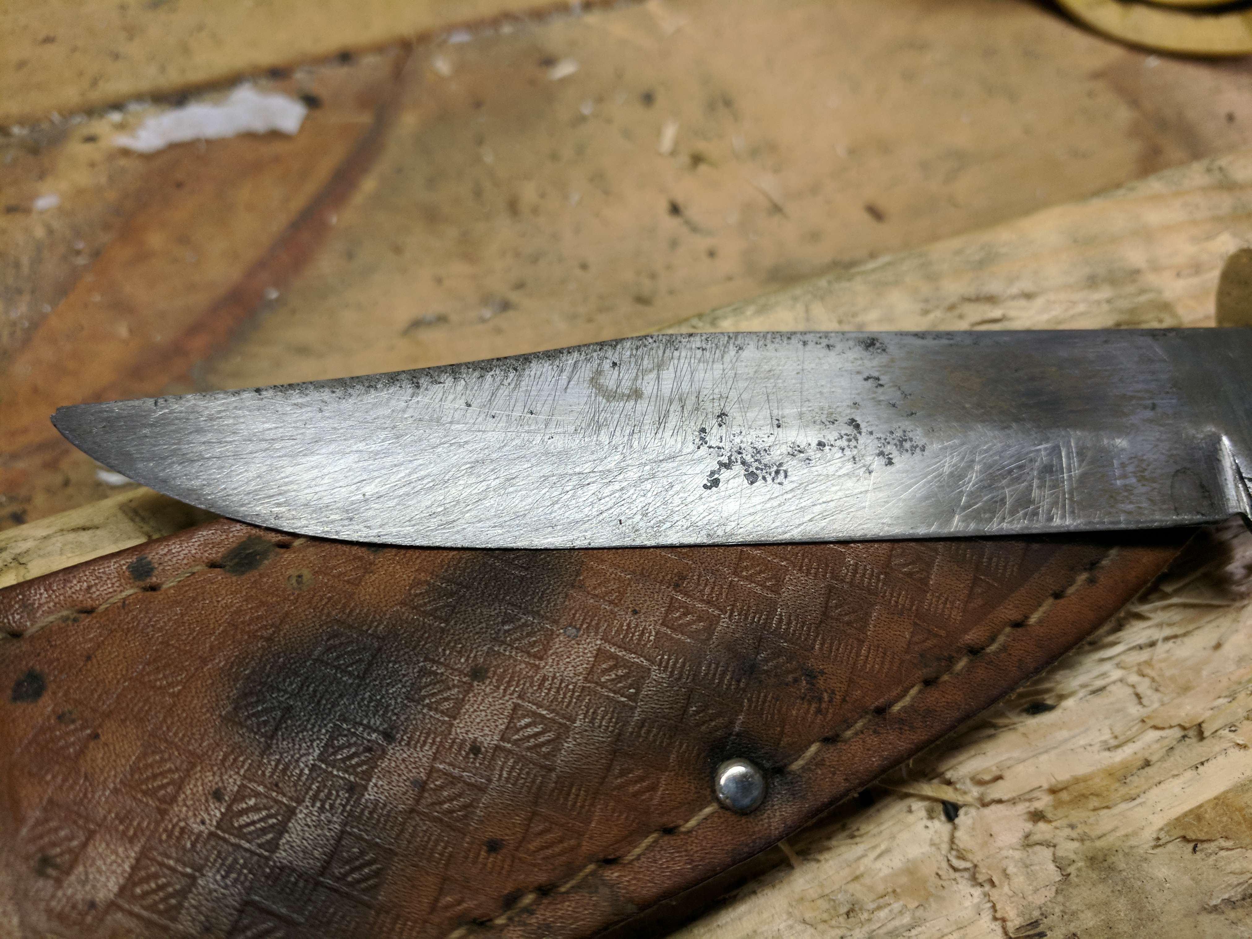

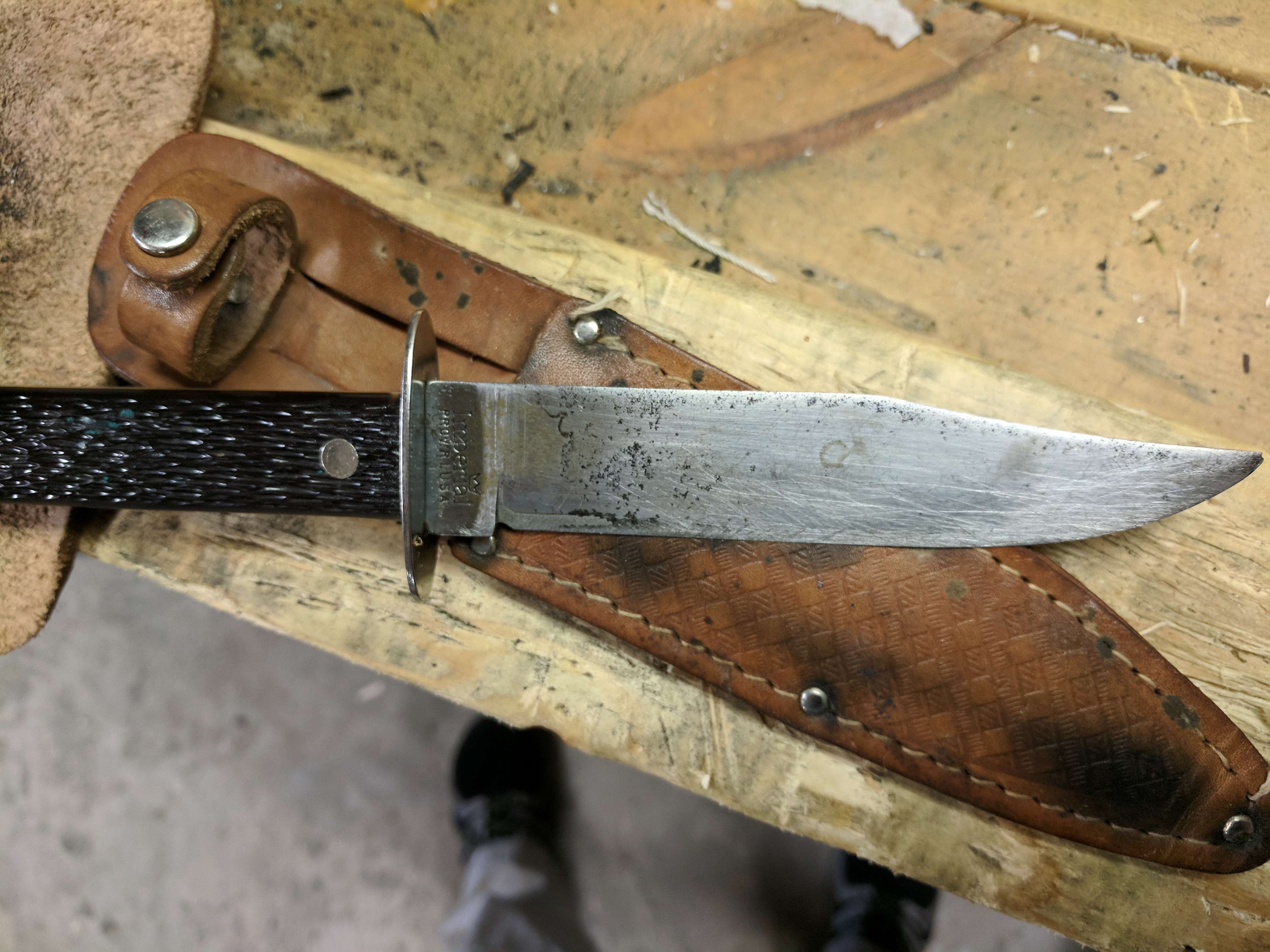

When it arrived, the blade had a lot of deep scratches all over it that I hadn't expected (they hadn't shown up in the auction pics):

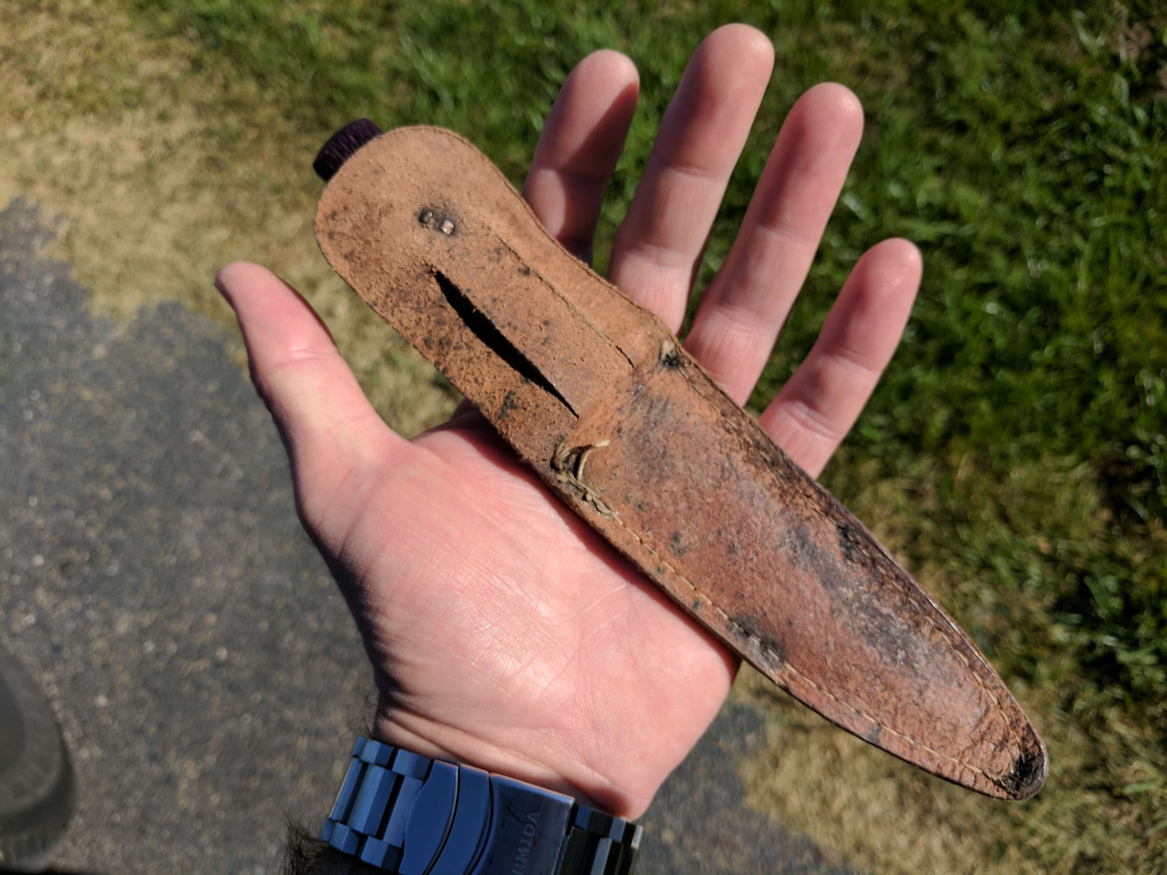

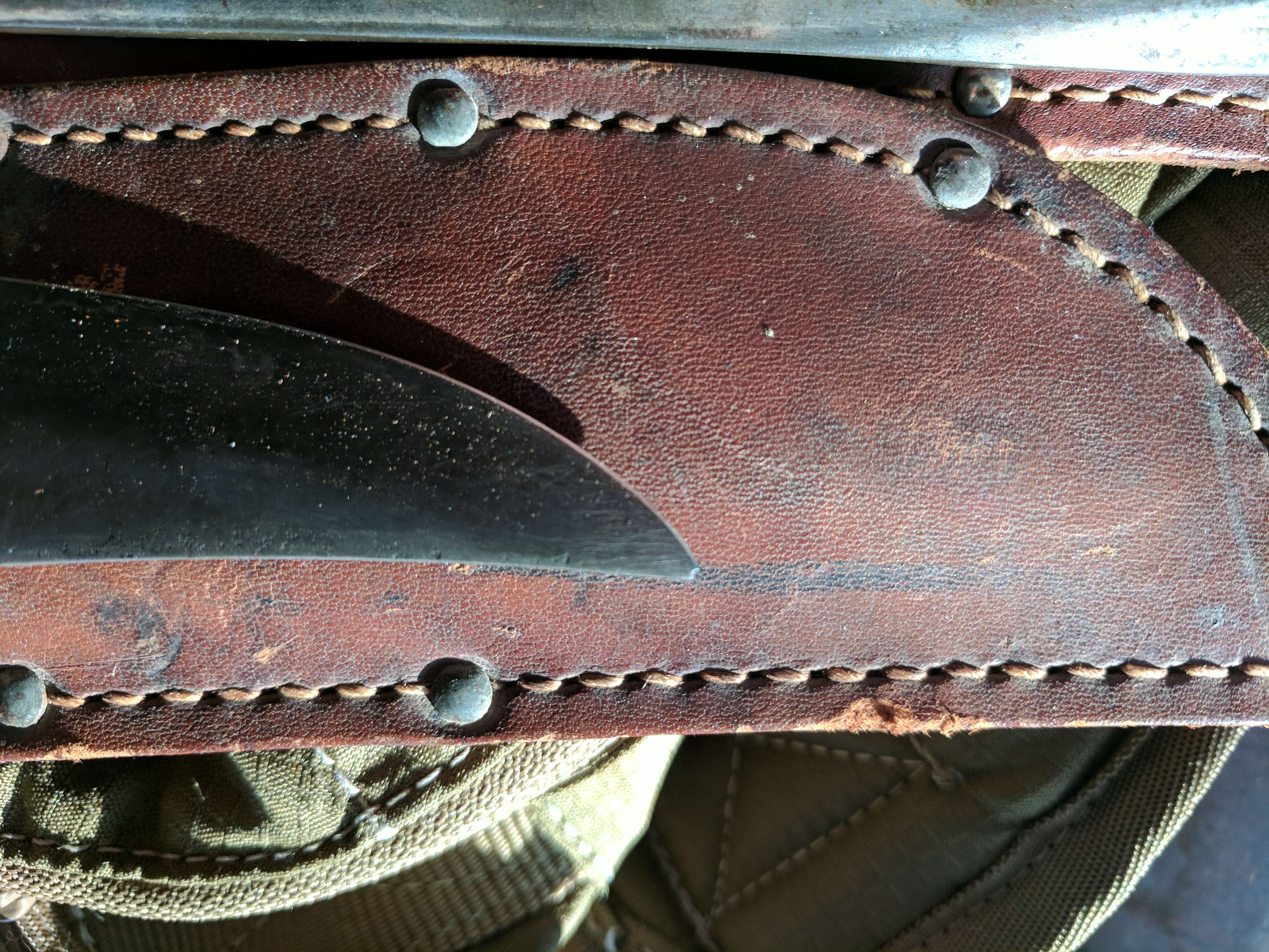

The sheath was nothing fancy, but the leather was in decent shape for a 40+ year old knife. I only plan on tossing it in my EDC bag, so it'll work fine for what I need.

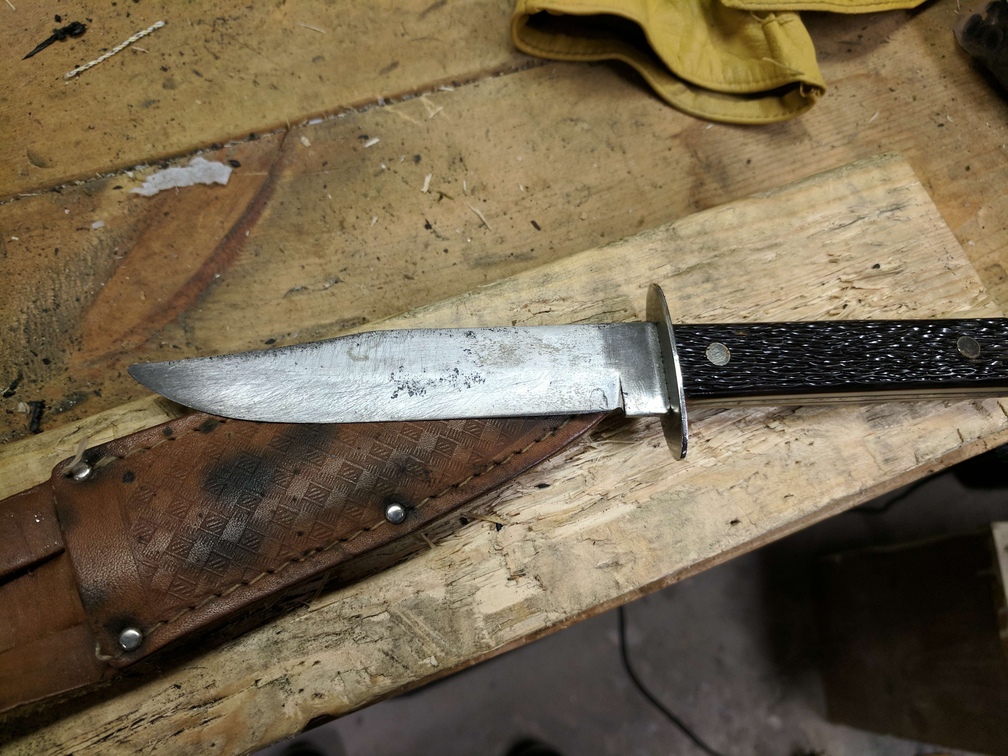

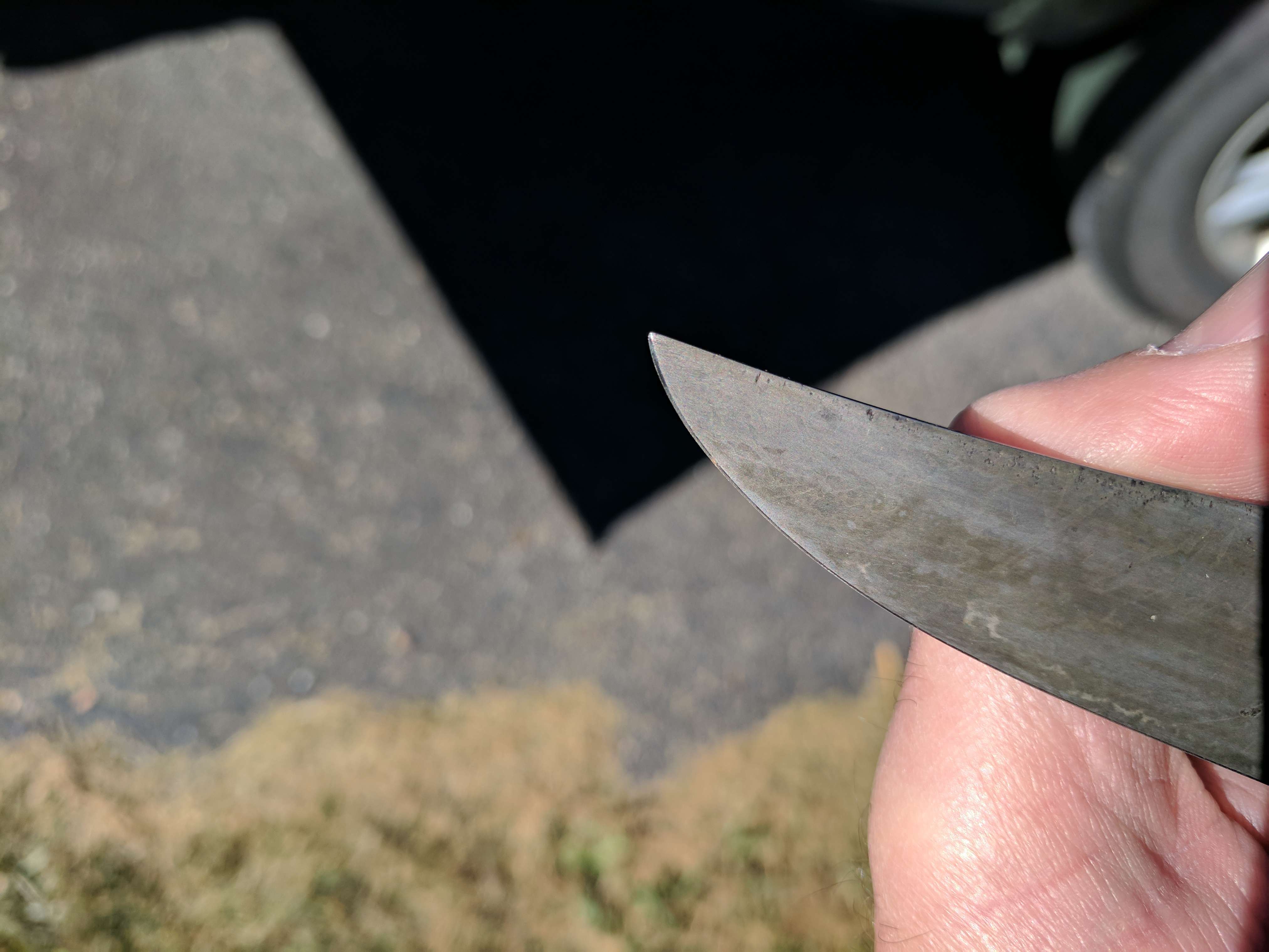

The very tip of the blade was also broken:
I started by sanding the scratches out of the blade. I think I went down as low as 320 grit (automotive sandpaper), and worked my way up quickly to 2000 grit and then some red polish compound on a cloth wheel. I didn't try to get the blade mirror smooth at all, and it went very quickly with great results.

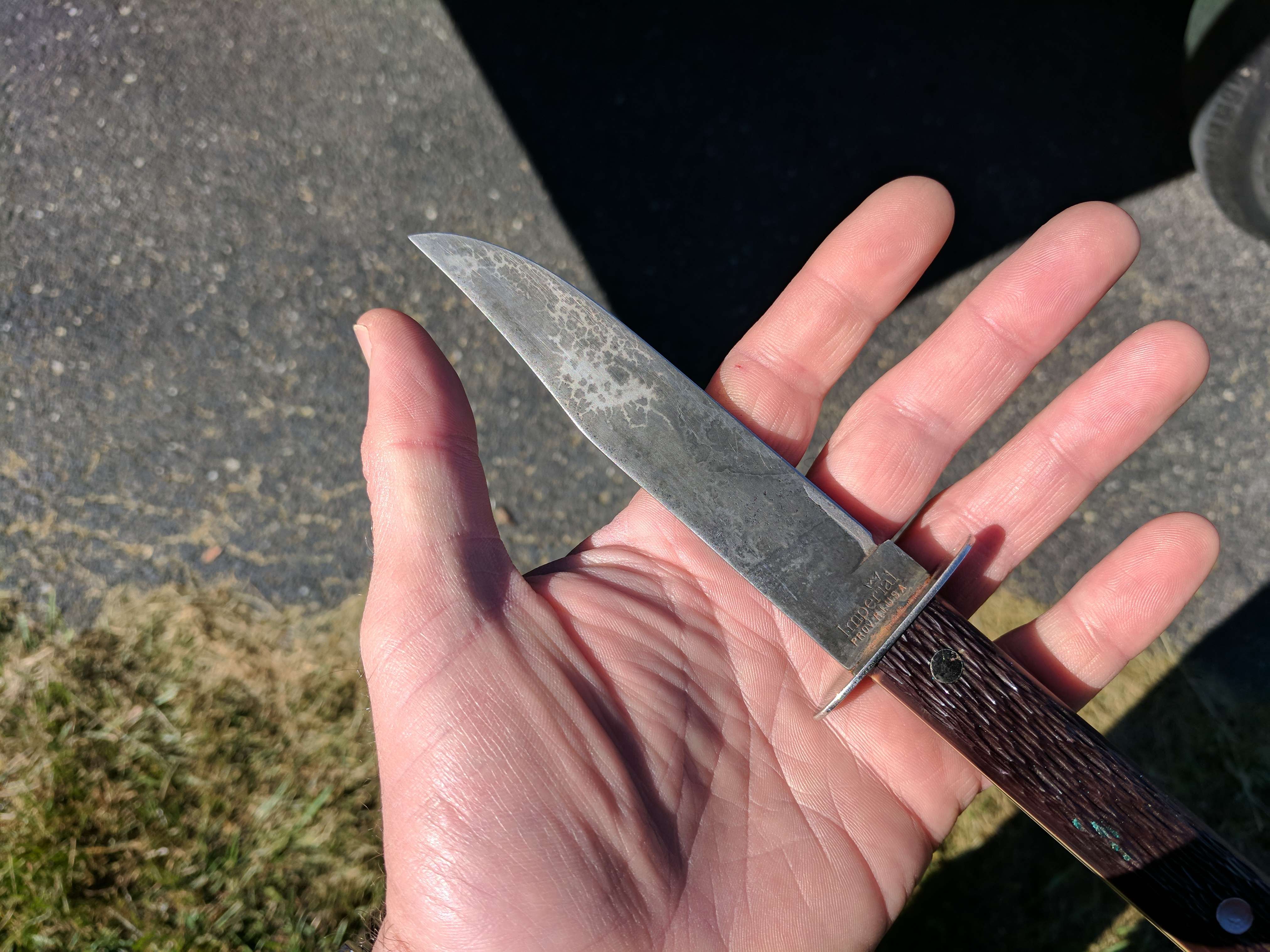

Once it was sanded to my liking, I forced a patina on the blade using paper towels soaked in Apple cider vinegar. One side turned out nice:
The other, not so uniform:
I suppose I could polish it off and try again, but I'm not going to bother.
I was also able to sharpen out the broken tip with minimal loss of metal.
It was super easy to get this knife hair popping sharp on my Sharpmaker--I'm very impressed with it. The plastic handles aren't cracked, but I may try my hand at replacing the scales with something a little 'harder use' at some point.

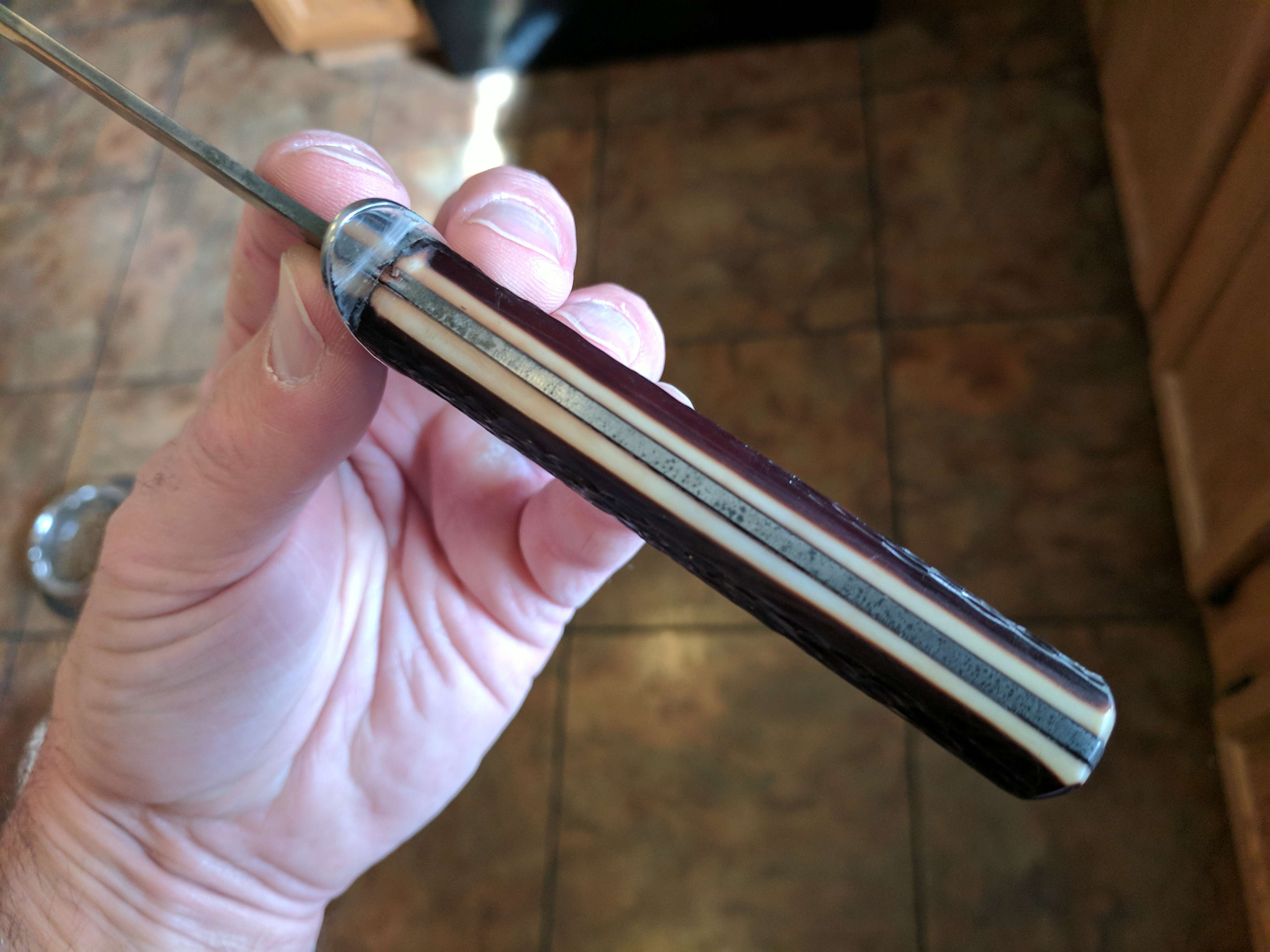

Here's a pic of the edge of the scales:
That's what I thought, I'm pretty sure this scale variation is the least common. The black ones and the animal head ones are definitely the most common.
If I were you I might keep them on there, but that's just me.
