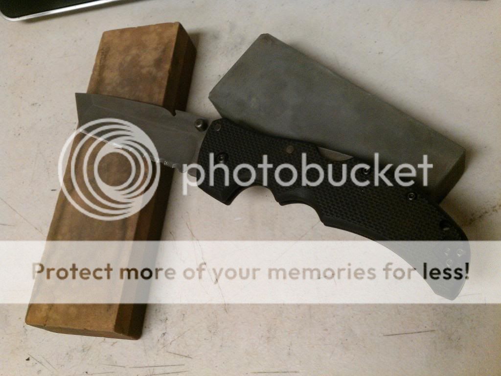

Now that Taiwanese Cold Steel Recon 1 Spear Point is thin ground. I have removed the black whatever paint.
http://nemoknivesreview.wordpress.com/2013/06/06/cold-steel-recon-1-spear-point-removing-the-paint-in-black/
And after stropping the blade to a dangerous whittling hair level, this big folder is breaking my own records. I was able to cut through the thick butt of plastic bottle twice in parallel cuts with ease. The handle is so confortable, I can apply a lot of strenght and the hollow ground powerful blade separate material like it's butter.
I'm really really impressed and will continue my tests.
I like the black paint on the Recon but it's look pretty sweet without it too. How long does that gel stuff have to sit before you can strip the paint off?
Oh, 20 minutes. It took me less than an hour to remove the black paint.
I have decided to keep the blade mounted on the handle during the process and not to take it apart.
So it took me more time...

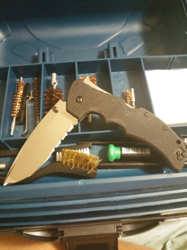

Have the tanto 4" with combo edge. I work in an auto shop and don't ask me why I did it but was amazed when it cut right thru a set of heavy gauge jumper cables with one hard rip of the knife. No damage and still sharp as all get out!

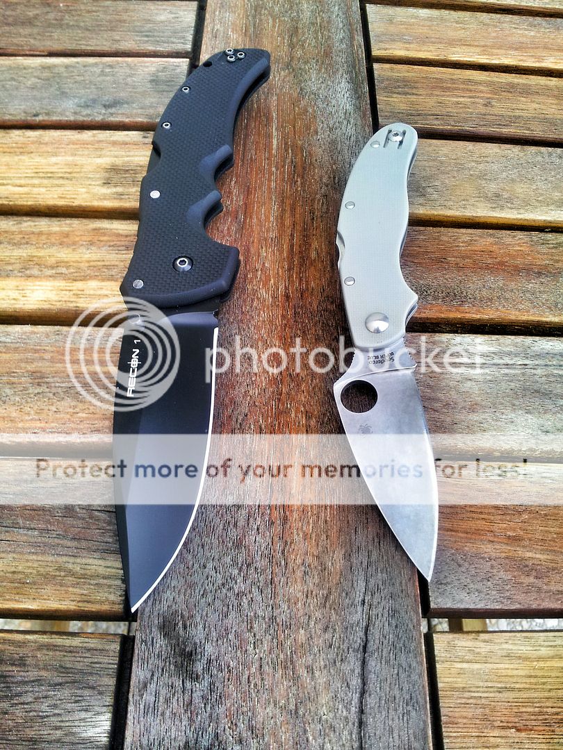

The Spear point seems to have a shorter choil and longer edge than the clip point too.
Juste comparing pics. :-)

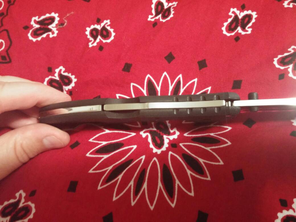

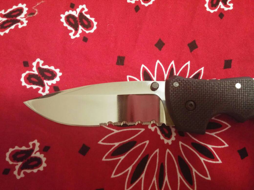

Can you elaborate on how you did this/ why? Im interested to know =]
Hey sorry, just went back through the posts and found it. It was pretty easy, but first I stripped using chemicals and elbow grease... (stuff is tough) I stripped with the parts together so the innerworkings are still coated with the black paint. Then I used a cutoff wheel on a die grinder to cut the slot. Then used files and progessions of sandpaper to clean up the channel and hand tune it to wave correctly. You could probably do the cut with a dremel, but its going to take a lot longer. Basically you have to lock the blade down in a vice and do a little bit of a cut at a time so you do not overheat the blade. After everything was cut and cleaned up pretty I made an acid solution of muriatic acid... I forget the initial acidity but you want to take that down a bit so its not super aggressive. I used hot water and added a bit of acid to it, then I just dunked the blade.... Did not even take it apart just used some wire to hang it in the acid until I reached my desired color and depth. (Make sure you wear proper safety eye equipment and chemical resistant gloves) After a couple washes with soap and water I took it and re profiled the edge freehand on my stones, then submerged the whole thing in penetrating oil to get all the innerworkings all lubed up. This blade also had its pocket clip done the same way, had to remove it to do it though... also the knife was completely serviced including reloctiting screws etc etc. Thats about it. If you have any questions just let me know. The key is just to take your time with the cut and think it out. I put the cut in a very specific area as to not interfere with the thumb stud and just be out of the way while still providing optimal leverage. You will see other guys who remove the thumb stud and cut into the hole to make the knife wave, but once that is done you cannot thumb open anymore and where is the fun in that? So my mod allows the knife to function as an easy wave, that doesnt get in the way, and still allows you to choose out of pocket if you want it to wave or not (no accidental waving)
