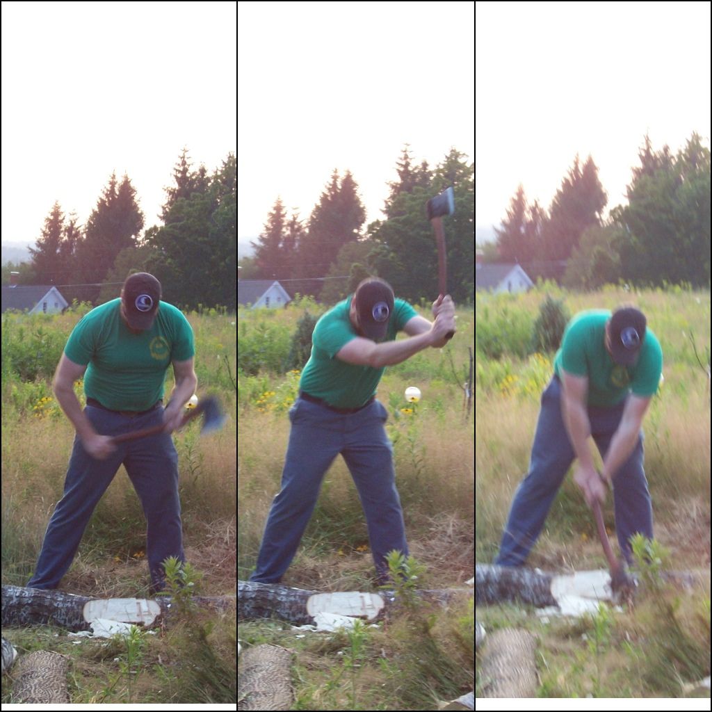

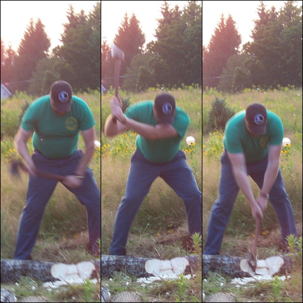

Looking for comments on how I can improve my swing (for bucking/chopping). Difficult to show it in pictures I'm sure as it is different most times. I think overall i need to square up more -it looks like I'm golfing in some pics :D . at 6'4" i also have a hard time getting low enough. should I bring the axe up higher.
thoughts? comments? I'm not having any real issues per se (I think my cutting angle is pretty good and I have good hand eye coordination and contact) and I don't want to over-analyze but always looking to improve.
left handed
right handed
Your technique looks OK in the photos. When chopping a downed log, I usually make my chop width about the same width as the diameter of the log if, If I can't roll the log. 1/2 the diameter if I can roll the log. I always take every chance to break the log when possible instead of taking those last 10 chops. Sometimes old age and wisdom is better,than youth and energy

Perhaps getting a different sized axe could help? It does look like you bend at the waist a good bit.

....... at 6'4" i also have a hard time getting low enough.
I think that axe is too short for a man 6'4" to buck with. I'm only 6'0" and I like a 32" to 34" axe for bucking. Your axe looks like about a 30".
Your back swing is plenty high. I only reach up if I'm making a super-swing while splitting. Even then, it doesn't add much.
I might second that suggestion for a larger axe. Or a longer handle, at least. You kind of make yours look tiny in the pictures... :P

I think the size or length is ok. If you look at racing axes, they are usually on 28-32 inch handles, and obviously those guys know what they are doing. Hence why tall guys like Coop and myself have to adjust to the axe accordingly.
Also, when u go with a larger axe, remember that's more overall weight, and more weight means you will get tired quicker, and when u are tired that's when you get sloppy, and that's when an accident happens. Staying in that 28-32 range allows one better accuracy via less weight and handle more control, and for longer. You get a #4 to # 5 lb head on a 36 in handle that's a beast to swing after awhile, and you leave yourself open to a better chance of an accident IMO.

Thanks Op. The axe I was using was just one of many. I have so many axes and try to use as many as I can. I generally stay within the 3-3.5# on a 28-32" handle range. Thanks all for the tips. I just keep on doing what I'm doing. I was taught left and right handed swinging through the forest service. I'm not competing and I like the idea of not wearing myself out with one side. Learning left handed swinging has been one of the best thing for me. Overall, I'm happy with the results but feel I can always improve.
