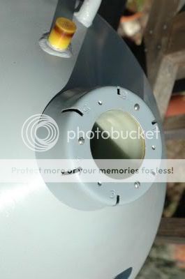

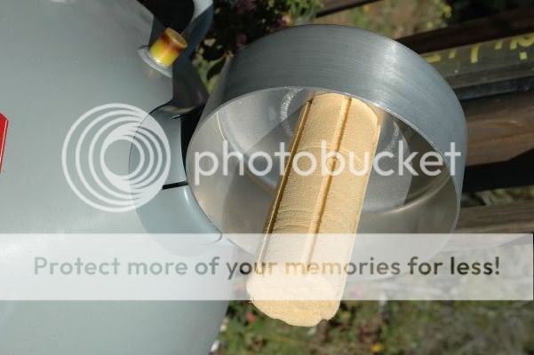

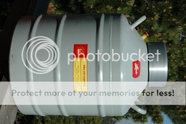

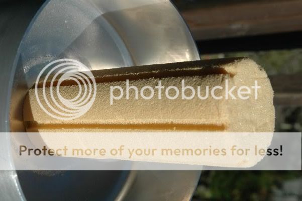

Bill,
I sent you a zip file with these pictures in it but just in case here they are hosted at PhotoBucket.
The little yellow nub is a grease filled cup which I believe acts as a pressure release valve.
This particular Dewar is about 17" in diameter and stands about 24" high.
Hope these help.
Allen
Bill,
I forgot to mention, the foam plug is not soft or spongy. It is firm like a styrofoam but very very lightweight. Lots of air gapping. High density foam may not have the requisite insulating qualities.
Allen

I'd imagine the 'foam' is some sort of spun glass material similar to the refractories used in our forges. Honestly, I'd be careful with a DIY lid, as you are dealing with some extreme conditions. And the venting as others have mentioned is absolutely necessary. Another thing to note is companies maybe unwilling to fill any dewar they deem unsafe, or appears to have a makeshift lid.
-MJ
Update on the foam, I've been doing some searching and that is referred to as the 'necktube core', and I've found several manufacturers offer rebuilt ones, just do a google search for it. That and the brand/specs of your model should help you find a direct replacement, that and a cap would still be at least half the cost of a used dewar on eBay and much safer then trying to build your own.

Mine has a styrofoam plug similar to the one in the picture. The slots are there to accomodate the round rods that hold the specimen cans. The cans hang inside.
That little plug on the side is where the manufacturer drew a vacuum between the interior core and the outer can. Protect that plug or you'll lose your vaccuum.
In use, mine has an aluminum cap/cover that fits loosely over the strofoam top plug.

Don,
That's interesting. I did not know that the little plug thingy is used to draw a vacuum. Mine has a little plastic cap over it but the opening is filled with some sort of grease. I've not taken the grease out to see what is underneath.
Do you know how much vacuum is pulled? Are there are services that will test and verify the proper vacuum and redo it if needed?
Allen
