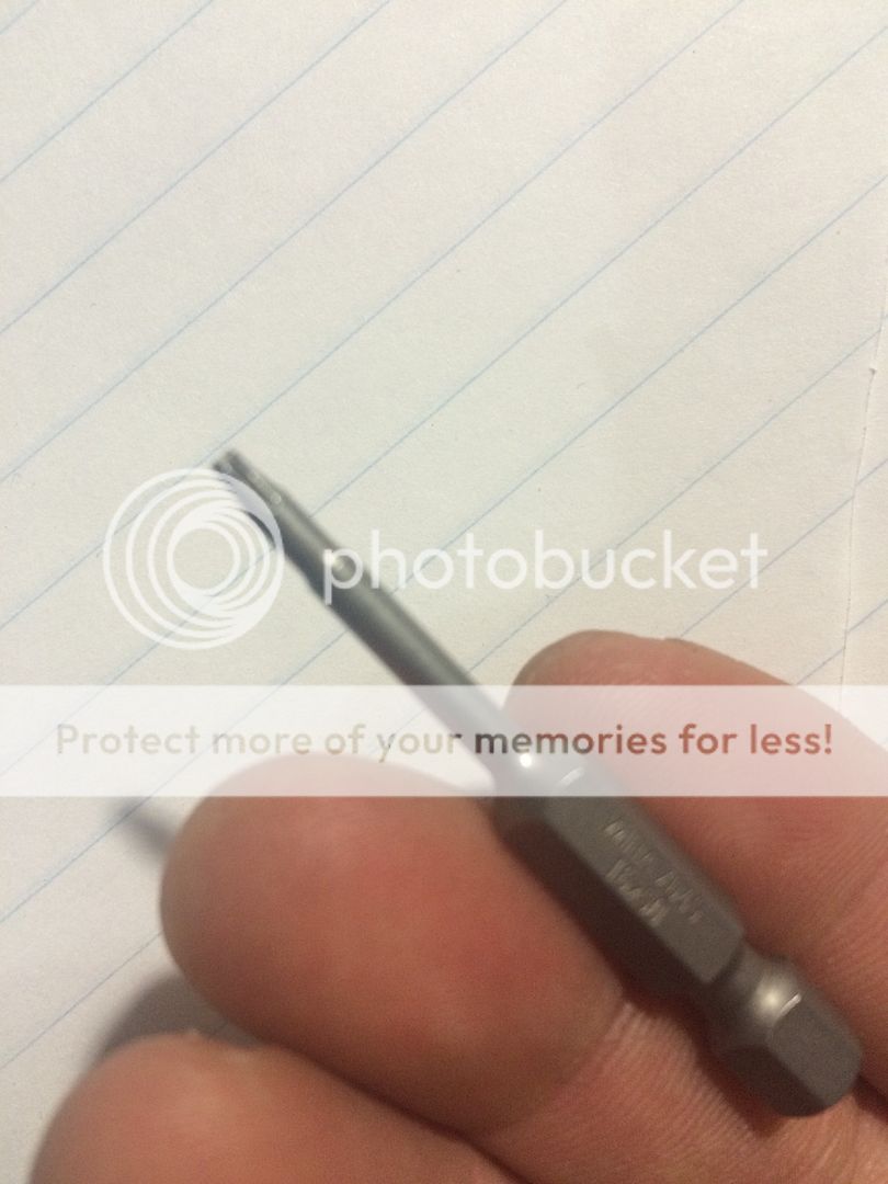

Based on my experiences with screw extractors on screws larger than T6, I'm kind of loving the suggestion of gluing a bit into the screw head as a solution. Drilling the screw perfectly centered, not breaking the extractor in the screw while trying to get it out, lots to potentially go wrong... 1/4" X 1" T6 bits are widely available and inexpensive (only $1.38 each from my industrial supplier, probably less out on the web) I have also used on screws larger than T6 the trick of tapping a slightly larger Allen key into the Torx recess and then removing the screw with the Allen key or bit
Wihas are pricy, they cost about 3 times more but they are awesome, make sure you check your T6 bit condition periodically, it does wear down.

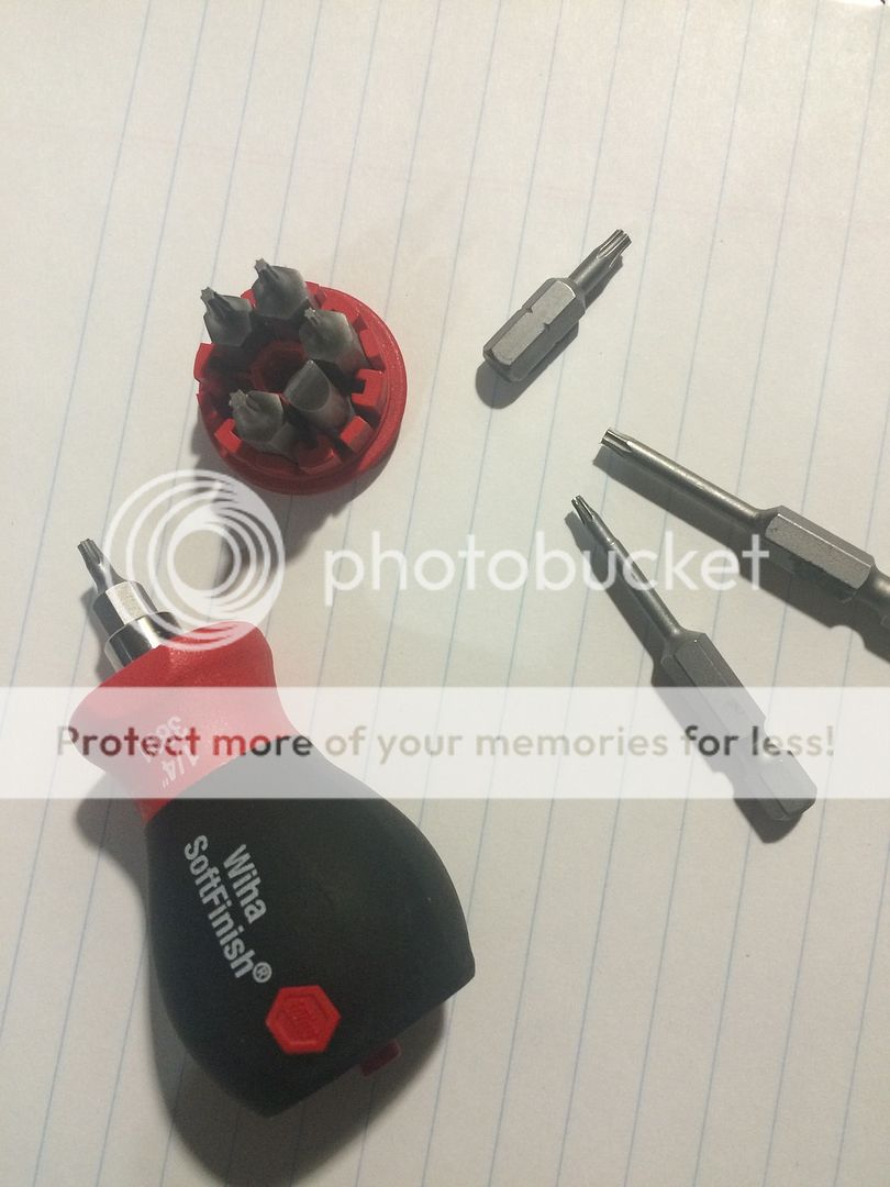

I love the 2" bits, they give you enough comfortable purchase to use without handle, I use them to reinstall screws finger tight. Here is a pic of my set up, the 2" are bought individually, T6 & T8
