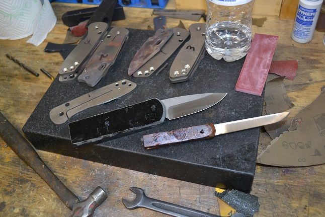

Kogotana with Ironwood and a Hunter Prototype in AEBL with Black Micarta... Framelocks in background!

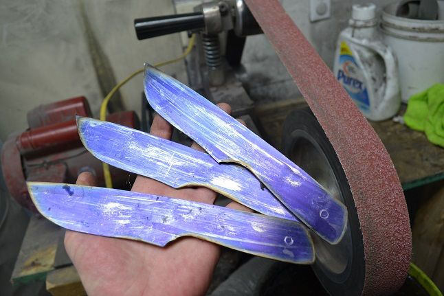

Profiling S7 Recurves with the grinder...

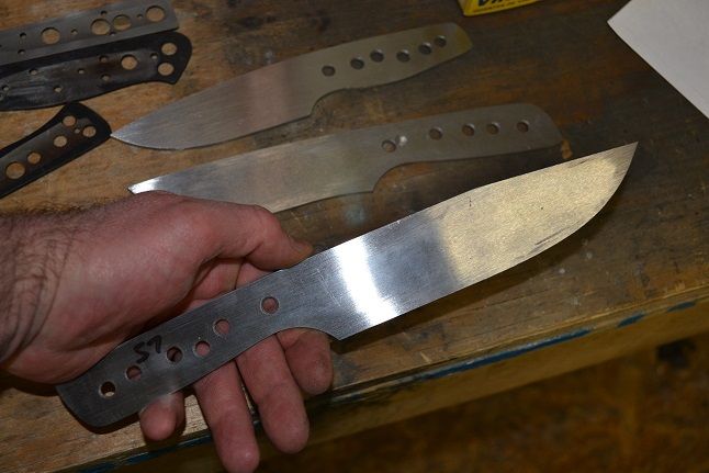

S7 Fighter, S7 Recurve, S7 Hunter Prototype

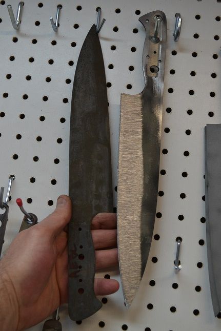

240 mm Gyuto's in 52100 and AEBL steel... not pictured is one more sanded to 600. These are huge, high RC and take tons of time to hand finish but I'm getting there! :D

Are you profiling with an AO belt? Or are the knives not directly related to the belt on your grinder?

I'm profiling with a 40 grit Cubitron II Ceramic belt, they eat metal (and fingers!) like nothing else. Full speed! That is the setup actually used for them in the pic.
For these I cut my steel bar with the chop saw then grind to profile.
I hang the belt 1/16" off one side of the wheel and grind the steel away in 1/4" chunks... probably took 5-10 minutes at the most to get to this point. I hold the knife horizontally so the grinds are very rough.
I'll set up my flat platen next to clean up the grinds. Drilling, chamfering and cleaning up the flats will happen after that.
They are blue because I'm using dye to help show my scribed (from template) lines to grind to.

I'm with you Rolf! These next half dozen might be the last ones to get so much sanding. A 240 mm Gyuto takes about 10 hours to hand sand.
The Kitchen knives are more of a passion than anything...
I rotate work like a weightlifter if I can... grind one day, at the mill/drill the next, hand sanding day, sheath day, etc...but grinding and sanding is most of it! :D
