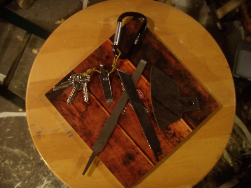

after reading some stories in which JACKKNIFE mentions the sears 4-in-1 keychain screwdriver his dad often used to fix things, i looked for one, only to discover that they were no longer being produced. so i headed down to the basement workshop and made something that would do the same job. i cut a peice out of an old shovel with a broken blade and ground it down into a two ended screwdriver for my keychain. the small end i based on the phillips screwdriver on the can opener of my swiss army knife:
also in the photo is a worn out file i ground into a chisel to fill a need for a particular size, along with a small shop knife i made from a worn out reciprocating saw blade. also a scraper made from the same shovel as the screwdriver

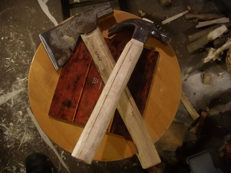

i also like to make my own handles for things when i can, especially when i buy hatchet and hammer heads at the local antique shops. i also don't see much point to paying for a file handle that i can whip up myself in a minute or two. the awl is a replacement made for another one much like it that i managed to lose somehow, made from a large nail and a peice of maple.

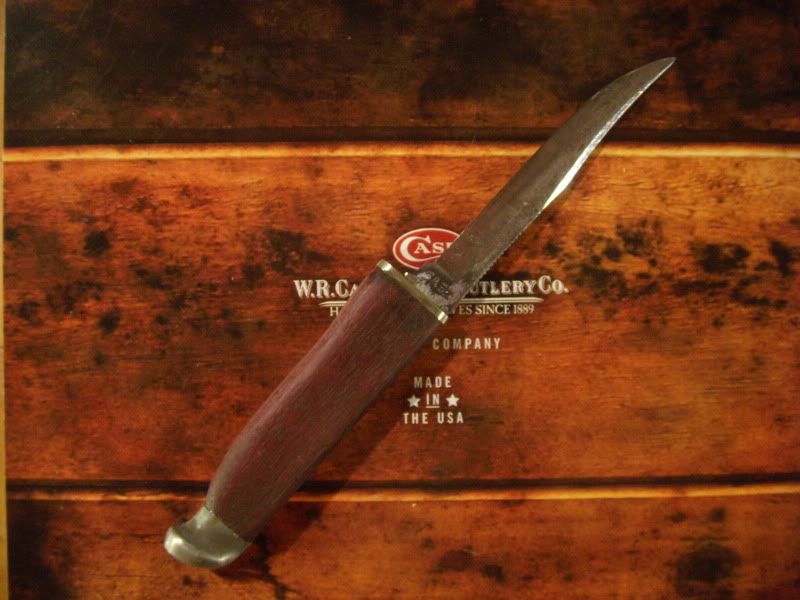

my uncle found an old case fixed blade out in the woods a few years ago, and tossed it in a drawer. he showed it to me about a year ago, and saw that i was interested so he gave it to me. the leather washer handle was rotted and loose, and the blade had some surface rust. i cut away the leather washers and cleaned up the tang. i put on a new handle made from a single peice of purple heart wood, sealed with danish oil. i lightly sanded the blade and sharpened it up. the previous owner had turned the saber hollow grind into a scandi grind, and it cuts quite nicely. very small in the hand though;
