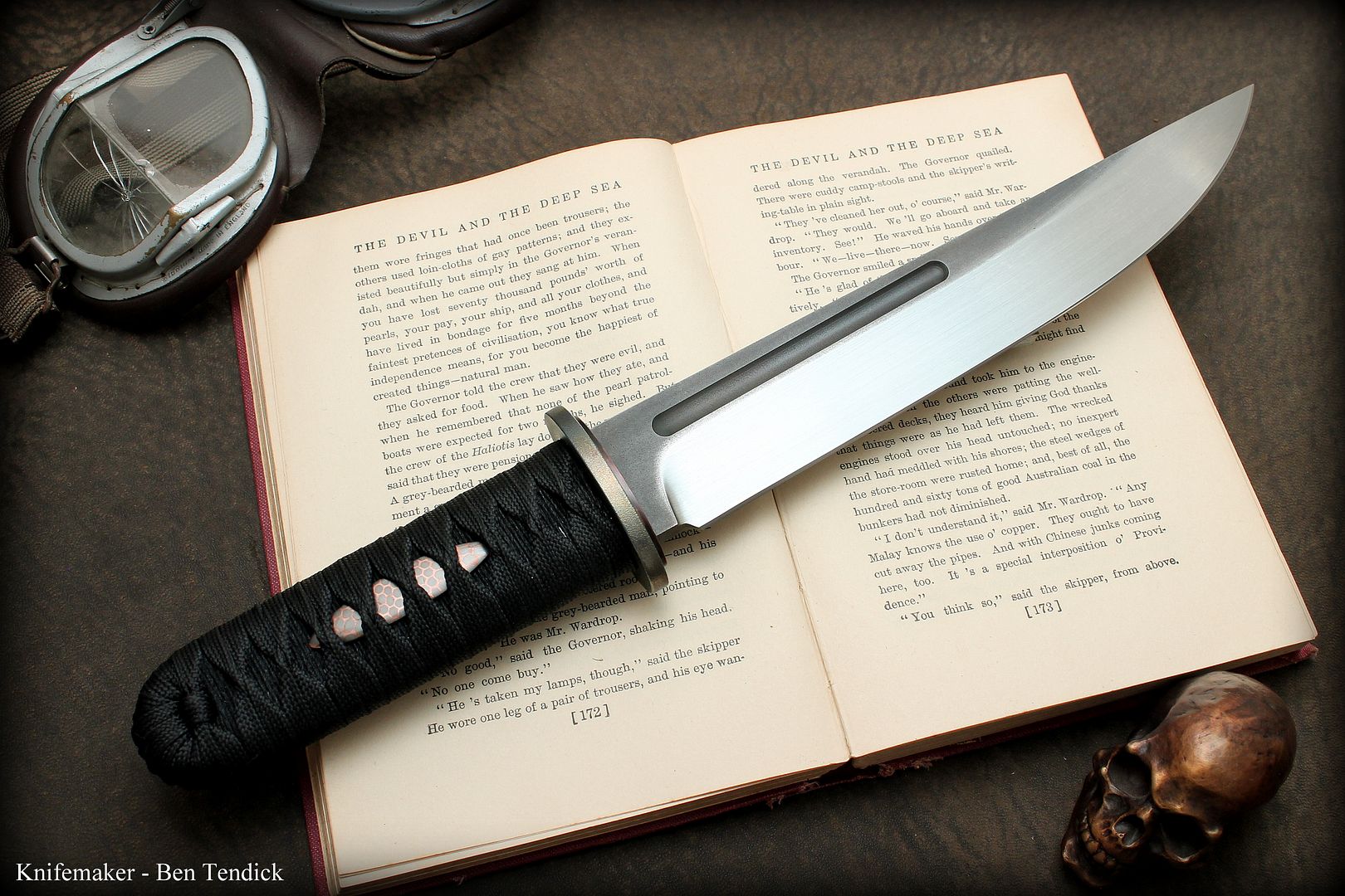

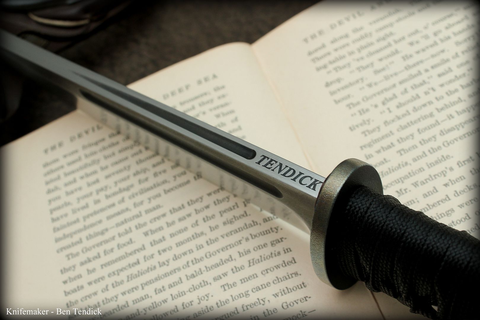

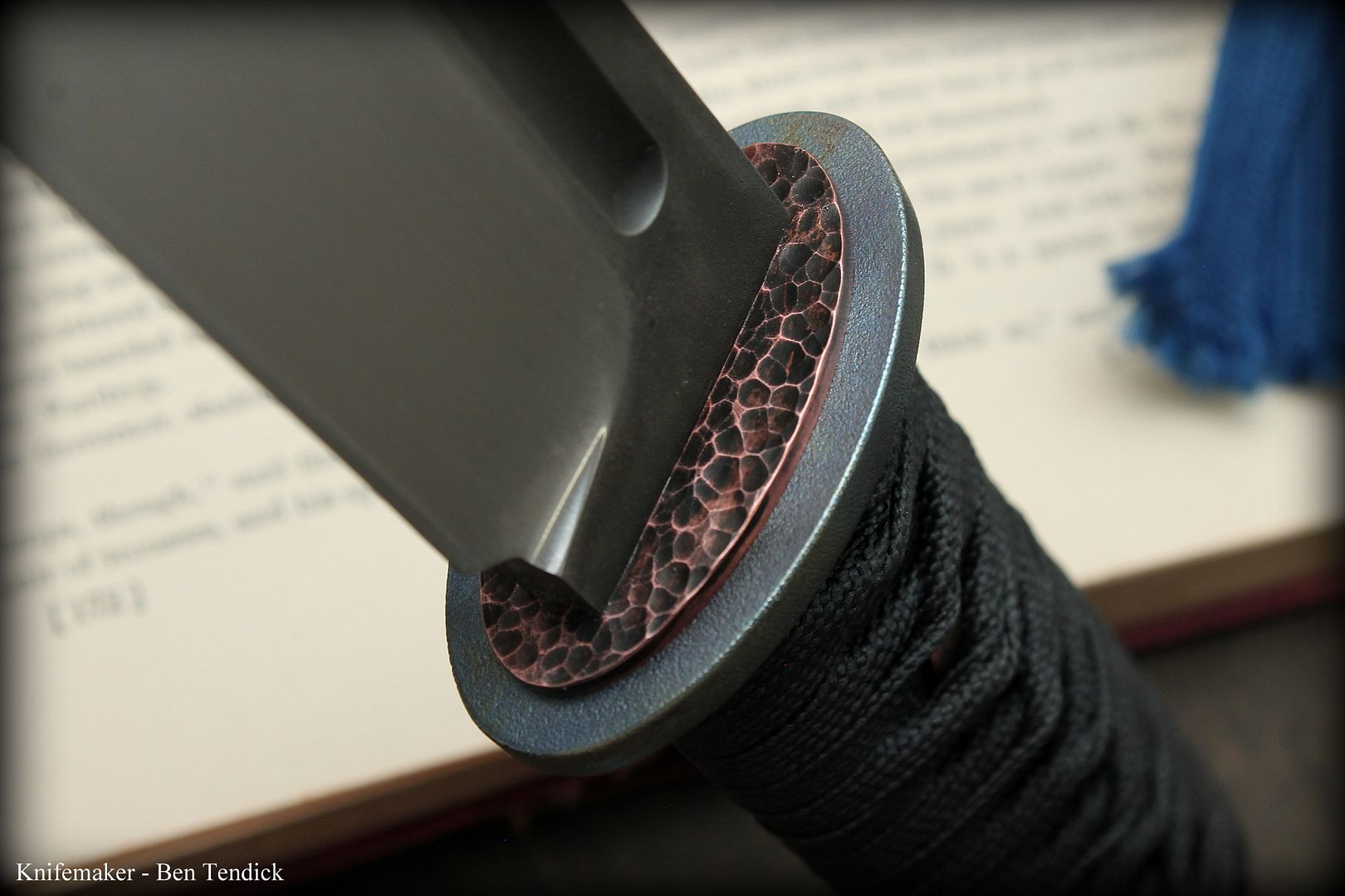

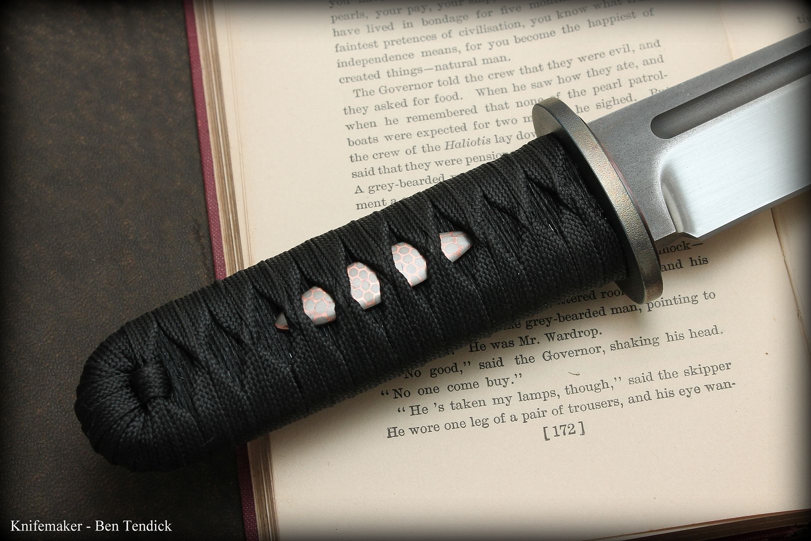

Hey everyone! Been super busy with orders, but I have a small show coming up this weekend and I wanted to bring something cool. This is a pointier version of my AP Tanto. The blade is hand rubbed 3v with a hammered copper spacer and 6al4v Ti Guard. The Menuki are Super conductor in a Diamond shape reminiscent of stingray. The wrap is epoxy soaked and is extremely durable. The underwrap is black hemp cord.
OAL is 14" 3/8" with a 9" blade. It is .275" at the spine.

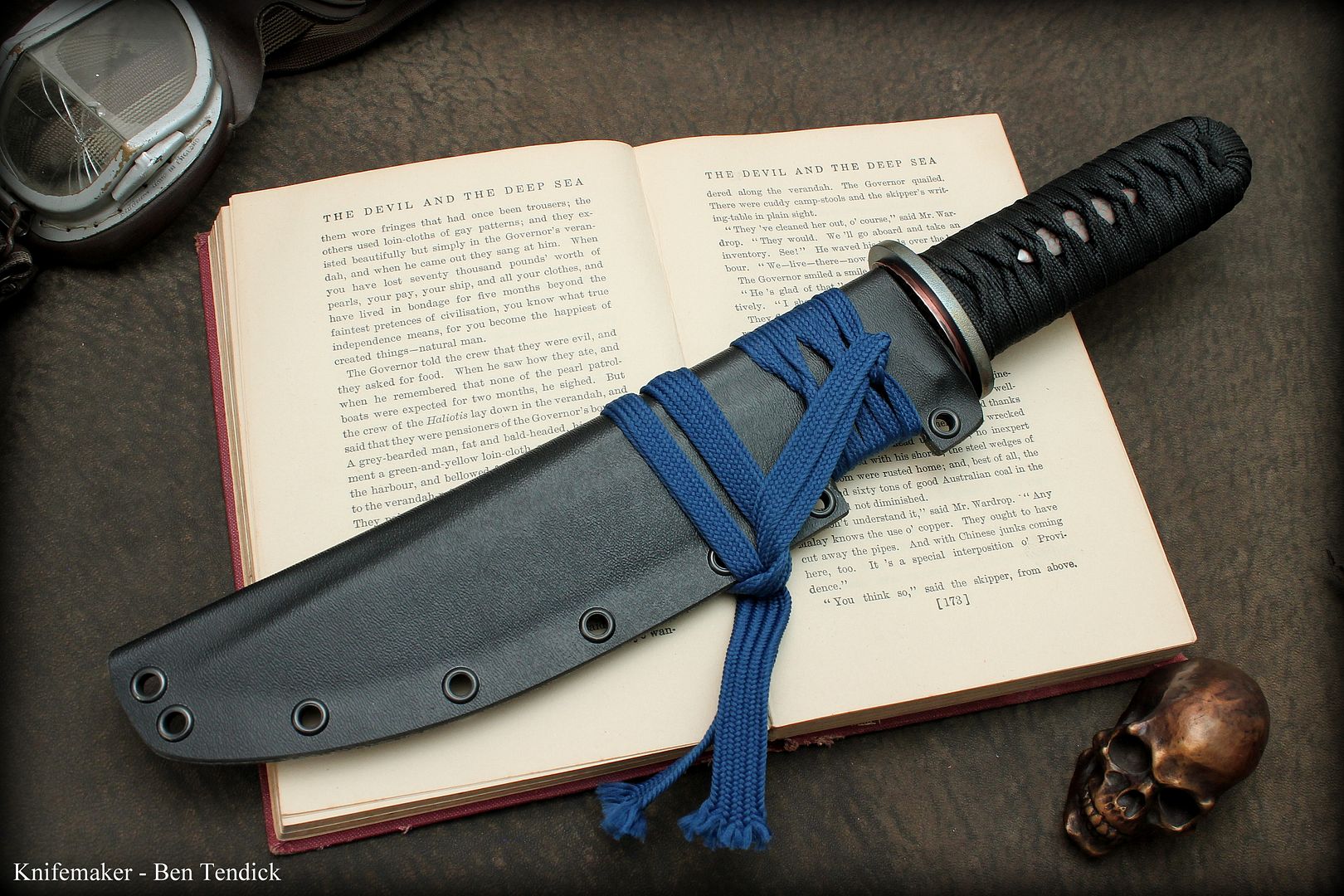

The sheath is a little different. It is made to be worn sash style under your belt, but could be also mounted with a Tek Lok, Molle Lok or horizontal belt loops. It is Kydex lined with synthetic suede and has just the right amount of retention, and draws smoothly.

Damn!
I like it...I like it a lot
It's interesting, and a significant improvement over the last version, imo, Ben.
That is all that anyone can ask.
I particularly like the hammered copper "seppa" and superconductor "menuki".

best Tendick to date imo

Great as always. DO you by any chance have some detail shots of the sheath construction?
-Ivan
It is a basic fold over style, but with a synthetic suede liner.
I love the finishes on everything, tasteful and well done.
What's the thickness? 1/4"?
Jacob
Thanks. It is right around .280" at the spine.
