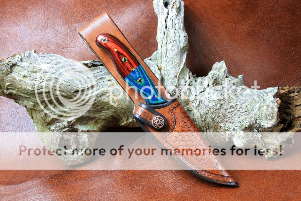

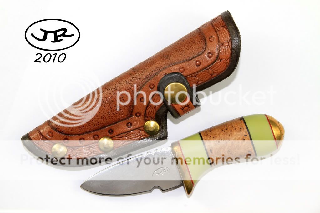

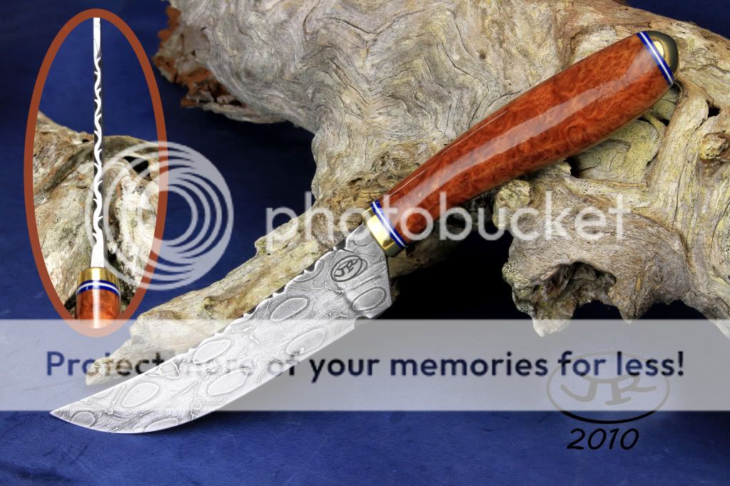

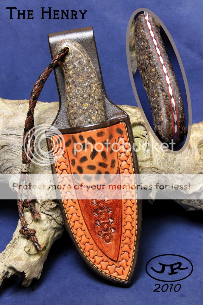

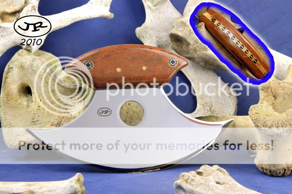

Just for interest I've posted a couple of photos of some of my knives so you can see the sort of things I do.
