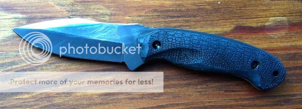

I have been pleased with this Gerber Profile, which feels better to me when modified as in the photo

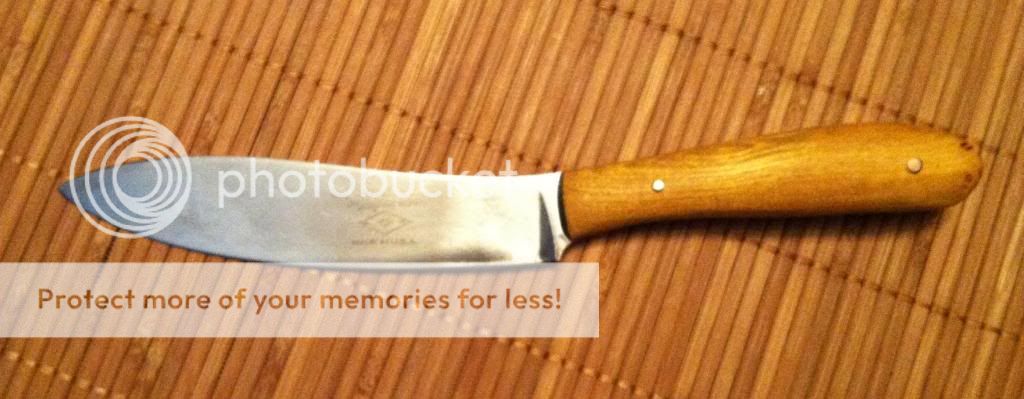

also, this Russell Green River Sheep skinner has excellent 1095 steel, and works great
