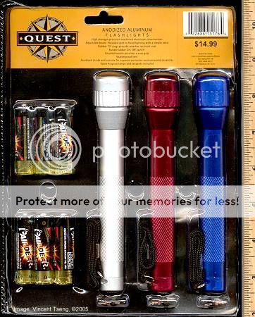

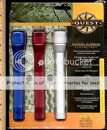

For those who like flashlights or need some inexpensive but quality lights -
I have just bought a pack of 3 of these Quest brand anodized aluminum flashlights from my local Dick's Sporting Goods on Sale for $7.49 per pack.
They are indeed very good value for money and would make fine hosts for the MJLED
- please see:
MJLED drop-in for MiniMag 2AA
They do work well in their own right too - the clickie tail switch is especially welcome. Although the beams are focussable - they can be somewhat variable on quality - I have one that is very good, one that doesn't focus that well, and another that.... (please see later**)

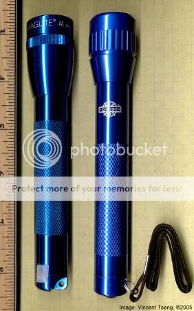

Compared to regular Mini-Mag 2AA

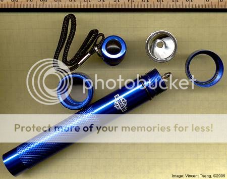

Disassembled -

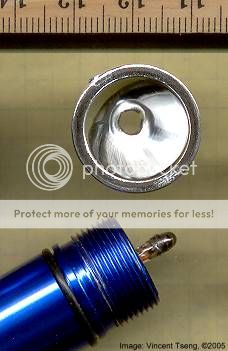

** the more observant of you may have spotted something not quite right......
Indeed the center of that reflector is not round..... no, this not the way it's supposed to be, the other two are round ....
I noticed that this light didn't seem to want to focus and seemed even to be inconsistent in its focussing almost as if the beam was changing.
Once I took the head off I realized why - the bulb must have been in contact with the reflector and was actually melting it! Hence the non-round hole and the burnt looking bulb - that's melted plastic.
Needless to say this is going back for an exchange. The other two lights do work without signs of melting the reflector - and the clickies switches are great.......
At $2.50 each these are really good value for money - I'm sure my faulty one was just an isolated case - but worth bearing in mind that the bulb should not be in contact with the plastic reflector.....
