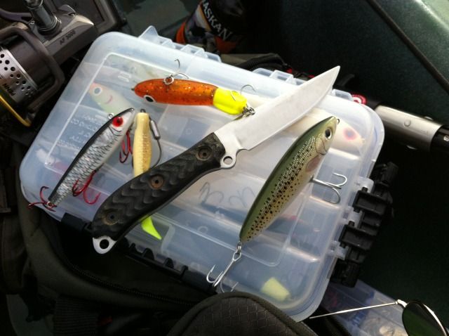

I submerge this one in salt water constantly. Wash it in tap water and it has zero rust issues. I apply a little oil from time to time. Since that pic, I've replaced the carbon steel grip screws with stainless.
Still, Comp and Double Cut are more stain prone because the steel has more little bitty divits that allow water to sit into them. That being said, INFI is FAR more stain resistant than any of the carbon steels. It is more stain resistant than D2 or CPM3V.
