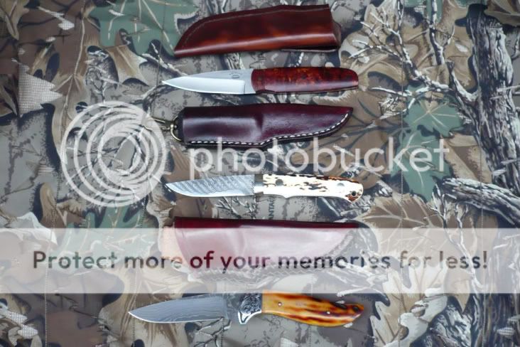

Here is a picture of some of my small blades. The middle knife is an Itou in R2 with a 3.5 inch blade. The bottom one is a Moulton with Devin Thomas damascus blade at 4 inches.
