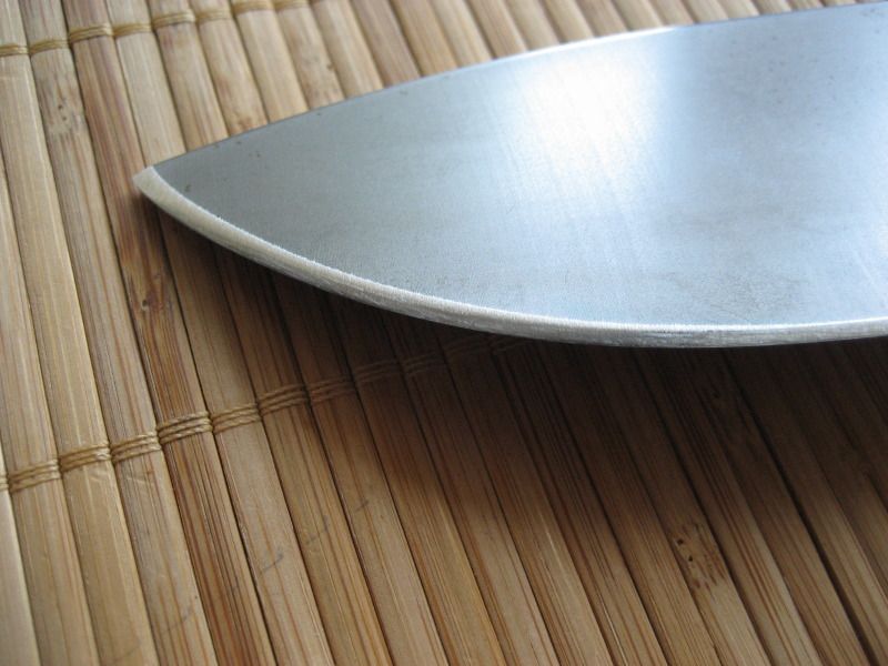

I was in a sharpening mood today and decided to sharpen my HOGFSH. I pulled out my trusty 1x30 belt sander and had a go at INFI for the first time. Sharpening INFI reminded me of sharpening stainless steel in the fact that I hardly had any sparks in contrast to my BK16 were a got a huge shower of sparks. The HOGFSH sharpened up nicely. I started out with an 80 grit belt then moved up to a 120 grit belt. After the belts I used a fine diamond stone to start to remove the burr, I then finished with an Arkansas stone and a leather strop. The edge is now a little more gradual and more symmetrical.
