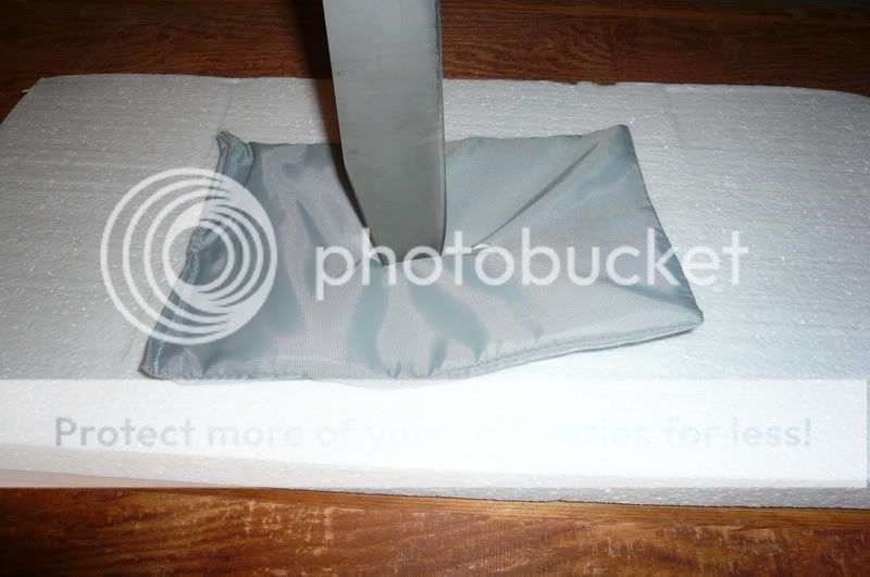

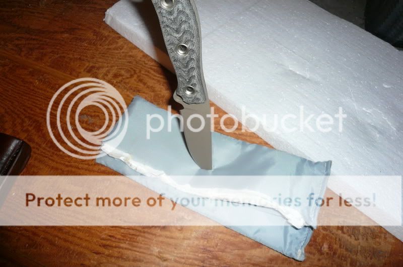

i had an old trauma plate, paul's eu-17, and a new sage meaner. what else could i do???
kevlar being pretty tough stuff, it took a fair amound of force to get a through and through penetration.
the meaner penetrated a little easier, the tip being better shaped for piercing.

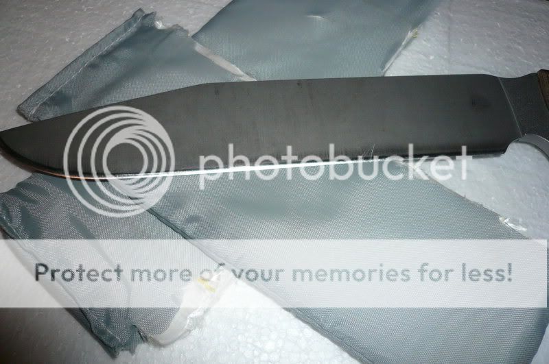

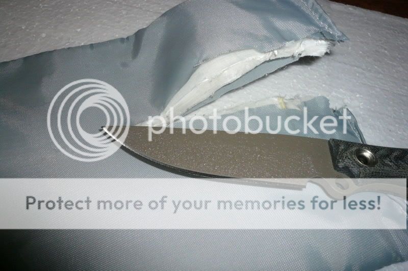

when slicing, it took medium effort to cut through the panel.

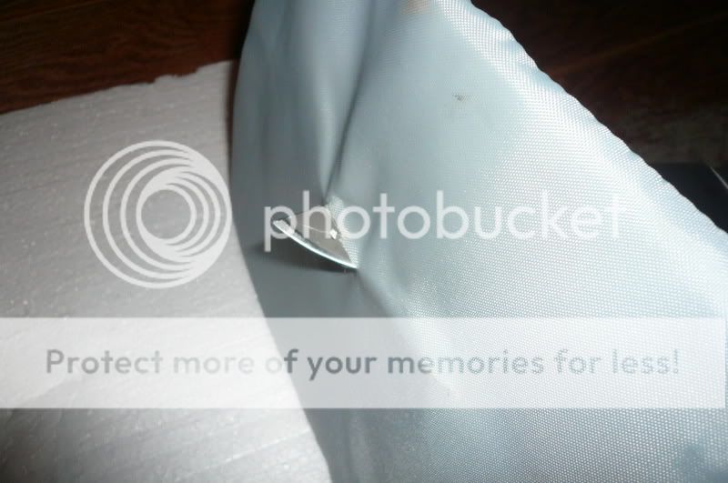

i had to use quite a bit of force to get the meaner to penetrate the two halves. after several stabs, about 1/8" was poking through.
i had always wondered how kevlar would stand up to a knife, but never personally tried. pretty much what i expected, though i have read a sharp blade will cut through kevlar like a hot knife through butter. not so. now i know for sure. i sure am glad i wear a hard trauma plate! enjoy.
and the kevlar definitely took the edge off both knives, though i had expected more "dulling". a quick pass on a steel, and just like new!

though not desinged, necessarily, to prevent puncture by a sharp object, the trauma plate did fairly well. consider the main panels will most likely be thicker than the plate.
also, i was using a hard backing. a stab, or even repeated stabs, unless delivered with significant rapid force, will produce mostly blunt trauma. i would think the body would absorb much of the impact.
the weave seemed to halt much of the force.
a swinging slice would also probably not produce much damage to the kevlar, being that it is many layers of the fabric.
something like an ice pick might produce more damaging results.
Kevlar and other aramid fibers (Spectra etc.) used in ballistic vests aren't designed to resist cutting. I can tell you from first hand experience that it's possible to cut Kevlar webbing with shears.
The character of a good vest comes from the tensile strength of the fibers. The projectile point goes right into the weave, and its energy is transferred into stretching the fibers. Imagine you were poking your finger into a sweater. Eventually your finger will go through, but not before some of your energy has gone into just stretching the yarn. Likewise, the Kevlar fibers absorb the energy by elongating a little. If the vest resists the threat, it's because the projectile's energy was all used up before the weave gave way.
