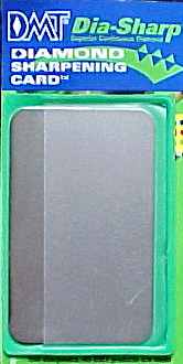

And these:
Credit Card Diamond Plate
These are the size and shape of a credit card (3 1/4" by 2"). They come in several grades. I stock coarse (250 grit), fine (600 grit) and super fine (1200 grit), as well as a two card set with medium (400 grit) and super-fine. I've taken a two card set and glued super fine paper (7 micron) to the back for a strop. This is what I carry with my camp gear. I don't carry the set in my wallet because two plates make the wallet a little heavy. In my wallet, I carry a fine grade (in the shape of the two sided plate above) with the strop on the back. With the plastic sleeve it weighs a bit under 1 1/2 ounces. Made in the USA
A single plate in Coarse, Fine or Extra Fine costs $10,
the two plate set with Medium and Extra Fine costs $20
http://www.ragweedforge.com/SharpeningCatalog.html
I find the diamond plate 1200 is very fast at making the 3V sharp again but scuffs the bevel up a bit more than the stones which if you use both pretty much polish the bevel more than original.
Thakx "hd" ....... these look very useful. I'll have to get them... :thumbup:
Yes....those cards are awesome! :thumbup:
