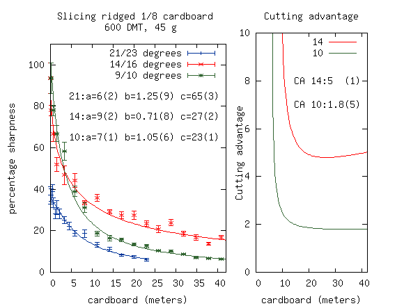

I am posting this here instead of the reviews form as it isn't a review of a knife and secondly because many of the threads here on detailed discussions of such issues include posts which dismiss the arguements as if the level of performance was not significantly different. As an example of the effect of edge optomizion consider the following :
This is work done on a no-name "stainless steel" knife :
http://www.bladeforums.com/forums/showthread.php?t=422935
Background info on the graphs and the numbers :
http://www.physics.mun.ca/~sstamp/knives/model.html

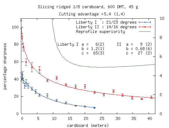

The initial edge was very obtuse at about 21 degrees per side, after reprofiling it was reduced to 14 degrees per side, thus the initial angle was 50% more obtuse. This has a profound effect, producing a cutting advantage of more than five, which is how much more material it can cut before blunting to a given state. Joe Talmadge noted similar many on one behavior with his post on optomizing the Axis some years back.
As an illustration to general use; with the initial profile and sharpened to shaving finish, the knife could slice 3/8" hemp on a 3 cm draw with 20.0 (5) lbs. After the edge adjustment it cut the 3/8" hemp again through 3m with 16.5 (5) lbs after cutting 45 m of 1/8" ridged cardboard. So not only does it have a dramatic increase in initial cutting abilility the increase in edge retention makes an extreme effect on the cutting lifetime.
Note further that this profile is not as of yet optomized for cardboard in either angle or grit. This steel also doesn't have the ideal characteristics for such work and thus the geometry limits will be lower than more suitable steels. However, to clearify, this knife, with this "low end" steel, will dramatically outperform many knives in "superior" steels if the edge profile and grit are more optomized.
The above data is only an average (median) of 4 and 3 runs for the initial and adjusted geometry which is why the data is still a bit noisy and the uncertainty in the fit results a bit large. However it is still very clear that the nature as well as the rate of blunting has changed. I am still not happy with the initial sharpness of the knife so I think it can still be improved.
It no longer has the chunky feeling it did initially, but as of yet I have been unable to get it to shave cleanly above the skin or move it out past an inch on push cutting newsprint. It will do most tests of sharpness like fillet a hair, cut letters off of newsprint, shave smoothly on the skin with no draw, etc. . But it won't pass the really high tests like Landes no-tension hair cutting.
The main issue it removing the burr, it is one of the most demanding steels I have seen. On a curious note, and something which I don't understand fully yet, if you strop on plain leather after honing, the edge blunts quickly and stops shaving. A few passes can clean the edge, but going up to 10 passes per side reduces the sharpness quickly. It would seem odd for this to be an abrasive effect, as it continues to shave after about 40 cuts through the cardboard.
The cutting average calculated in the above was an average from 15-40 of the intersect function. Below 15 m the function basically has a veritical asymptote because the stock blade didn't reach that level of sharpness and the adjusted blade takes about that long before it is cuts the same as the stock blade when fresh.
