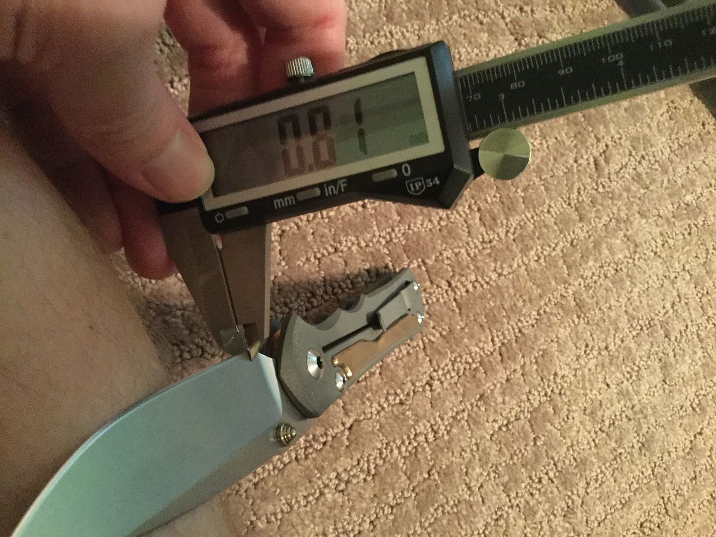

For Inkosi owners, could you please "mike" the blade thickness at the shoulder(just behind the last bevel).

Large or small? If you are looking large, here is a couple of pics:
If this is not the area of the blade you were talking about let me know and I will take another when I get a chance.
The Small Insingo is a better slicer in my experience, but the Large Inkosi is no slouch. It's thicker, and more robust. They compliment each other well.
The "small" measured at the same locations as the "large" above are 3.24mm and .71mm respectively.

For the Small:
Thank you, good info.
I hoped for .020" to .022", but ok. I do like stout small knives.

For the Small:
In order to buy a knife with a grind that thin behind the edge you are going to have to likely look at traditionals with thin blade stock. Stout knives have their place, and the Inkosi is a great one!
