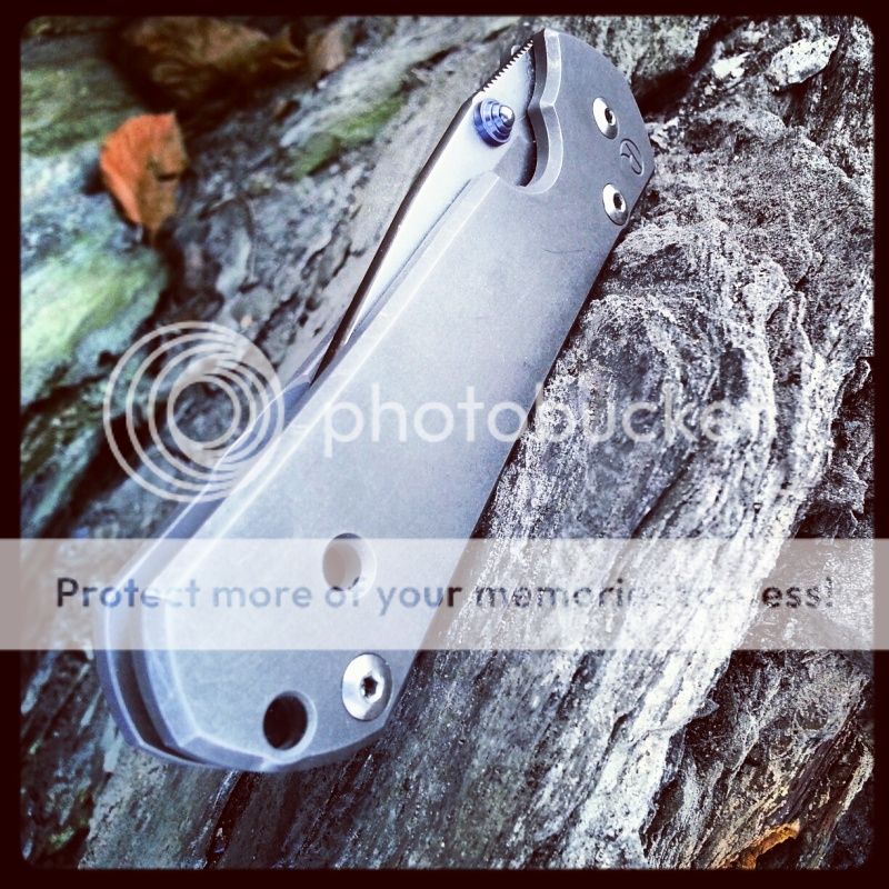

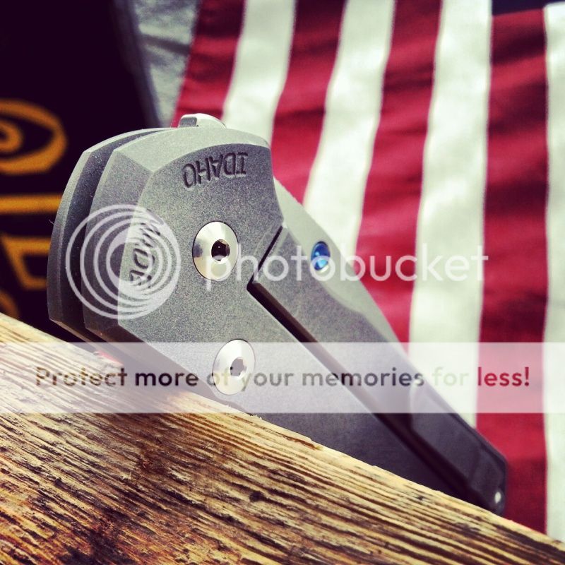

This is a question I'm sure has been covered but after searching I still can't find an answer. What I have found are some assumptions and hearsay type answers and though they may be accurate I can't find a definitive consensus. So I've come here.

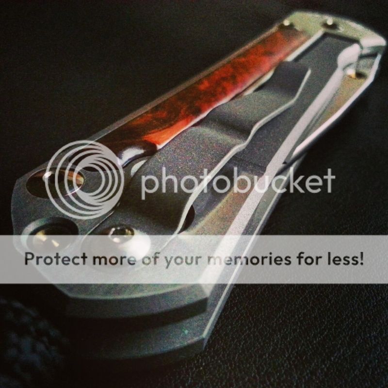

On an inlayed Sebenza why has the lock bar and pocket clip bead blasted versus the rest of the satin finish? From a "look" standpoint, I love it. It's a subtle contrast that just rings a bell for me but is there a manufacturing reason which I have read? Or is it a design feature for traction and wear which I've also read? Can it be just aesthetics which I like? Thanks in advance for any input...
and your pics for views. ;)

The scales are blasted as part of the finishing process, I don't think it has anything to do with "grip" but it doesn't hurt I suppose. The inlayed and most UG scales are then hand sanded to a 600 finish. As mentioned, the lock bar has already been sprung at this stage so it doesn't sit flat when the sanding is done. You will also notice two milled grooves under the clip at the transition point to keep it clean and give it that designed look. :):thumbup:
