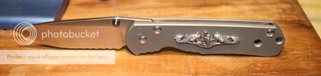

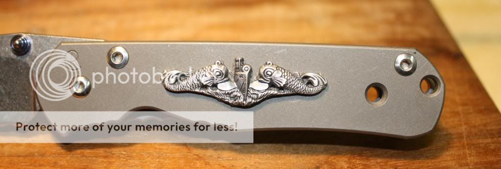

I used the 3M VHB tape to mount my dolphins on my small seb. I have carried it for over a year everyday and the dolphins have not moved even when many people have pushed on them. Yes I asked my friends to push on them to test the tape.
