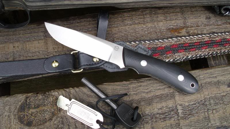

The Blackjack 125 (5.5" blade) has a substantial handle. They are made in A2 steel and by Bark River for Blackjack. I have one of these and like it. It in fact is the knife that I take in the woods if I want a larger knife, but not too large. I don't do much batonning.
For me it is right at the edge of being too large for hunting. The chroil (slot in front of handle unsharpened) allows you to choke up on the blade for detailed tasks.

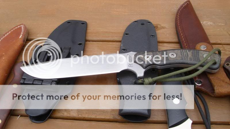

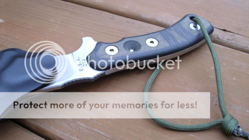

Koster Bushmaster in 3V. 5 inch blade, canvas micarta, V grind, very tough .200ish thick blade but it does slice. It can do big stuff too. Around $230 or so.
This knife REALY caught my eye. It is a very good looking knife to my eye and I do bet a super functional knife. I actually think the smaller bushcraft knife is great too. I had really been thinking that I should only go stainless but 3V sounds so darn good for a knife like this.
