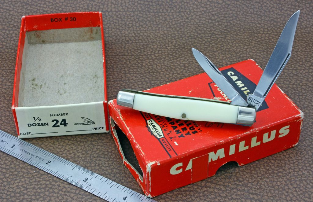

I came across a 314 Trapper with a 1990 date code but can't find it in any catalogs 3 years either side of 1990. Any have some info on the knife. The box it came in is incorrect. It's for a much later (and imported) knife. It also has a brass rivet.
It looks like the 314 Trapper was new in 1991. I guess it's possible that production started in 1990, hence the date code.
Does anyone know if these were made by Buck or were they still part of the Camillus contract?
The 314 was produced by Buck from 1990 until 1998. It was made by Buck and was not a Camillus contract knife.

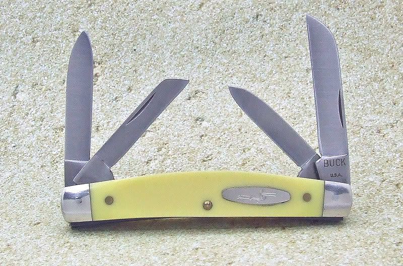

Another example of the Buck catalogs not being the "Holy Grail of dating" as you say, is the yellow Delrin handled 300's. I have never seen them in any dealer catalog, yet they do exist.

Matthew, You never saw them because they were never there.
Buck was friendly with Smokey Mountain Knife Works, in the 90's and even early 2000's, several models were exclusively and directly contracted between SMKWs and Camillus with license to allow BUCK stamping on tangs via Buck. These models were never date or model stamped, EXCEPT for your Model 329 smooth yellow two blade trapper. All they show on the tang is BUCK, (blank space), U.S.A.. From my memory, this includes a couple of 'California Toothpicks', David Martins large folder models, two Congress models and maybe one or two others.
These were never in a Buck catalog and were sold exclusively by SMKWs. About this same time other SMKWs specials were Camillus made but marked with a model number. They were Buck 300s with special blade printing and special named. The 317 came in about three versions and I have a 307 with all three blades inked. So, at the end of the Camillus/Buck contract you will see knives with no model numbers and some with special marked blades never sold from the Buck factory. Makes it sort of confusing ......300
