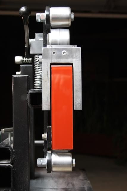

Here are a couple of YouTube vids I made going over ceramic glass platens and how to install them.
I also go over some basic information as well as safety considerations and what not.

Also note that double sided tape of any kind will inherently be weaker than any type of epoxy, or several other adhesive options. This was intentional for my application, but it is recommended that a stronger adhesive be used if you wish to decrease the chances that the glass become loose through use.
Are you not worried about the heat build up loosening the glue on the tape? I ordered my platen last week for my grinder build and ma just curious about that. I had intended to mount mine the same way a Tracey suggests on his site.
I've used the 3M exterior mounting tape for years on my platens.
I've had the misfortune to accidentally break a platen or two and cuss and mumble each time, because to remove the old platen is quite a task!
The key component is the ledge - not the adhesive.
I used JB Weld on mine. Has been on for two years no problems.
It's a mild concern, and I definitely recommend for anyone else to use a much stronger adhesive if it makes you that much more comfortable. That being said, I've heard of as many (or more) failures using epoxy as I have with tape.
I do plan to check the "hold" of the tape everytime I use the platen, and so far it has shown no indication of loosening, after some relatively heavy grinding across the face of the whole platen, using belts of varying grit and weight.
That being said, the main holding power comes as much from the "ledge" as it does the tape or epoxy.

Put a ledge on whatever adhesive you use.
I tried the JB weld and it showed signs of letting go the first time I heated it up with a belt. I know others like it and use it but I don't.
At least it did not take much from a mapp torch to get the glass off and start over.
I went to high temp red rtv silicone gasket sealer. Almost fool-proof assembly, easy to clean up after it dries, you do not need to scratch the glass for adhesion, and it works flawlessly. Looks cool, too.
