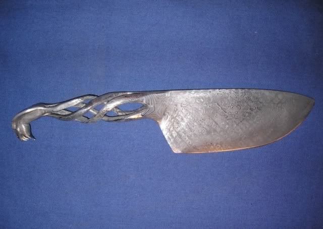

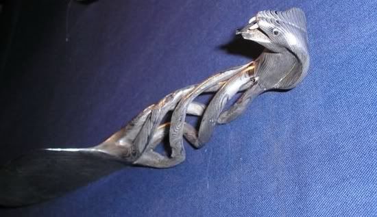

Hi to all,
This is a piece I did some time ago, but never got to show it here.
It's an around 100 layers damascus piece (1085+1010) , the cobra head was made from de same material but silver welded later to the handle.
Each handle arm has a twisted pattern, and the handle and the blade are the same integral piece.
The cobra head was all carved with angle grinder, dremel and hand filied. The teeth were also hand carved, from deer horn, and the black eyes are antelope horn.
The blade has a quilt pattern, length 6".
OAL length: 10,5"
Tell me what you think...
