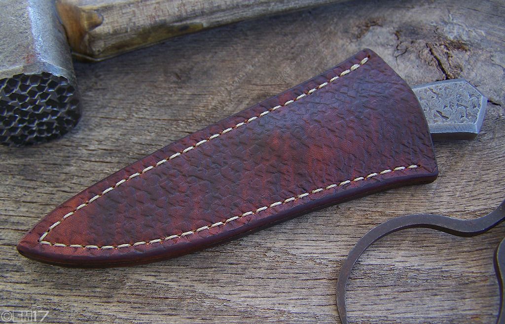

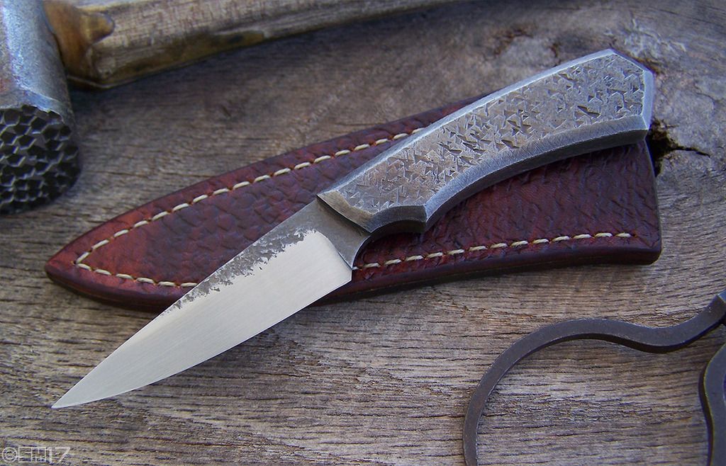

I've been playing with this concept for a few years, and this is the latest product of my playing.
The handles have been forge welded on to make the knife one solid piece of 1084.
I textured the flats on the handle with one of my texturing hammers, and I used the same hammer to pattern the leather.
I also textured the spine and bevels of the knife with a file to tie everything together.
• 5 1/2" OAL
• 2 3/8" blade
• 3/32" at the spine
• 3/8" thick handle
Thanks for looking.
I really like the lines on this one, Shelby. Your eye for form and texture never disappoints.

Nice handy little knife.

Interesting idea.
How heavy is it, and how is the weight distribution? Is the tang tapered or are there any hollows in the handle for weight reduction?
