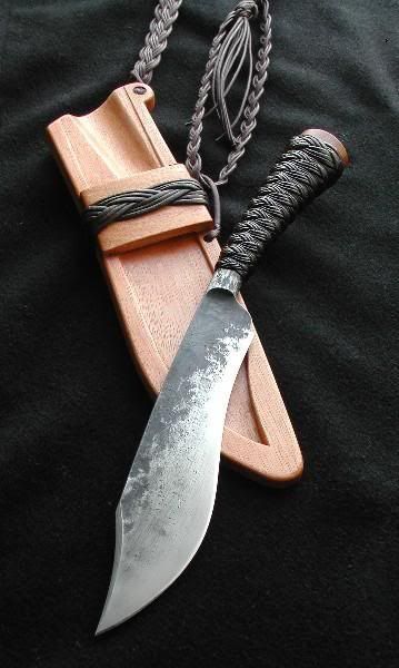

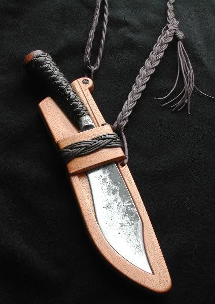

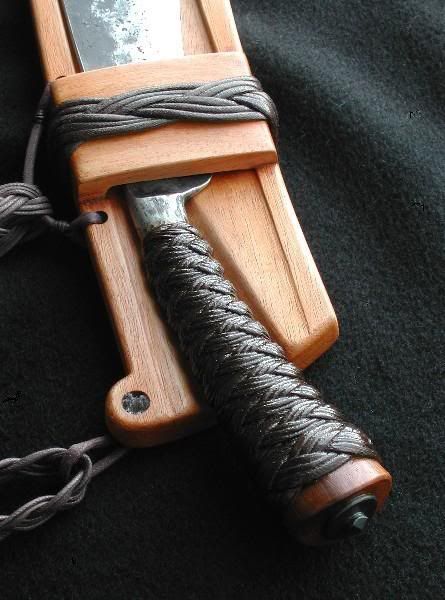

It holds it very snug with a friction fit from the bridge which works in conjunction with the distal taper of the blade. No chattering or moving around,... won't fall out upside down if seated properly either.
The really nice things about the open faced hikot type scabbards are that they drain water, are easy to clean out, and show the blade.
