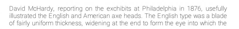

I feel this source as well as several others highlights the evolution and issue with some axes. This writing is from the Australian perspective but comes to the same conclusion reached by Cornwallis in America. So many points to be made with the Cornwallis letter.......
Not only were the American axes Superior but one comes to the conclusion the Massachusetts men themselves that he hired were Superior workers as well. Perhaps it was tool and technique, perhaps it was more.
In this writing it becomes clear it was a multitude of issues. Axes were sourced from multiple places, England, Germany and they were inferior. Not only in one manner or another but in ALL aspects. The geometry was all wrong for the Felling job. The handles were horrible. We have documentation of the axes twisting in the work. And of course inferior manufacturing and specifically poor heat treat that caused headaches on harder timber.
The handle is no small matter but it clearly can be felt in this writing that it was FAR Superior and a huge advantage.
The quite simple and to the point description of both types of axes and how they are used also highlights the superiority of the American Felling ax. More important it does so in a way that non ax users should be able to understand. It pulls back the sheet so to speak for the non experienced ax user. The American ax is "thrown" in an arc utilizing the heft of the head and releases easy due to cheek shape. The other has to be used in a "chopping manner". As expected. It lacks the weight to do the work. It lacks the geometry for release so over Penetration is a real issue. That is kind of a kick in the butt for those arguing for them as a bucking Felling alternative, light weight, Penetration and removability of the handle are the modern selling points of these axes. Yet they are also the exact things that make them a poor choice for Felling and bucking. It really is not opinion, it is fact.
Another interesting point is on the dimensions reached by competitors and manufacturers on dimensions. As one views the overall shape and perhaps more of the "general ideas/dimensions" of the agreed ax it seems to me that a couple of patterns come very close to the spirit of the description. Just interesting.
I think it can be shown quite conclusively that when it comes to Felling and bucking the American Felling ax is far superior to all others. I will extend the nod to the Australian/New Zealand ers as they have a sibling ax that is obviously a child of the American Felling ax and experience on local woods.
