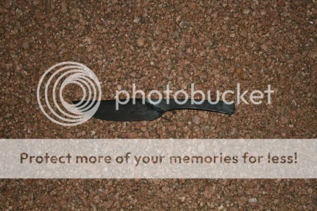

Here's what the Bowie looked like. We turned a missed hammer stroke into a notch for his thumb, and he was very pleased with the result. We established the secondary bevel on my belt grinder before he left, and he will clean off the baked-on oil, wrap the handle, and sharpen it back in L.A. This thing is a working knife, and balanced a bit ahead of the blade/tang transition. It'll chop, but it'll fight well too. Max knows how to handle a blade, and I'd hate to be on the other end in a fight.
I didn't get to measure the blade before he left, but it was approximately as long as the one I made to demonstrate, which is 12" overall with a 7" blade.
Before he left, Max wrote a check for the Ridiculously Large Bowie. I'll finish it up and mail it his way. It's forged from 1/4" thick 1084 bar 1 1/2" wide, and ended up 14 1/4" overall with a blade 8 1/2" long by 2 1/4" wide. The demonstration Bowie, by way of comparison, has a blade 1 3/4" wide.
