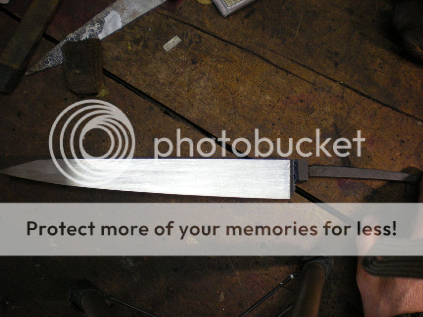

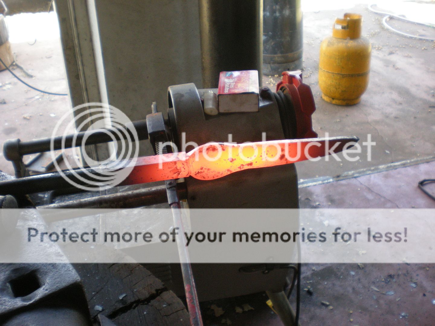

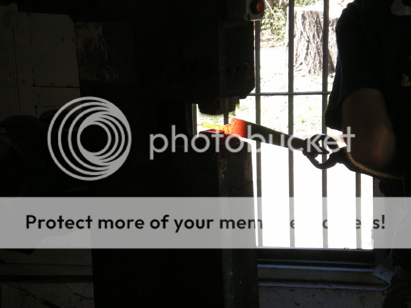

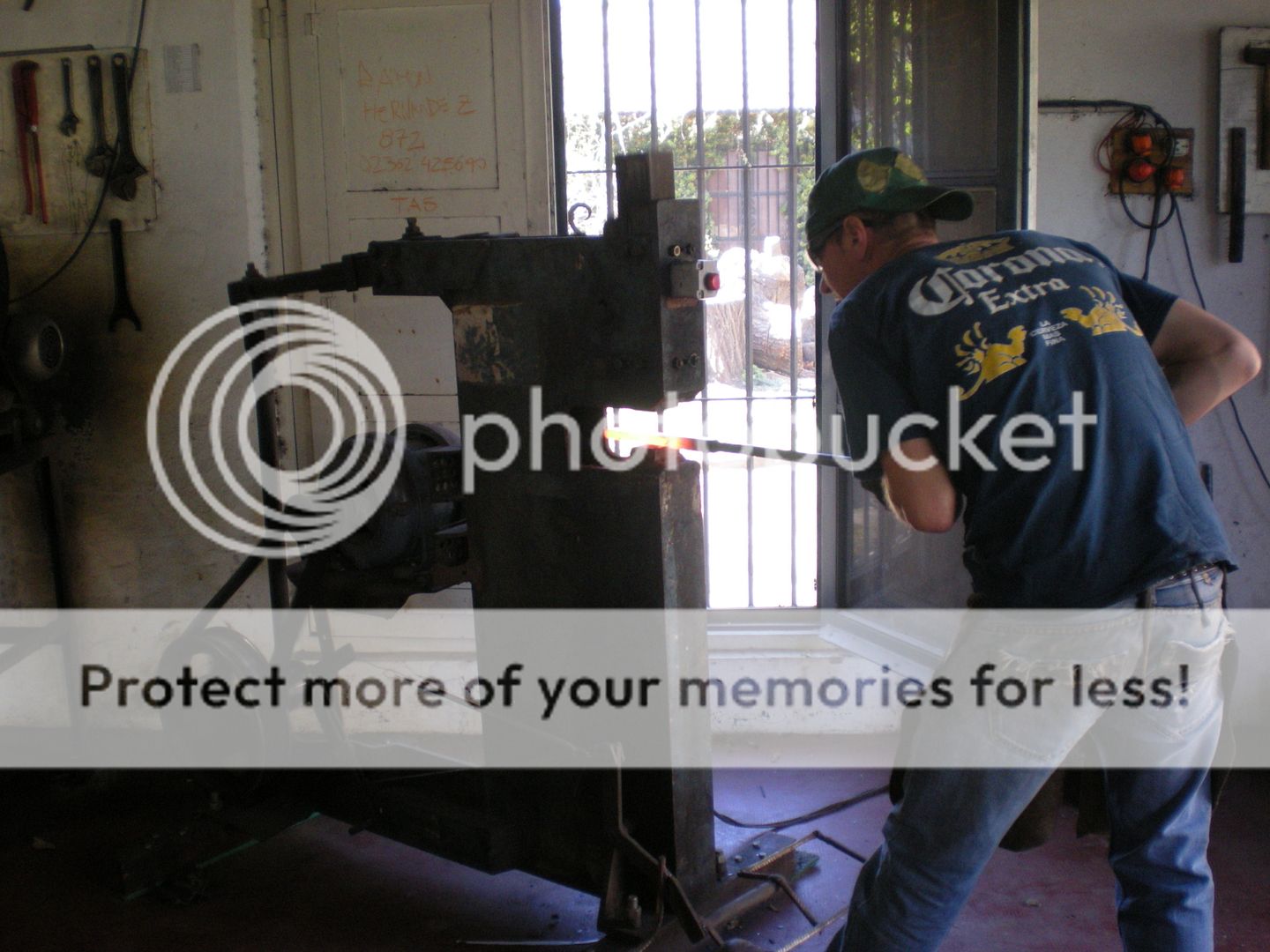

Hello everyone

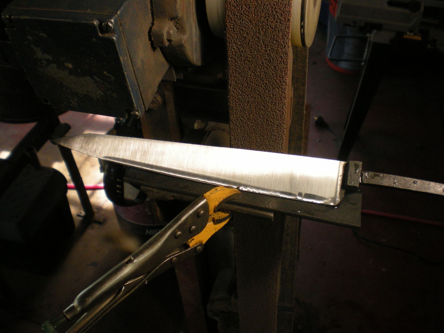

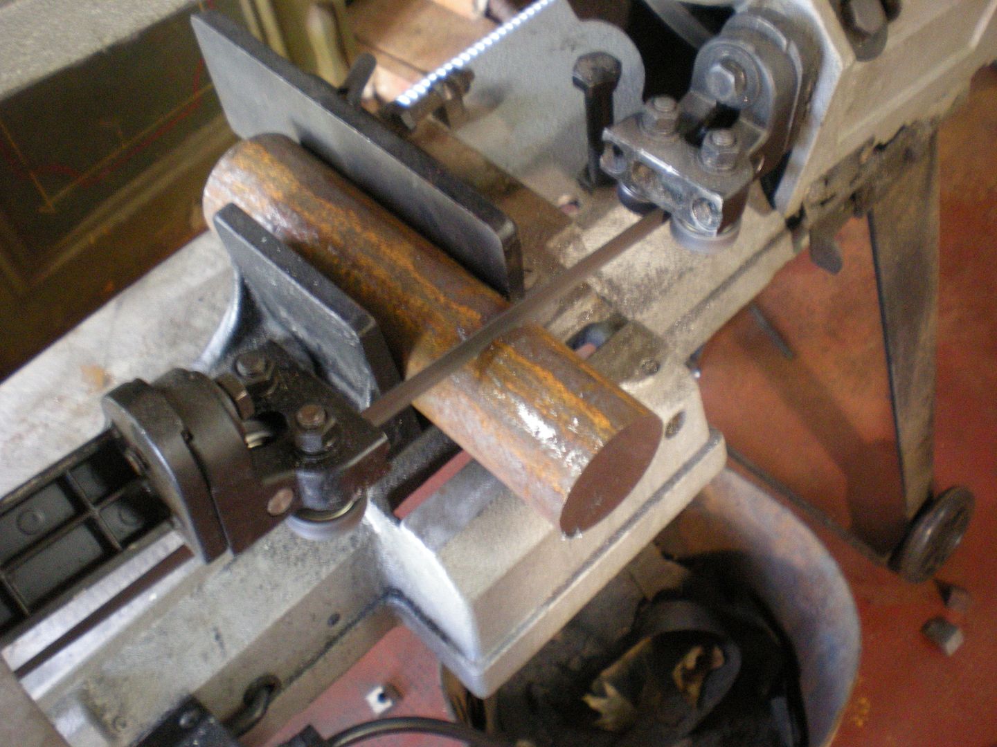

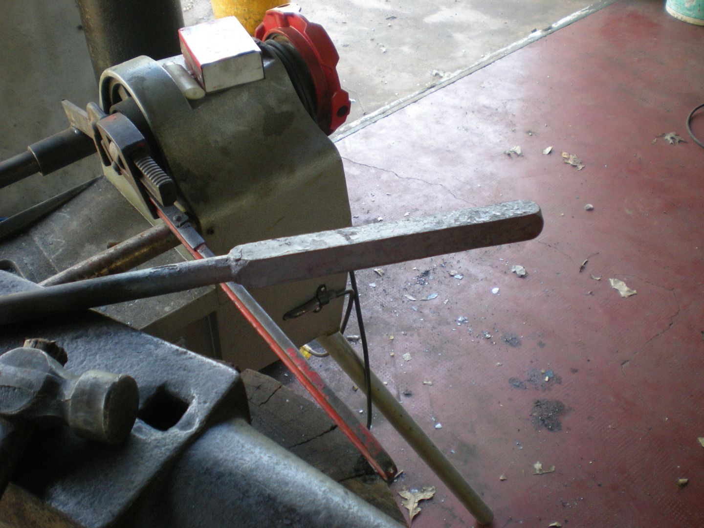

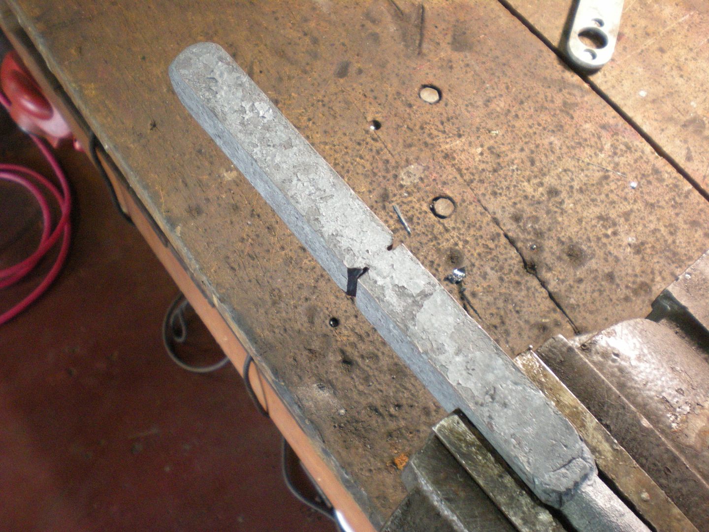

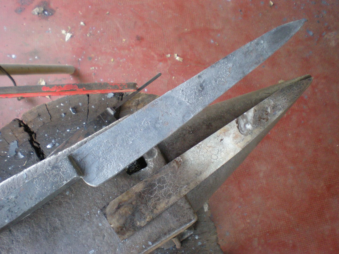

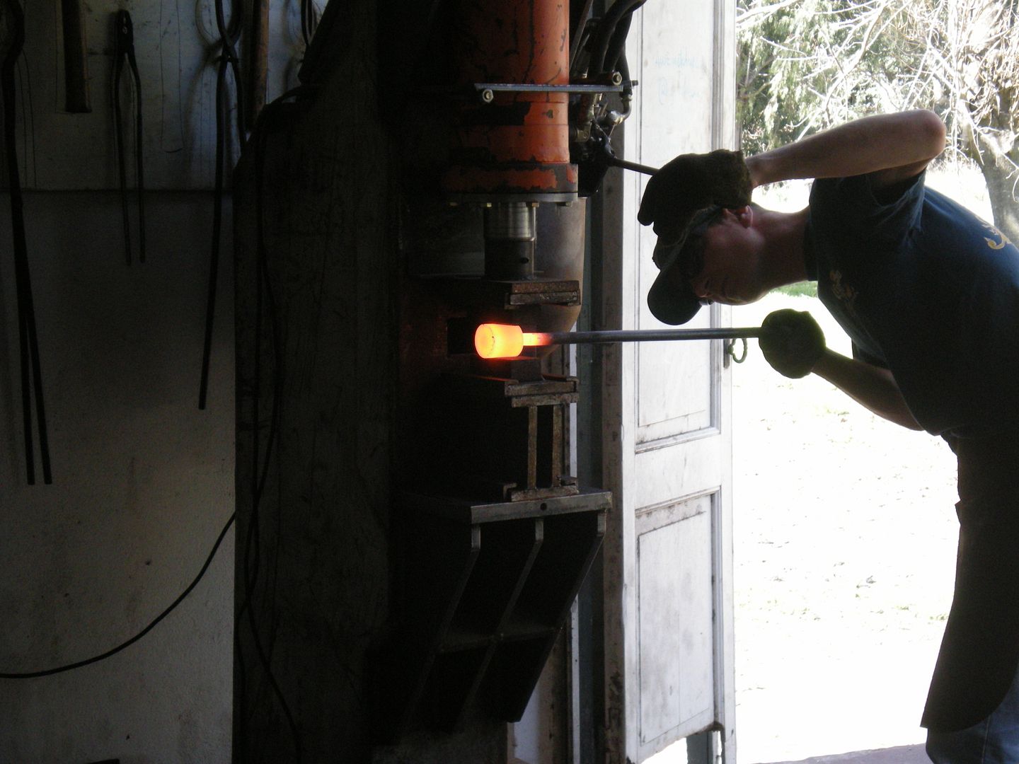

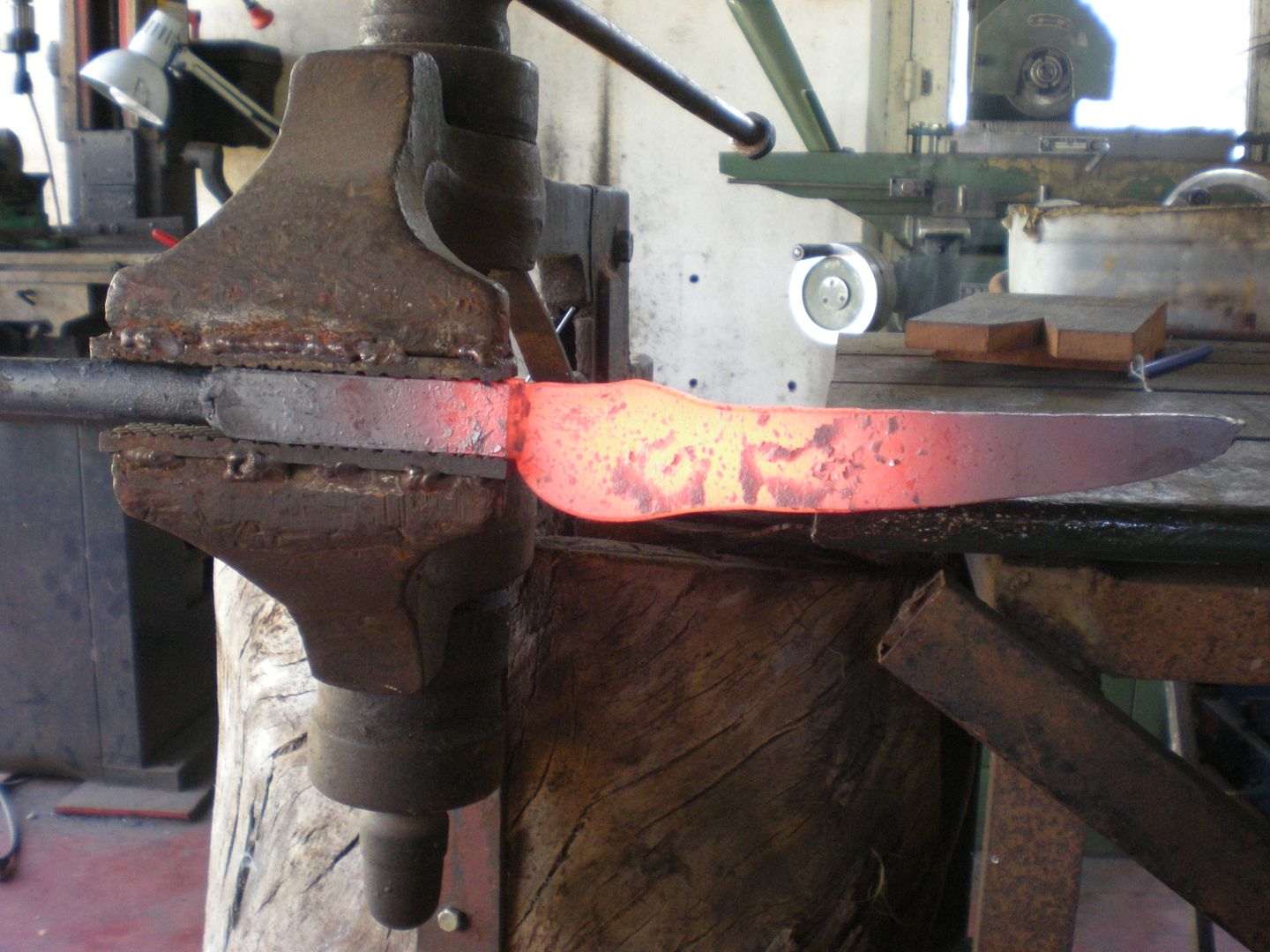

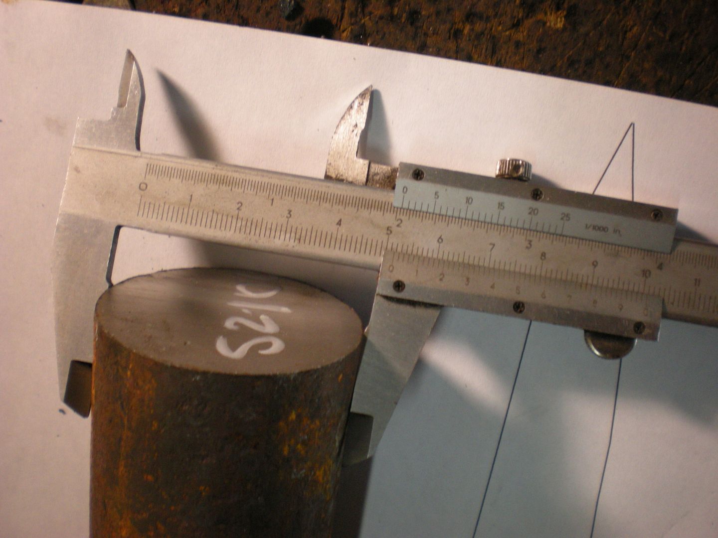

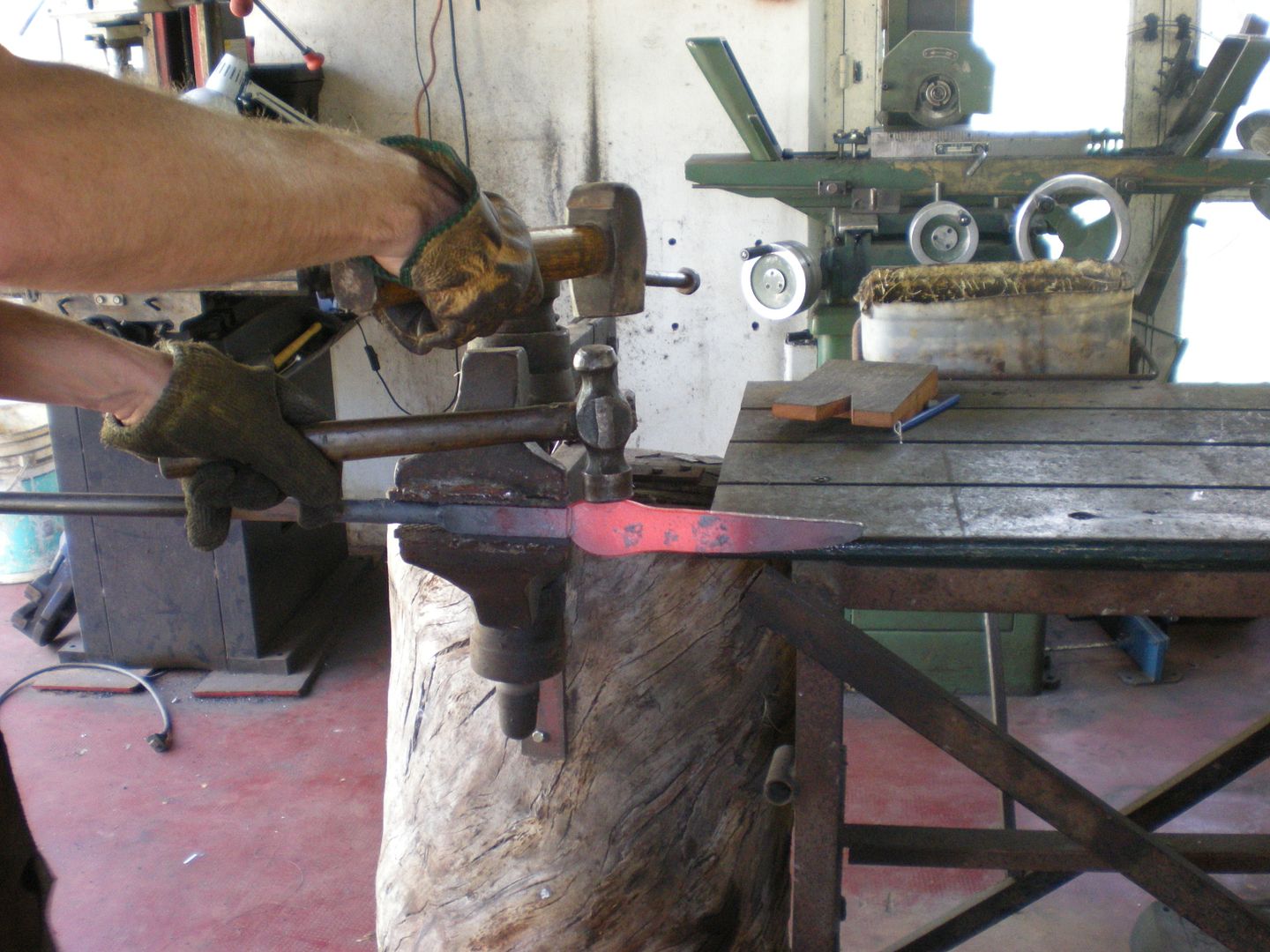

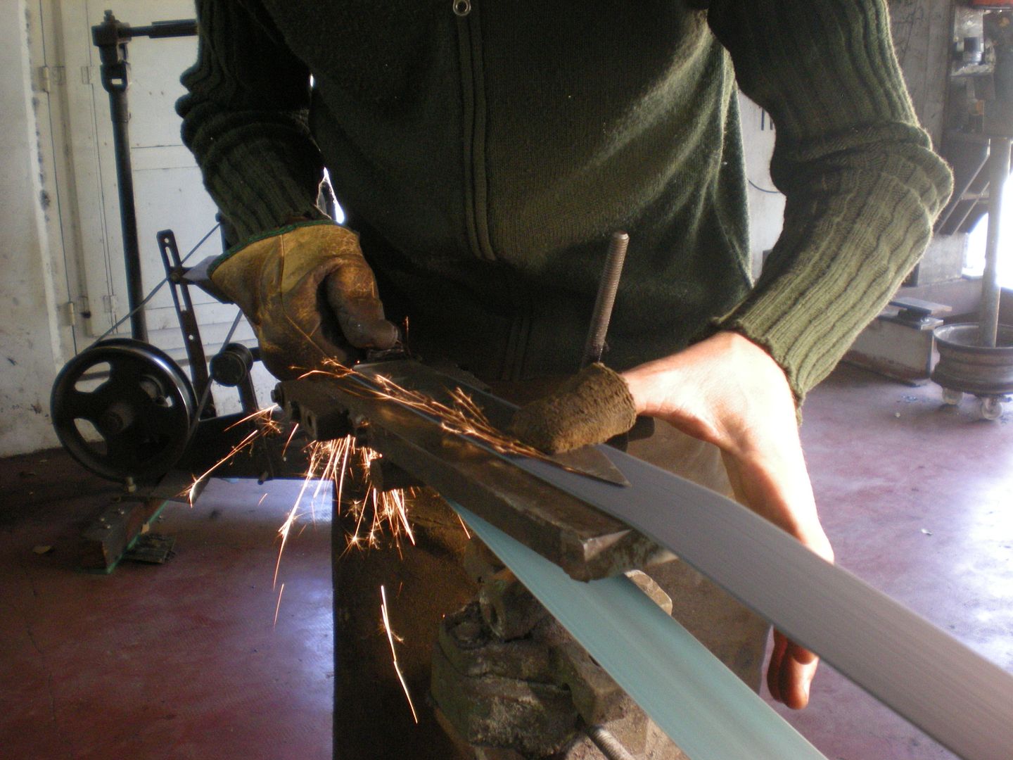

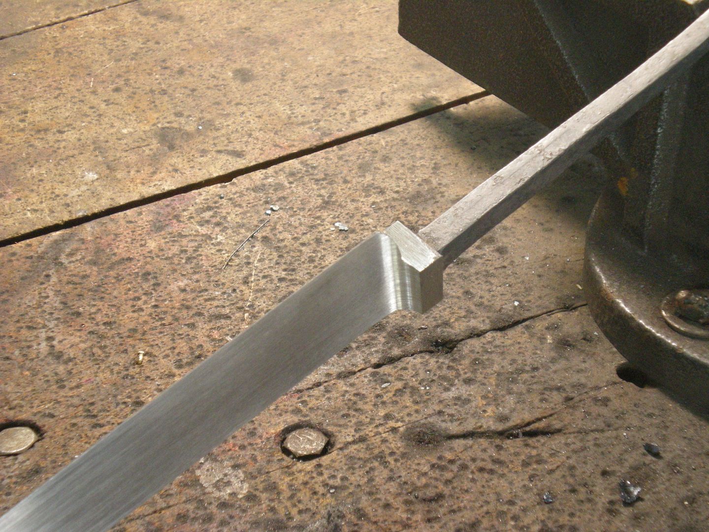

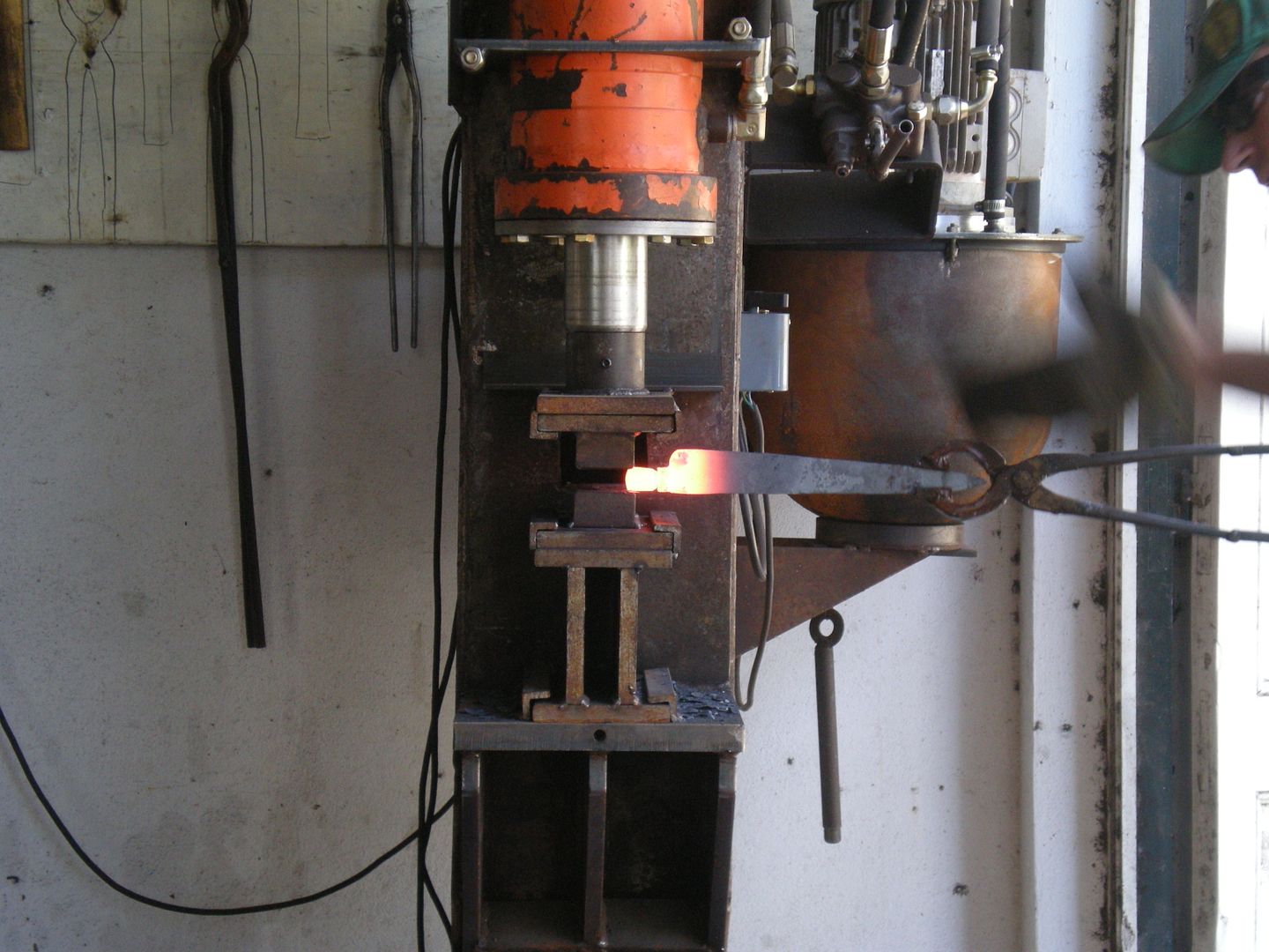

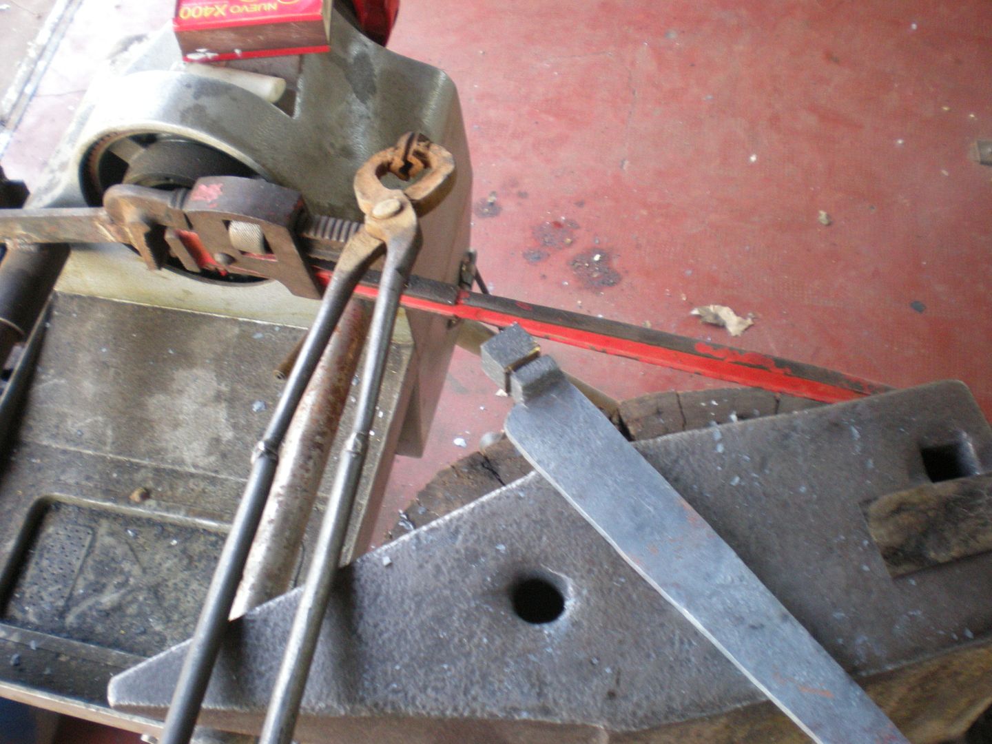

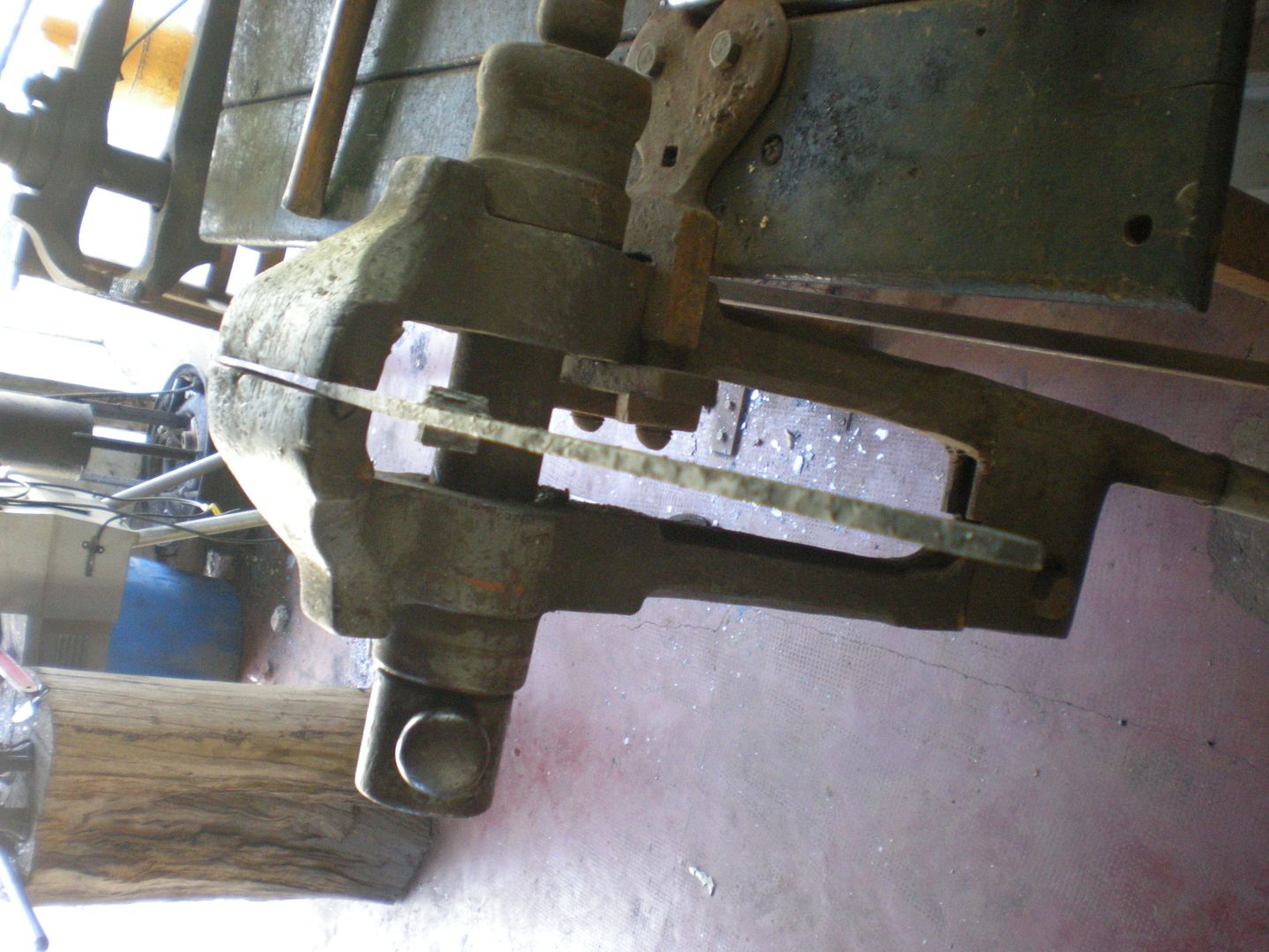

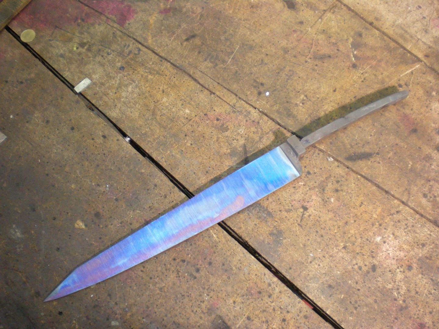

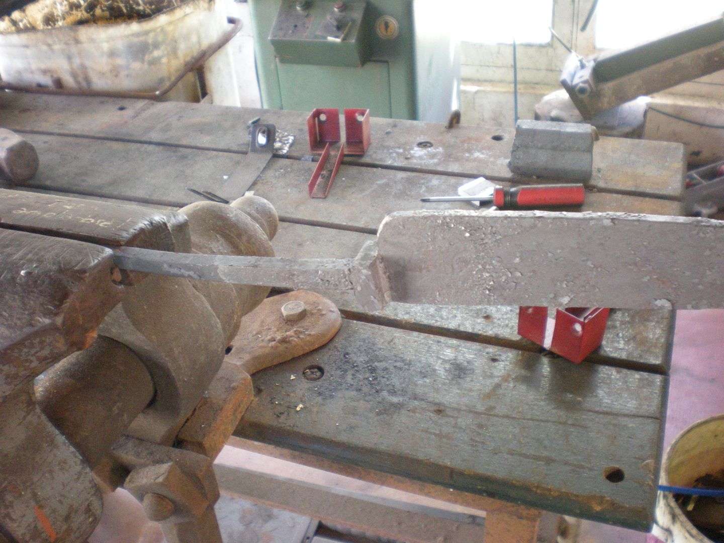

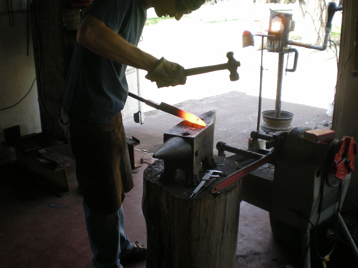

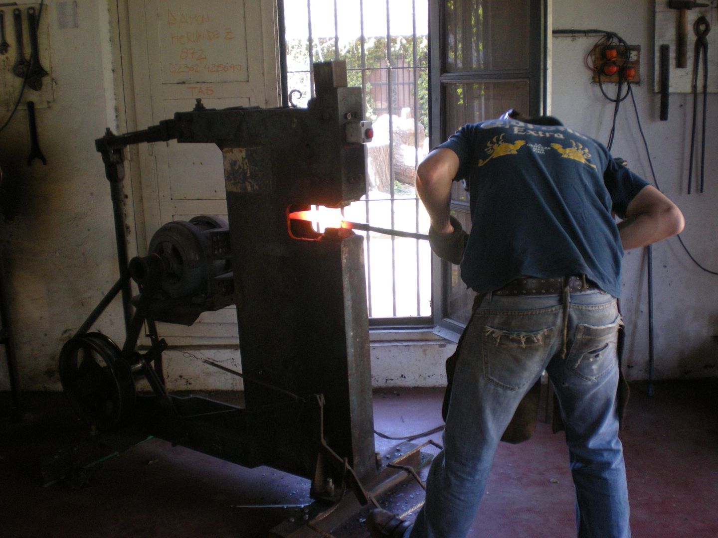

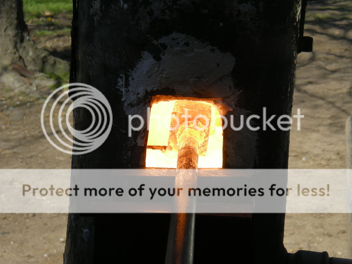

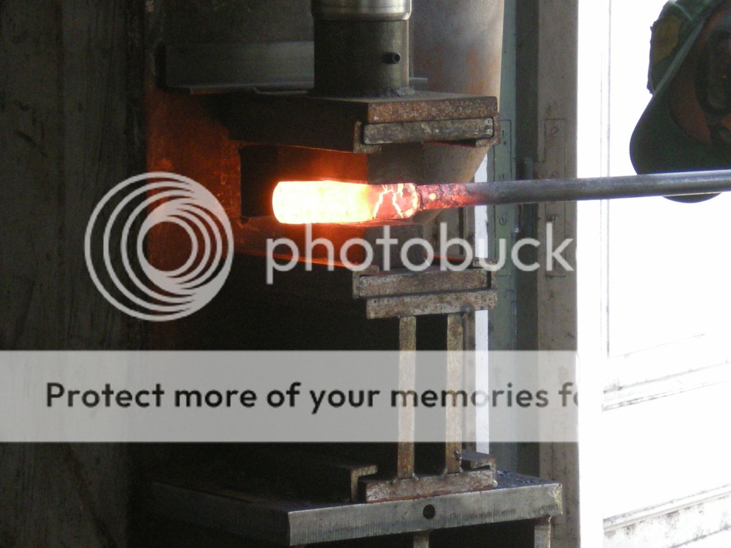

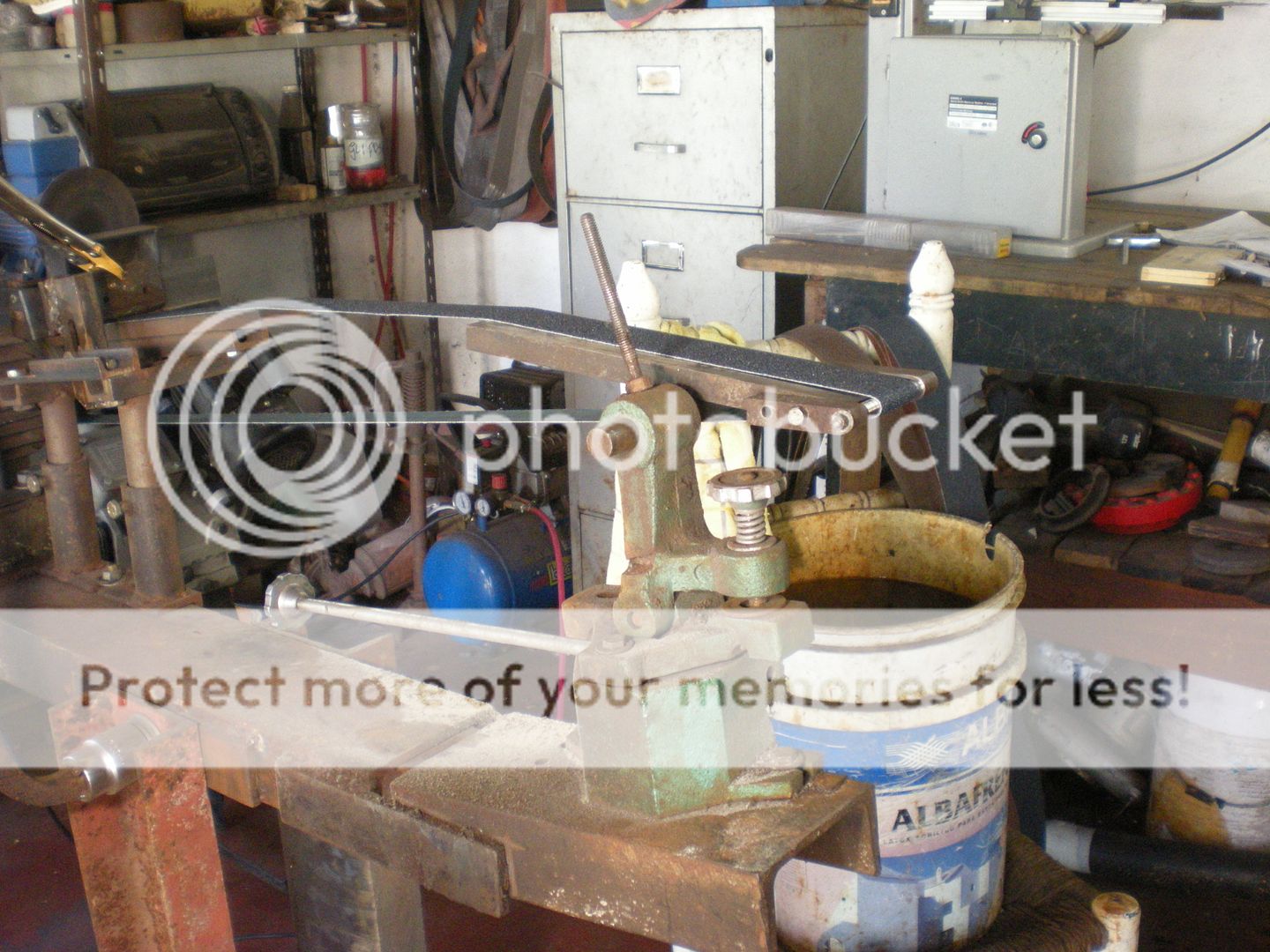

A couple of years ago I made a picture sequence for an integral chef knife that was commissioned.
I rarely see a forging sequence of an integral blade in here so I decided to show it, this is the way I have found works best for me... It might be interesting for some to see.

Very cool I make a lot of these and do things just a bit different there are some parts very close to how I do it and I did learn one new trick from this thank you if I have time I will do a short WIP on my way of getting to the same place. I love your side mount post vice
Thanks David.
I would love to see you working method too!

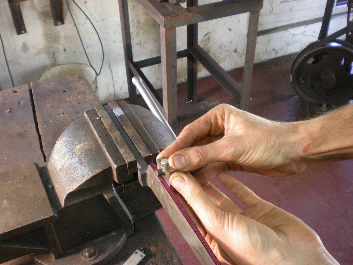

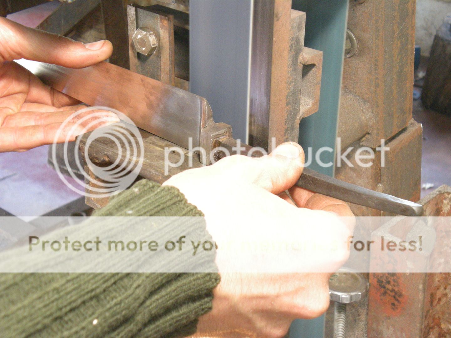

So Manuel, you do a standard plunge first to get the grind where you want it, and then clean up the bolster afterward?

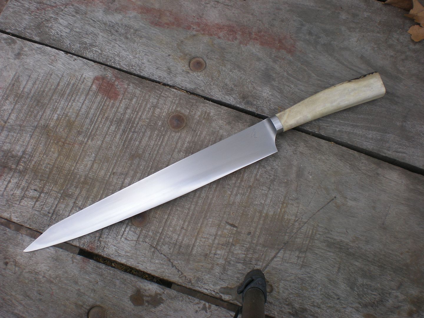

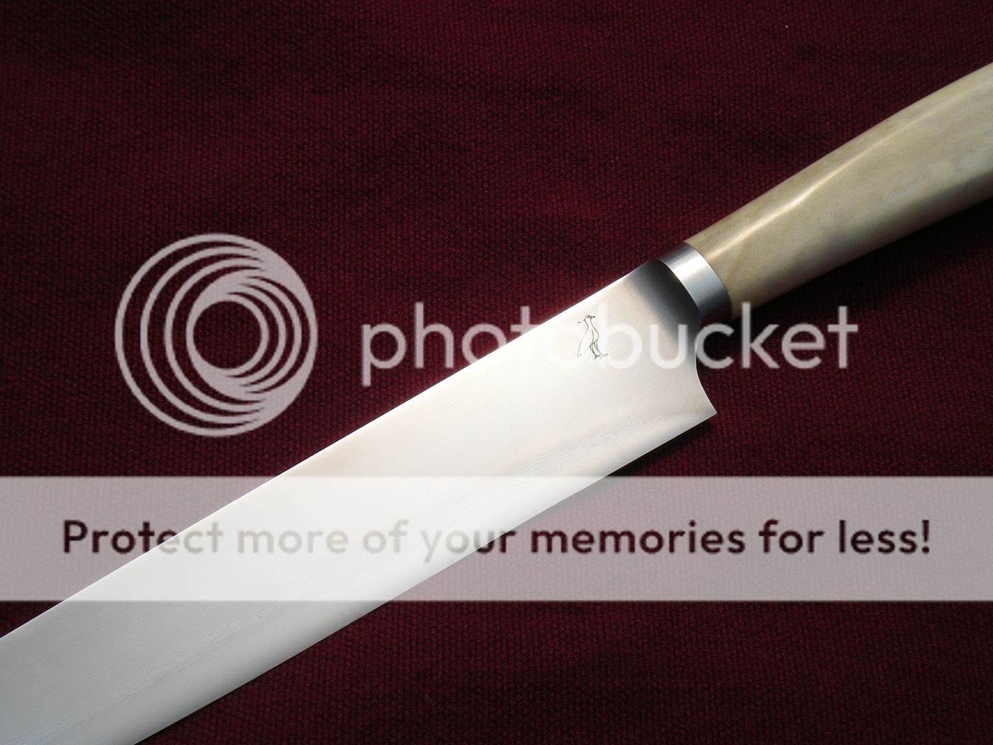

That came out insanely clean! Thanks for sharing.
Exactly, with a fresh coarse belt you can clean that bolster in just a couple of passes.
Wow, that turned out clean!
The customer should be tickled pink with how that turned out.
