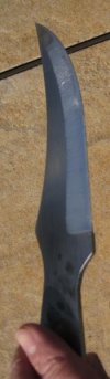

Well I finished two of the knives I was working on here are the pics I think they came out good. Thanks for the help heat treating Matt V & the guys up Baltimore Knife and Sword for putting on the hammer-in a few weeks ago.
Well been a while since I posted so here is another knike I made with this set up. I like the way it came out. I broke it in on two does so far this year allready. The knife sheath ins't my work. Steve at bedo's leather in northren VA made it for me. Nice guy worked with me for the design, and even used the frog skin I provided to make the project. IMG_3207.jpg
I bought the damascus steel pre-made from Texas knife makers as flat stock. Shaped it myself and heat treated it with the others above, even put hidden pins inside the scales. Just got around to posting it.
