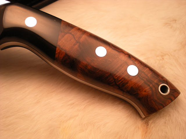

This is another new design for me, but I like the way this no came out...
overall length: 9"
blade length: 4 1/4" of 5/32" CPM 154 heat and cryo treated to 59-61 rc ( by peters heat treat )
It has paper micarta bolsters and iron wood burl scales ( courtesy of tracy mickley) blade has a fine satin finish. All of your comments are welcome and valued!!!
Thanks Jason
That looks great. The micarta and wood go very nicely together. If I was ordering this knife from I'd ask for tiny bit more of guard and no choil...but that's just my preference. I kept looking at the pins for some reason....I'm not sure why.
What steel? Could we get a spine pic?
I also find myself staring at the pins. I don't think it's a bad thing, though. Everything goes together well.
Very nice looking knife.
I'd probably ask for a little bit more handle but I've got larger hands than most. Can't really tell without feeling it in hand.
that is one of the nicest bolster to handle combinations, and indeed transitions i have ever seen.
the handle shapes really nice too, i just wonder about the neccessity for and placement of the middle pin?
