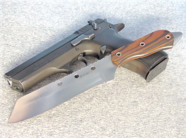

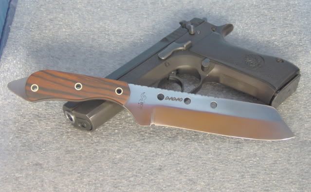

Ironwood Dadao
Apr 18, 2007
327
5.75" cutting edge, 11" overall
A-2 tool steel @57-59rc; H.T. and cryo temper by Paul Bos
Heavy recurve blade, flat ground and razor sharp
Desert Ironwood scales and black spacers
Balance point is just in front of the scales
Exposed pommel tip
Thanks for looking!
That really appeals to me. Nice.
I would prefer some sort of G10 or micarta handle scales though.

That's my Desert Eagle Jericho 9mm- my everyday carry piece.
Thanks for the comments!

Thanks! Black G-10 is actually my standard handle for this piece- thought I'd try something a little different with this one for a change.
