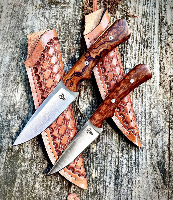

I am sure all the experienced bladesmiths will have a simple answer for me so I thought I would post to gain some feedback. I absolutely love the look of a finished ironwood handle. I have completed a chopper and a slipjoint with ironwood so far.
I had a group of 20 kids over a couple weeks ago for a junior deer camp and as part of that gave them all a knife to put a handle of their choice on and take home. As part of that I had three select Ironwood as their handle of choice.
It was an absolute bear to sand and cut. I burnt up a bandsaw blade and ruined multiple 36 grain and 80 grain belts trying to shape it for them.
Does anyone have any advice on the best way to work with Ironwood and not tear up everything you own? Any assistance would be greatly appreciated.
Here are a couple of pictures of the knives I was successful completing.

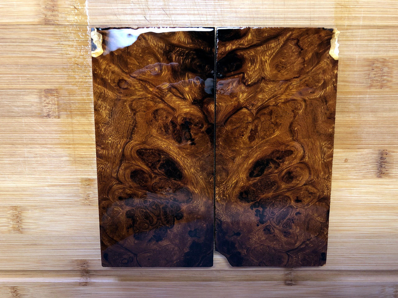

Some desert ironwood scales I purchased from AZ Ironwood for a project I hoped to complete before an unfortunate turn in my health.
