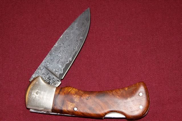

Thanks all for the recommendations. I took the Desert Ironwood up to 1500 grit and it came out nicely. Satin-ish finish while still allowing the colors within the wood to really come through. So, at the risk of being skewered for my noobish attempts at knife building, here are a couple of pictures. First time doing filework as well, and any constructive criticism is of course welcome. This knife went to my girlfriend for Christmas.
