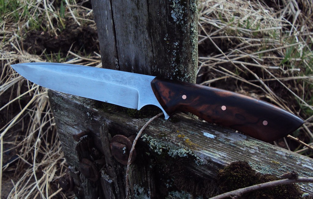

Has anyone done copper pins with an ironwood handle before? I'm thinking about that combination for my next knife but I haven't been able to find any pics online (only brass and stainless) to see what it might look like.
Please post some pics if you have 'em!
I say try it. I love copper! What type of knife? Any guard/blosters/liners/etc where you can add copper also?
Thanks guys. I also 'think' that it will look nice, but I'd kinda like to see some pics beforehand if possible. I've laid the copper rod on top of the ironwood block, but it doesn't tell me much.
It will just be a 4" full tang with ironwood scales...no bolsters, liners, etc. The copper wire I have is ~1/16", and there will be 6 pins spaced around the perimeter of the handle.

Here you go. One I finished a little while ago. I know it isn't the style you are talking about, but it is ironwood and copper. The copper had a forced patina, but hopefully it gives you an idea of the combo.
-Mike

Awesome, thanks for the pics and advice guys! I had seen Mike's blade when doing a search, but couldn't seem to find any with copper pins. It does look nice, but Bill points out the other half of the equation which is how does it look once it gets a patina? The copper I have that's got a patina on it is kind of a subdued medium brownish color, which will probably blend in with a lot of ironwood.
