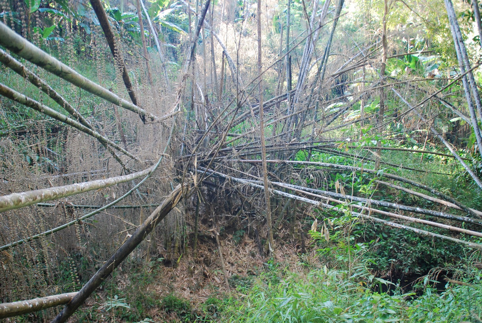

Bamboo is one of the most dangerous plants to rid off; many a times the high tension bamboos inter-twined in a messy bunch and the moment you mis-chopped one, as if you just released the one that hold them together, rains of needle-like shreds came flying.Worst,the clumps will probably snap you from opposite direction.
