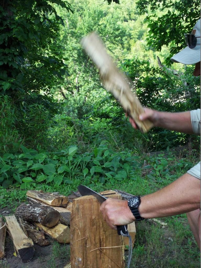

i'm all for using knives hard but there's a smarter way of going about it too even if the knife is built like a tank. like in this case i didn't even have to carve a wedge, i just grabbed one of the smaller pieces i've already split and use that as a wedge.
pulled out the knife and i completed the split with the wedge.
like with chain saws and other lumber jacking skills, wedges of all kinds used properly, are a great thing.
if nothing else, the wedge opens up the wood a bit more, removing pressure/friction, so the knife can go down more easily.
how many times when splitting or batoning, are you fighting pressure more than the knife is attempting to simple resist because of relatively poor profile?
